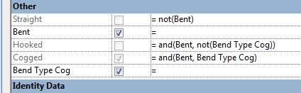

Had the same problem with ends of hold down bolts.  I used yes/No Parameter in logic statments.  See Screen shot.
Thanks for the ideas.
