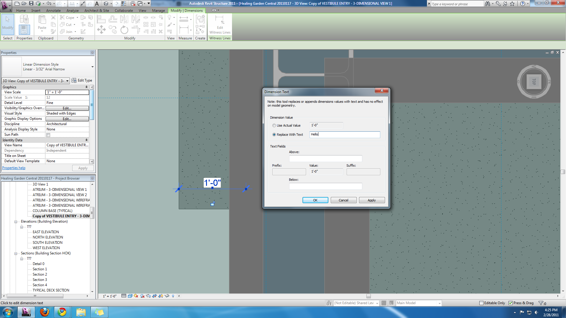

Why wouldnt you just double click on the dimension given, and use the replace with text area?

Correct me if im wrong, but can't you double click on the dimension text itself and then select the option "replace with text" ? youll get this menu....

Here is a work around (wow, imagine that) for overriding the actual dimension in Revit.  As for the user who said everything should be drawn correctly to begin with, you can't be serious.  The original posters comment about break lines in details is an excellent example of why you would want to do this.  I am sure you have overridden dimensions plenty of times in AutoCAD yourself.  You know there are actually good reasons for doing this, so don't be so arrogant.  The work around is as follows
  • Click on "Replace Text With"
  • Right click in the replace text box
  • Go to "Insert Unicode Control Character"
  • Choose "LRM" from the list
  • Type in your new dimension
  • Abracadabra, you are done
  • Click "OK"
You're welcome, France!
