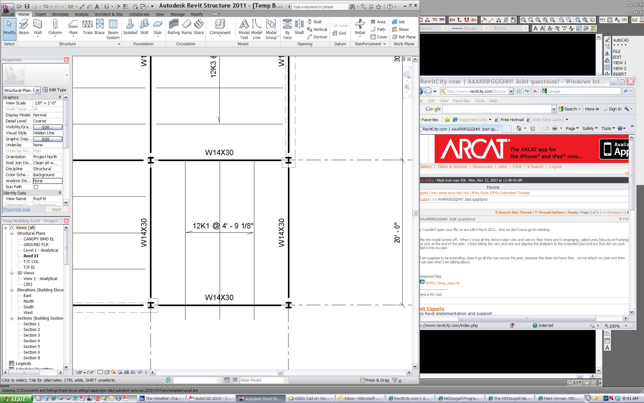

BigD - sorry I couldn't open your file we are still in Revit 2011.  And we don't have go-to-meeting.
I did have the thin mode turned off.  When I cross all the items in plan view and use my filter there are 6 remainging, called Lines (Structural Framing) and they are only at the end of the joist.  I tried taking the very end one and aligning the endpoint to the extended joist end but that did not work when I loaded it into my plan.
Is this line I am suppose to be extending, does it go all the way across the joist, because this does not have that.  Let me attach my joist and then maybe you can see what I am talking about.

OK, we're gonna get this fixed.  Smile
Problem is that you're symbolic line is missing completely.  So, let's just create a new one.  Piece-a-cake, but several steps.  I would recommend that you read thru these steps first and then go back and follow them.  Just a suggestion.
  1. Go to OBJECT STYLES, and change the PROJECTION line weight for Structural Framing to 6.  (Don't worry about CUT line weight). (And, 6 is a personal preference.  You can make it fatter or thinner as you like.  This is the line weight your going to see in your plan views)
  2. In Plan View, from the Annotate Tab in the ribbon, select Symbolic Line and make sure that Sub-Category (in the ribbon) is set to Structural Framing [projection].
  3. Now, draw a line anywhere off to the side of the joist, but parallel to the joist, and draw it roughly the same length.  Don't worry about exactly where you draw it as we're going to use the ALIGN command to put exactly in the right spot and lock it.
  4. After you get the Line drawn, you'll probably notice that it's light gray and thin.  Select the line, and from the Properties Pallet, Edit the Visibility Graphics Overrides.  Uncheck every box except Course.  Now you should have a fat, black line.
  5. Now, using the ALIGN command, ALIGN & LOCK each of the END POINTS of your new line to the Reference Planes at either end of your Joist Geometry (I see that you already have your extensions set to 2'-0" so those Reference Planes out at the very end of your Joist Geometry are the ones that control Extensions and the ones you want to align to.)
  6. Now, ALIGN & LOCK your new line to the Reference Plane that represents the Centerline of the joist.
  7. Save, and you're done!

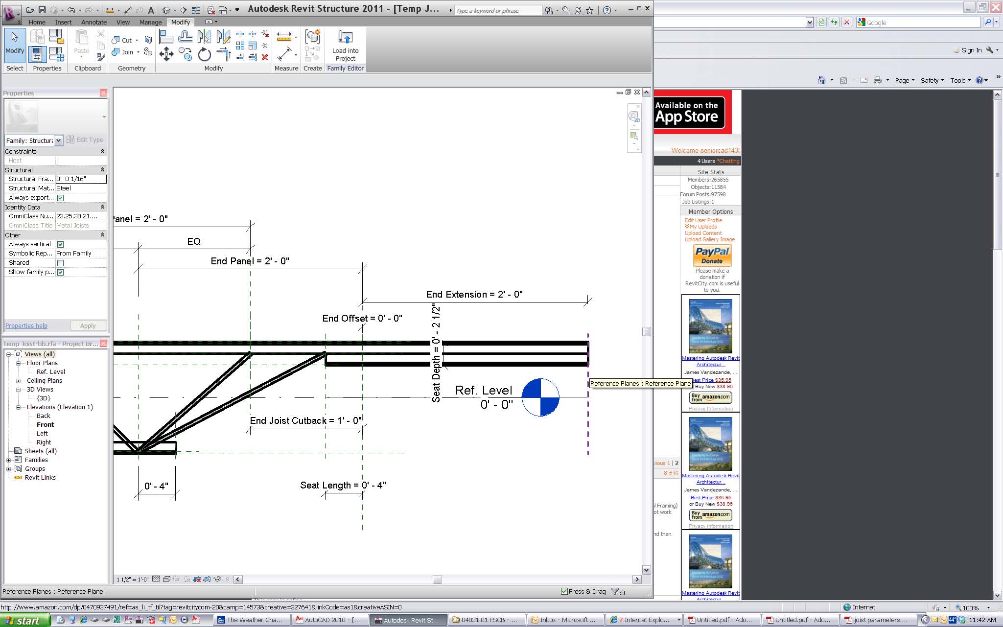

RutRo - I just saw something - my one end that does not have a overhang, the joist does not have a gap to the bearing beam like the other joists does.  I know how this happened - by extending that symbolic line all the way over - but how do I tell it if there is no overhang to stop short of the bearing point?

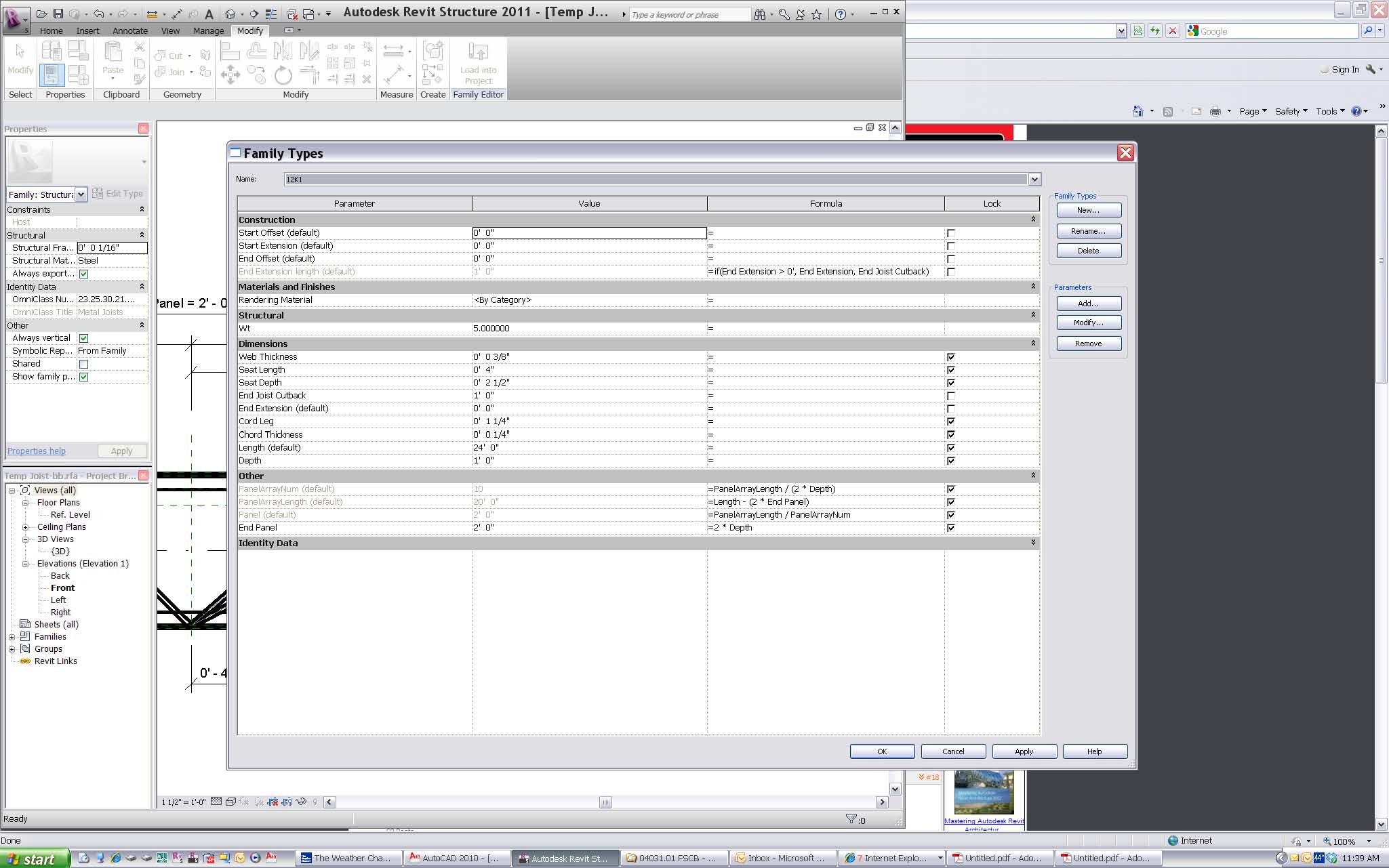

OK i have tried - in the value ...
=if(End Extension>0",End Extension,-1'-0")
I tries ading a cutback dim and that value as 1'-0" and then in the End Extension formula...
=if(End Extension>0",End Extension,Cutback)
No matter ehat I do it keeps telling me it is circular and it won't let me do it.  I can see how it is circular but as of right now I don't see anyway around it.  I would like to leave the End Extension the way the old one was but I might have to change it.

Well - I got the formula to work in the joist family.
But when inserted into the project it did not show the joist end offset.  I think I know why, because my symbolic lin is not aligned to the joist cutback line.  But how can it be aligned to two different reference planes.  It is already aligned with the end of the joist reference plane.
