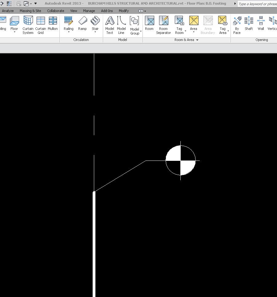

thank you, that works. but i still need to know how to do it for myself.
also how can i get it to scale with the drawing, like the text does. that one is just a bit to large in 1/8". it would be fine in quarter, i'm sure.

Modify that family..... look at the pieces - this is just a circle with filled regions.  Change it!  Make others like it.  Download the families guide.  You can find a pointer to the under the Help pulldown.

CONNECT TO EXISTING MEP DATUM SYMBOL WE USE AT OUT FIRM

I think what you need is to use "keynotes"

sorry that i never posted a solution to this thread. i forgot that i even started it. i now use a blank leader and a simple annotation symbol to do a connect to. i've attached both of them plus a screen shot. i hope this is helpful to someone.
