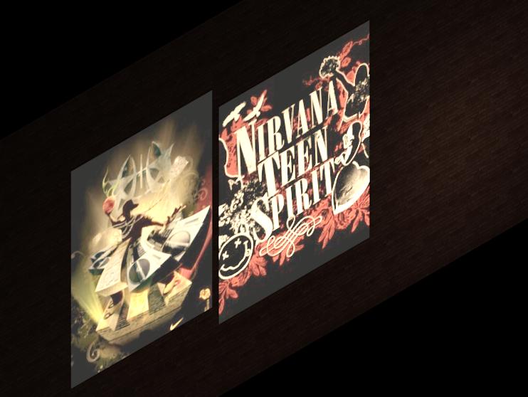

hey bro forget all this fuss..simply when u creating a decal on revit architecture 2009 just check out the setttings. you will see "Luminance(cd/m^2)". it wud be set to not illuminated check out the options in that ..they range from crt monitor screens, led panels, halogen lamp lens just select the desired n hopefully c wat u have been wanting..cheers!! Smile
Mon, Apr 19, 2010 at 8:26:23 PM | Using photos on panels of curtain wall?
#21
Arafat
Arafat Avatar
Joined: Sun, Sep 20, 2009
6 Posts
3.5 Stars: 4 Votes
sorry i just read all ur posts right now ..u mentioned the  decal settigs givin u black n white images that are too bright i guess thats because your settings aint perfect...i too had to do alot of custom setings to get my job done..m attachin an image just see if it is  kinda sumthin u need.. plz note i havent used high quality images

yes that is pretty much exactly the appearance i was going for. mind if i ask what custom settings you used or at least what stuff you changed?
thanks

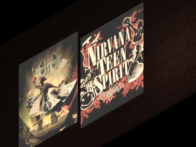

just a bit more playin  with the  decal can work wonders for you .....just increased the intensity of the images in decal to get this new render ..plz compare the previous attachment wid it
  u wud be able to make out  the difference pretty clearly..... i believe you have to have different settings for different decal images....sounds a bit hectic  but thats the way it goes
Mon, Apr 19, 2010 at 9:04:53 PM | Using photos on panels of curtain wall?
#24
Arafat
Arafat Avatar
6 Posts
3.5 Stars: 4 Votes
"Luminance(cd/m^2)" custom setting was set to 5
" intensity "was set to 75...
but as i have mentioned earlier it all depends on the image u choose
