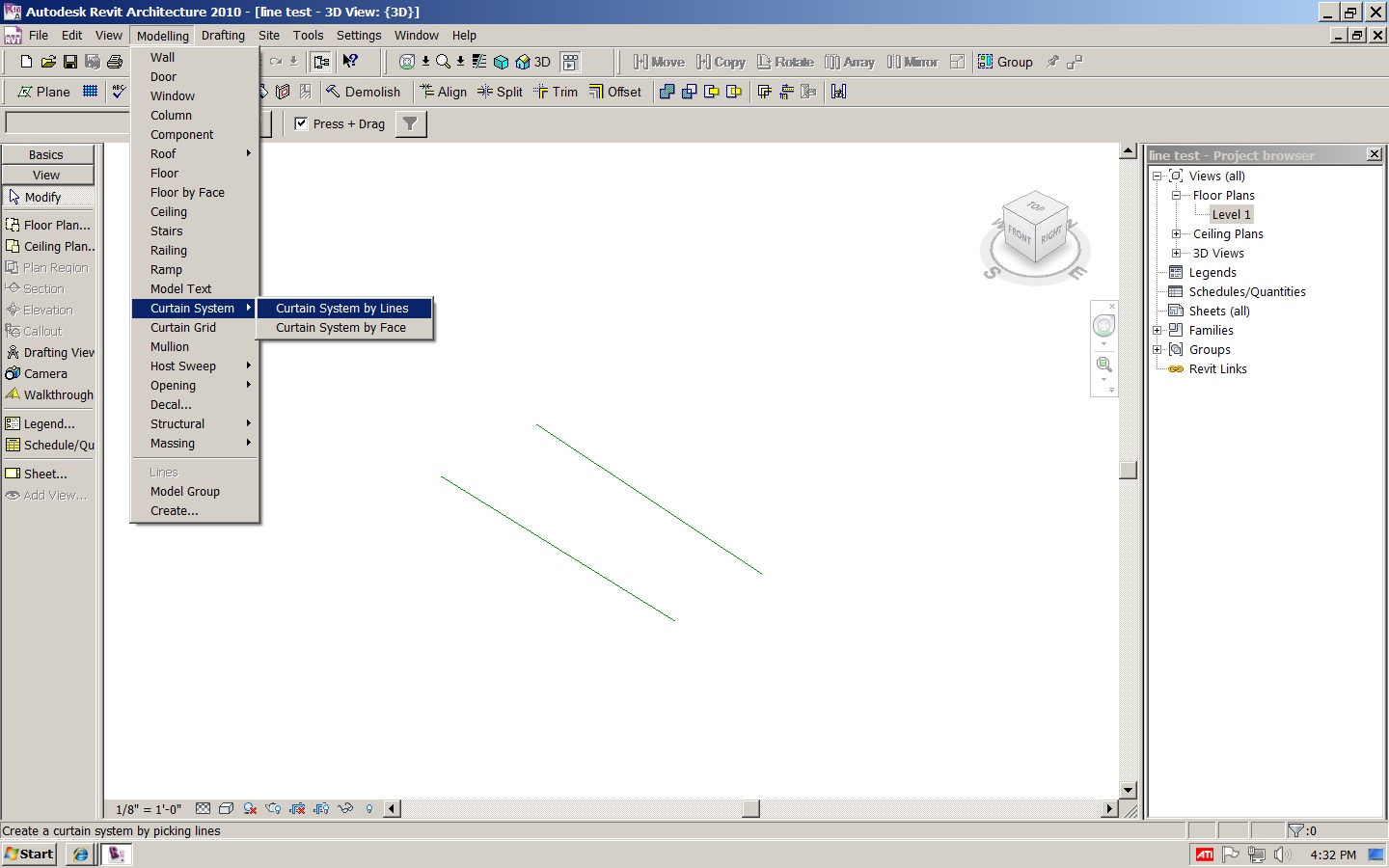

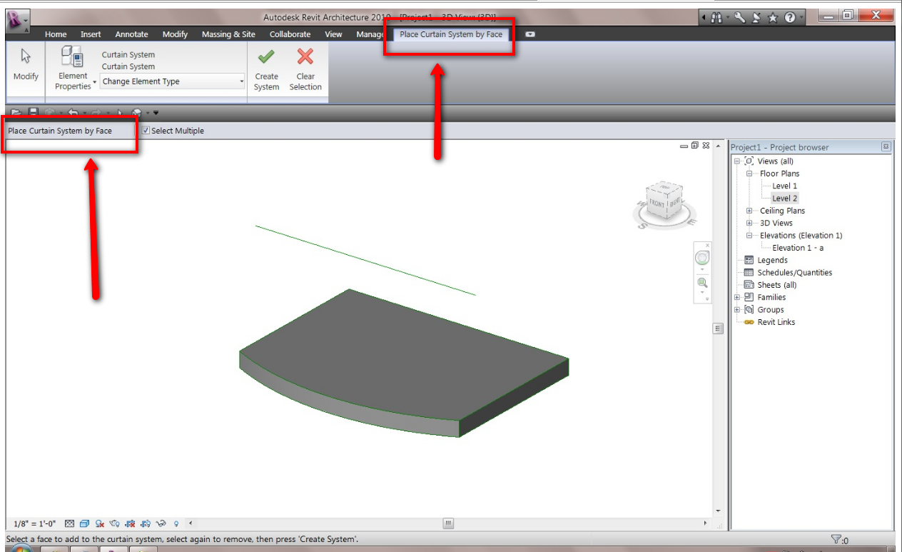

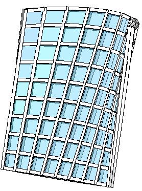

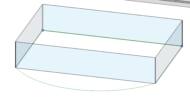

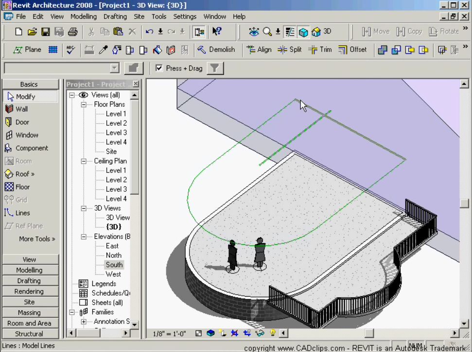

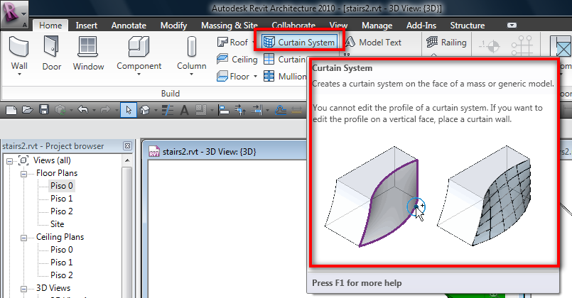

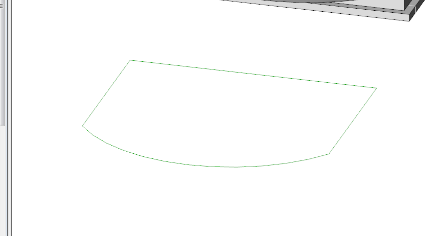

Look at you image (first image)... it says "Place Curtain System by Face", do you know what it is? NO, check the second and the third image i post, you see now... the only way to CREATE CURTAIN SYSTEM BY LINES is like i told you before, check the fourth and fifth image.

The traditional 2009 'Curtain System by Lines' was removed in 2010. It's just not there. However there are new tools that accomplish the exact same thing but even better.
1. Create an In-Place Mass form using linework. (ie: one set of lines on level 1 and one set on level 2. Curved or straight and multi-segmented too!).
2. Use Model by Face > 'Curtain System' to create the new curtain system based on the above 'Form'.
3.  And Curtain Grids and Mullions just like you used to.
The results are even better than the old Curtain System by Lines but just takes one extra step. (step 1)

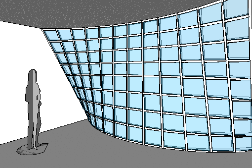

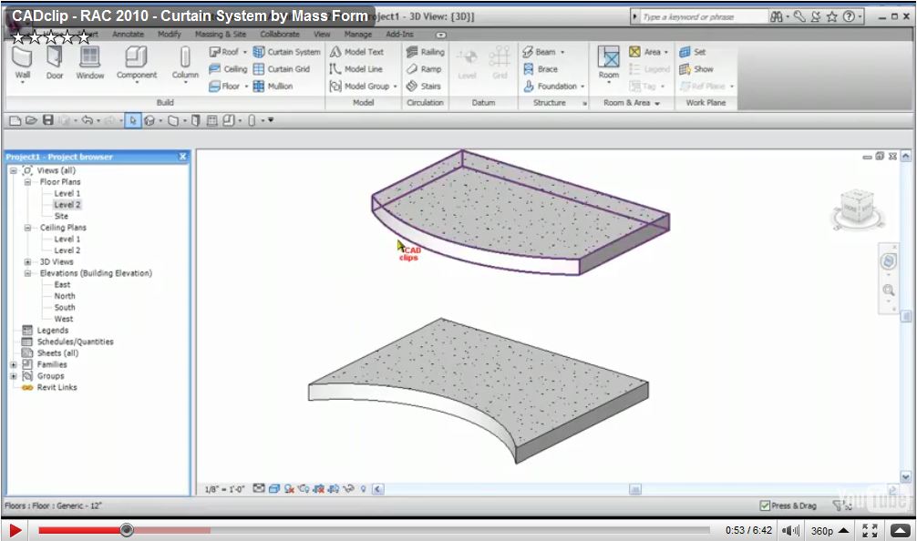

thanks daryl-
i will be studying that new method of substituting
mass for model lines but i really don't understand
it yet.. see the two images of what i'm looking at-
both created by you..

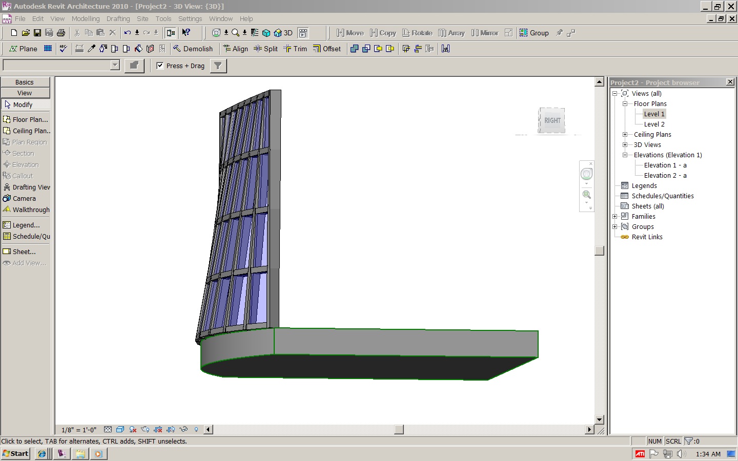

how do i get this whole curtain wall to move back
so the bottom mullion is flush with the edge of the
floor?
i can't get any type or instance properties on it..
and all i did was select the edge of the floor after
selecting the model line on top for the curtain wall
and then i added mullions.. how does it move?
