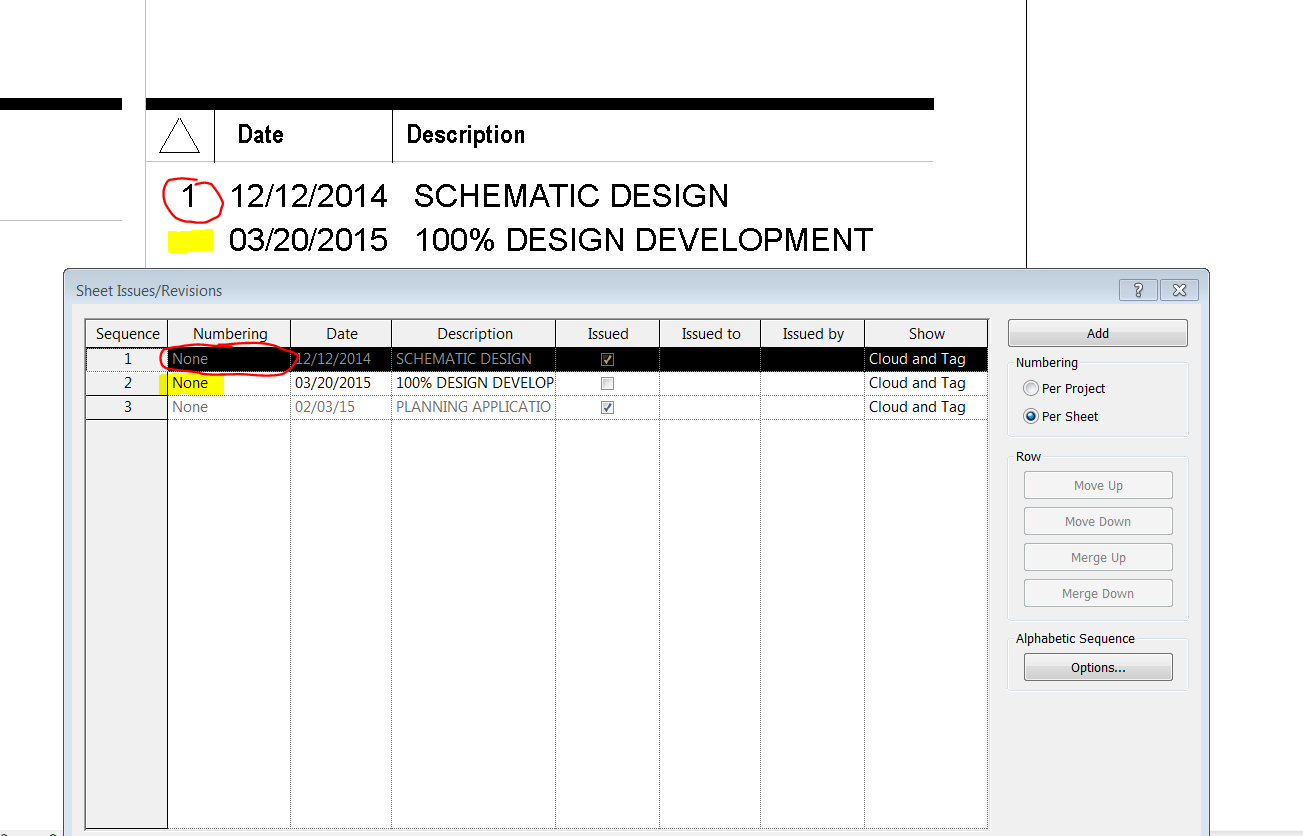

Stupid question: how do you keep from showing any numbers for the issue / revisions. Revit is adding a number that it doesn't seem like should be doing.
Fri, Mar 13, 2015 at 7:26:41 AM | Revision Numbers
#19
crwinchester,
I just tried it in 2014 and had no problems.  I even added the cloud first while it was numbered and then switched it back and that worked too.
Since you didn't say which Revit, I then tested it in 2015 and no problem there.  Perhaps you are not up to date on your updates.
