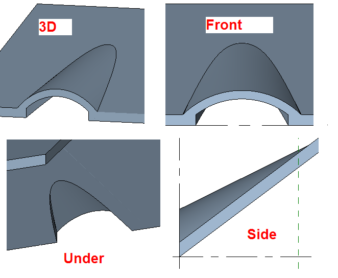

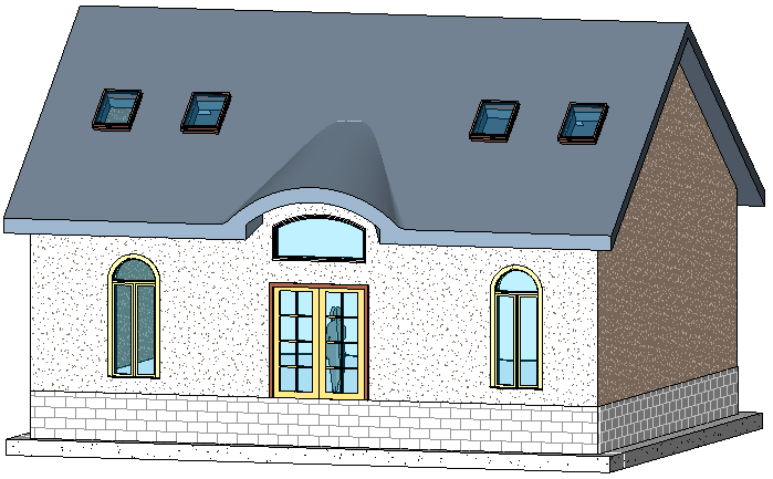

Is this what you are looking for ?

dgcad
That is just what i am trying to do.  So how did you do that?
