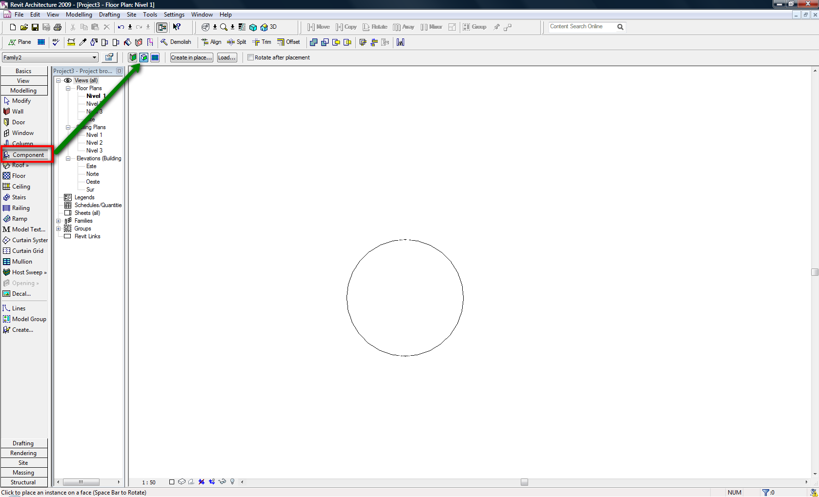

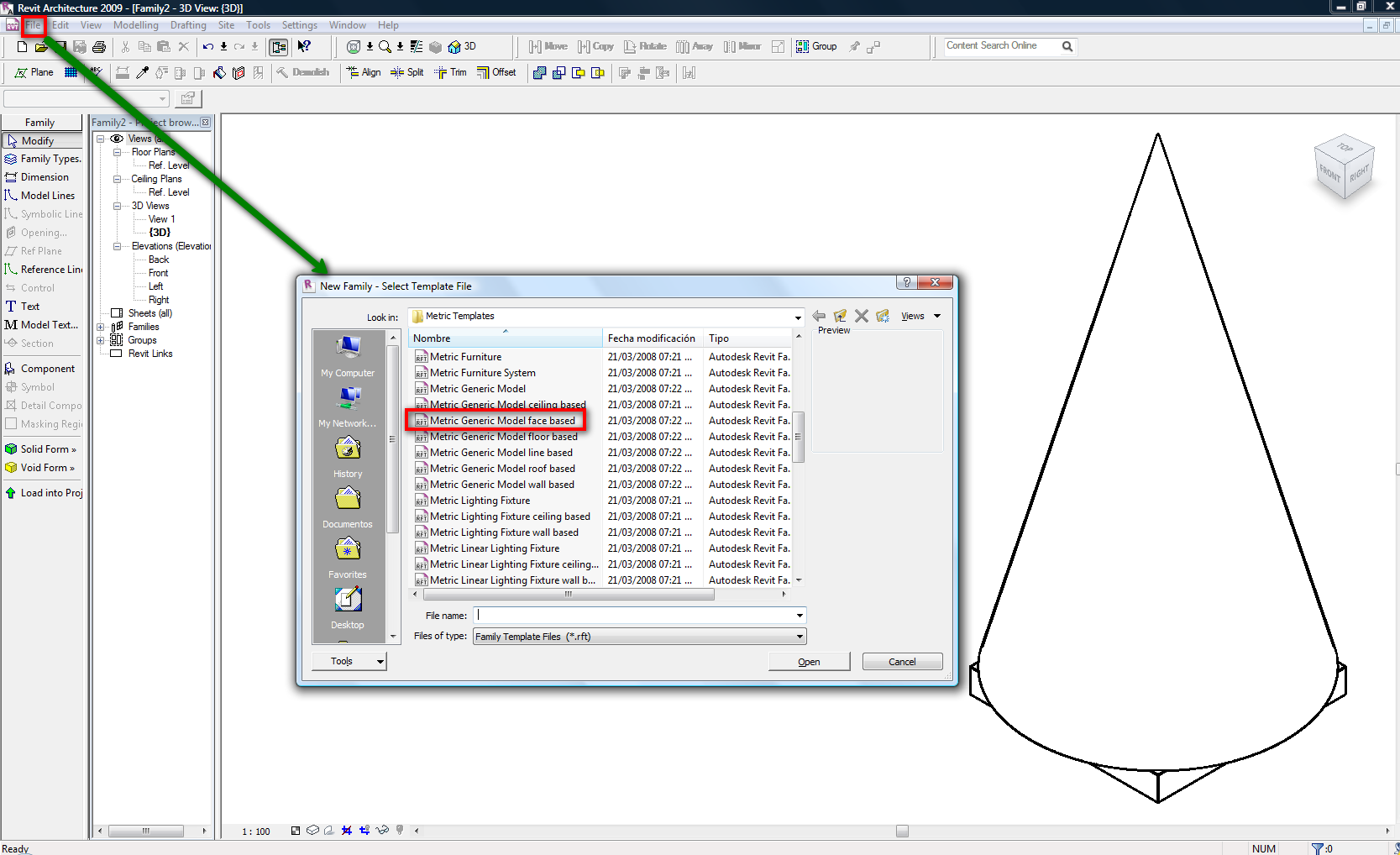

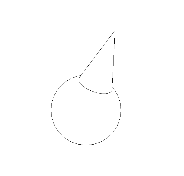

Go to File-->New-->Family...and choose the Generic Model Face Based template....

and then?
how do u make it attached to the ball??

Ok, once you have your family, load it into the project. Click "Component" and in the Option Bar, click "Place on face" and start placing your cones on the sphere....

how do u make the cone join the sphere?

so, Erland..how do i make the cones join the sphere?

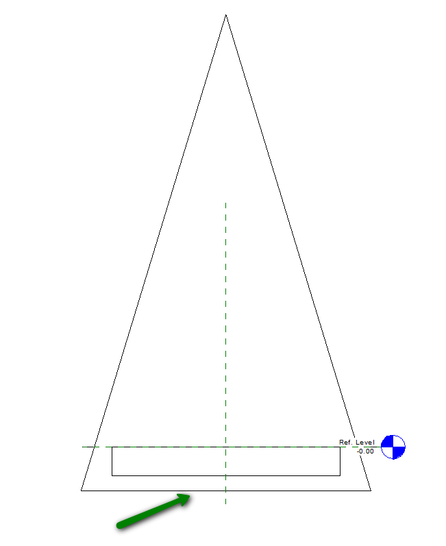

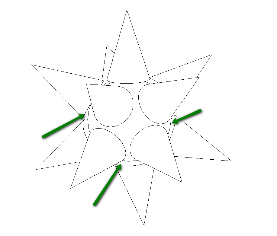

anna, I explained it to you in the thread #20, in additon, to avoid the spaces between the cone and the sphere (see images), move (in your family file) the cone down and load it again into project and then use the join geometry tool....

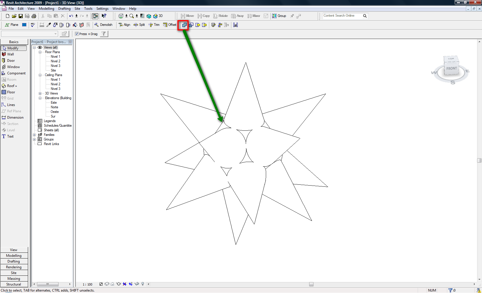

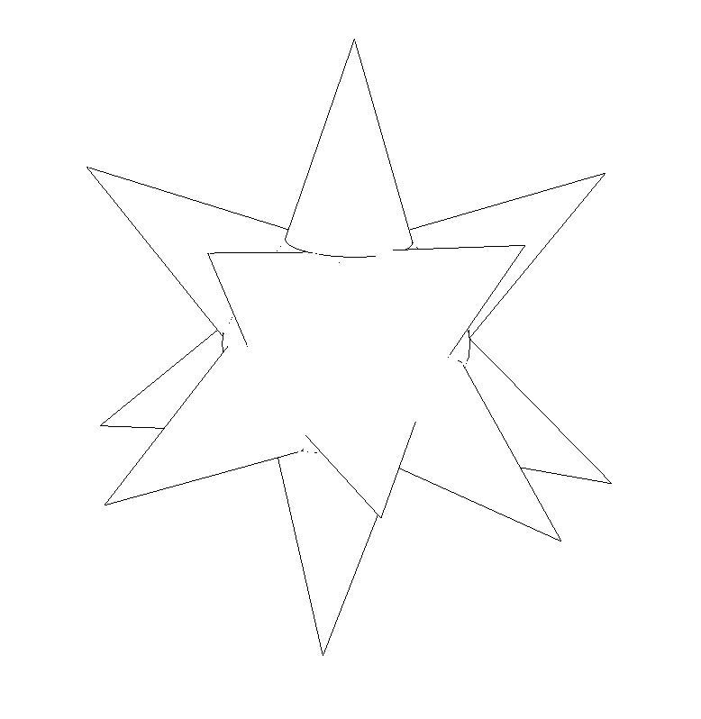

hi erland,
Yes..
I have tried that command..
But,somehow it doesn't seem to work..
please see attached file..

hi erland..
i think i know what's the problem..
i have solved it!!!
thank you!!!
