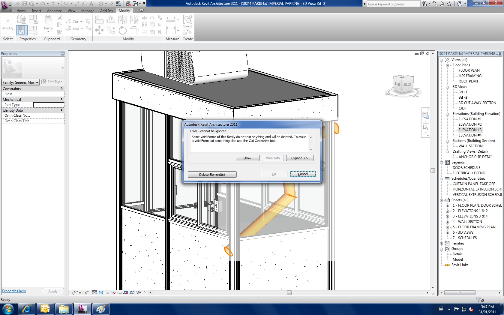

i tried following this just for fun but I don't get how you make a void in an in-place family. How do I assign it to a wall?

Now just use the "Cut geometry" tool , select the Void then select the obj(s). you want to cut.
