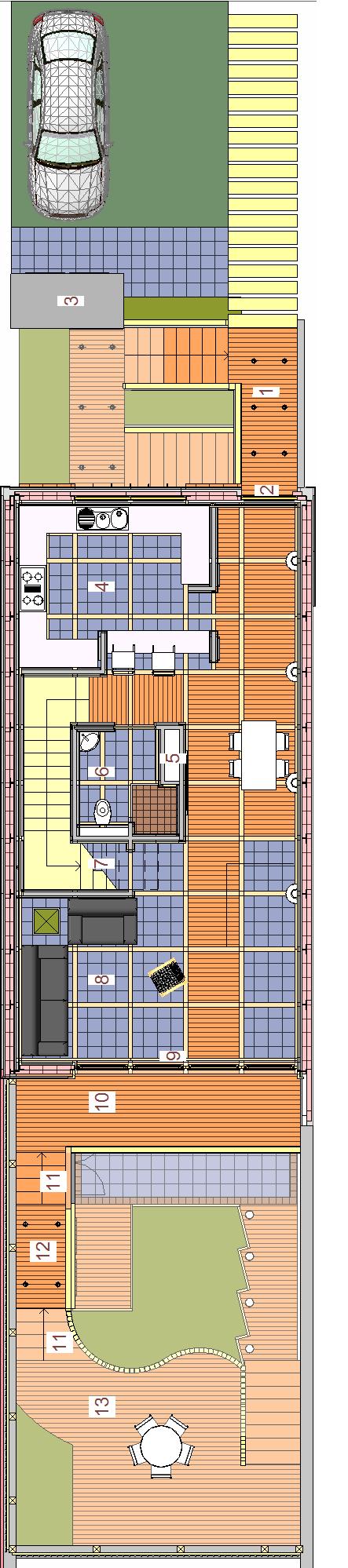

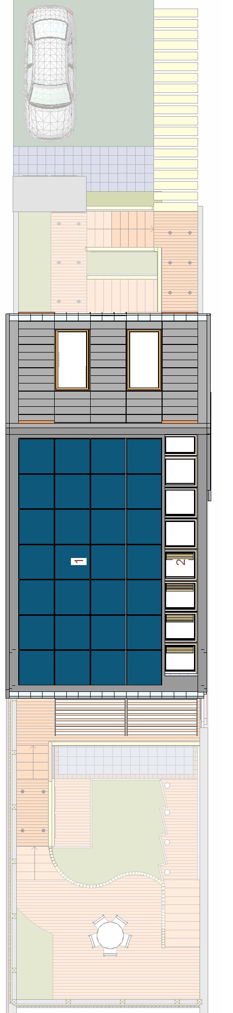

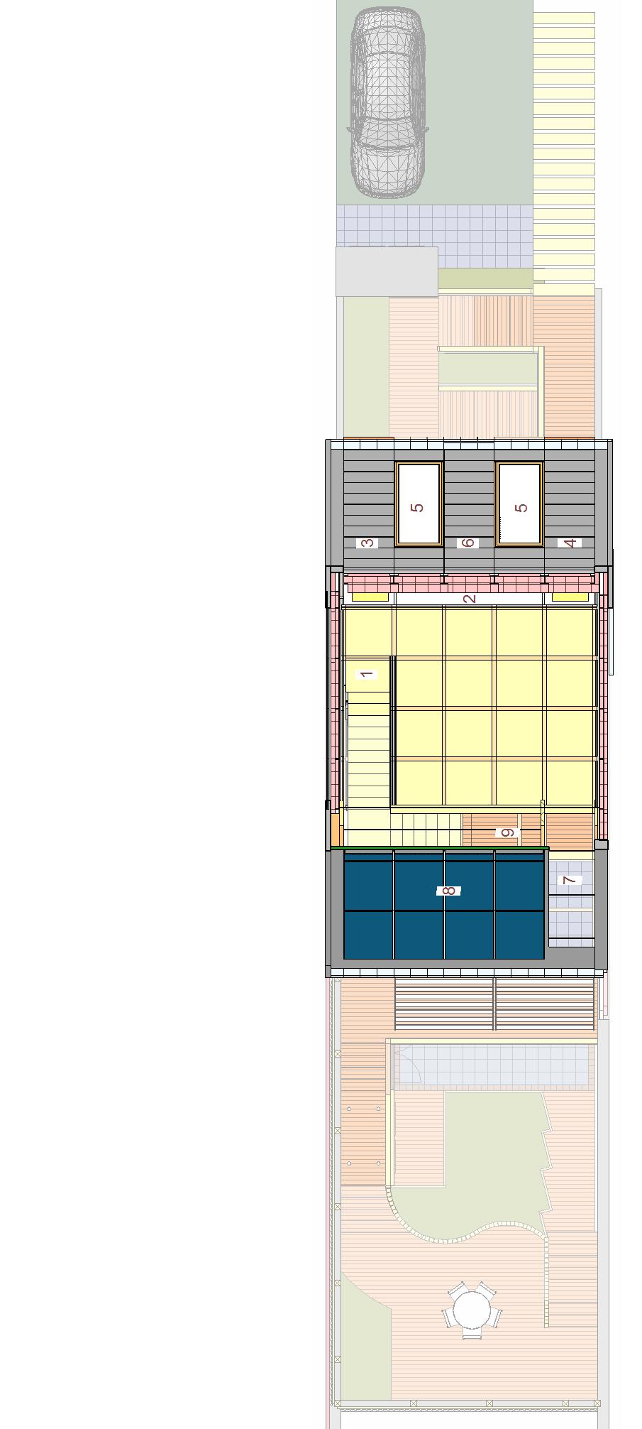

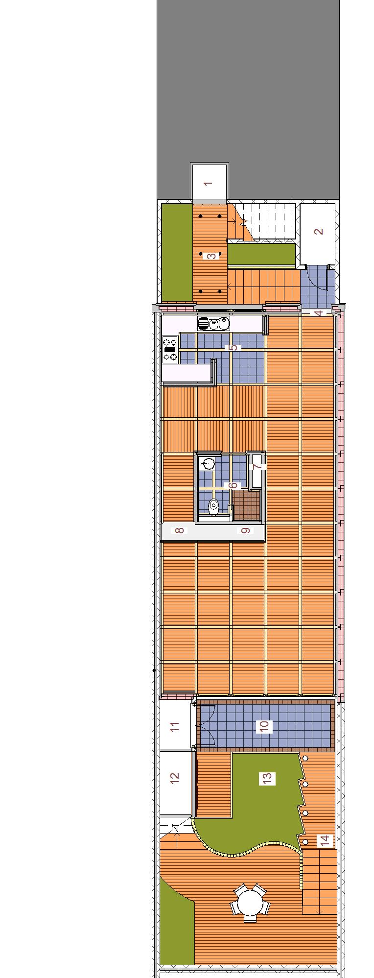

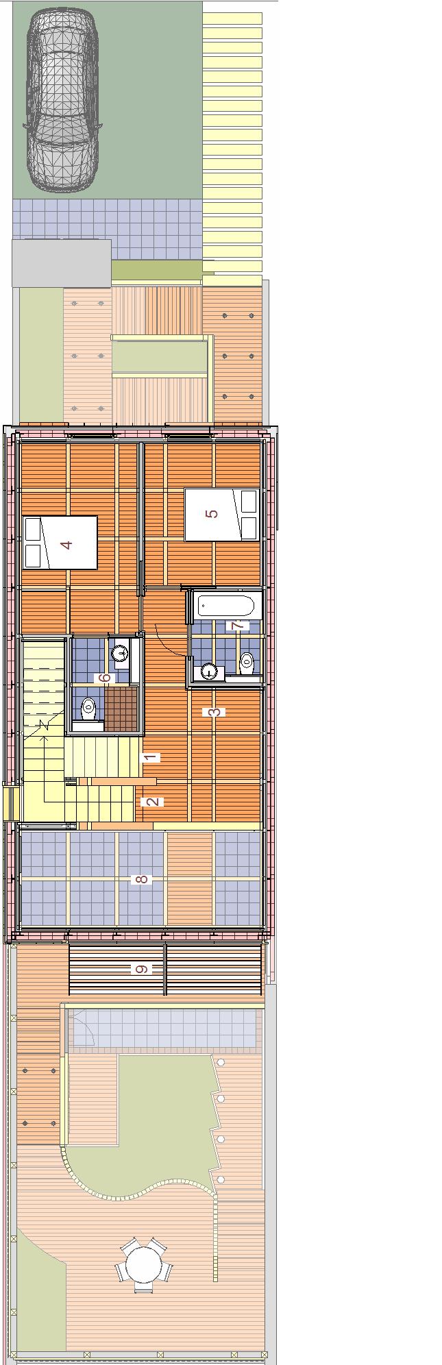

Heres another method for creating multiple fading depths.  I've used it here for plans to show levels below becoming progressively lighter, but the same method can be used for elevations.  I placed sheets of semi-transparent material between each level.
65416_Plan1_-_Basement.jpg65416_Plan2_-_Ground_floor.jpg65416_Plan3_-_First_floor.jpg65416_Plan4_-_Attic.jpg65416_Plan5_-_Roof.jpg
