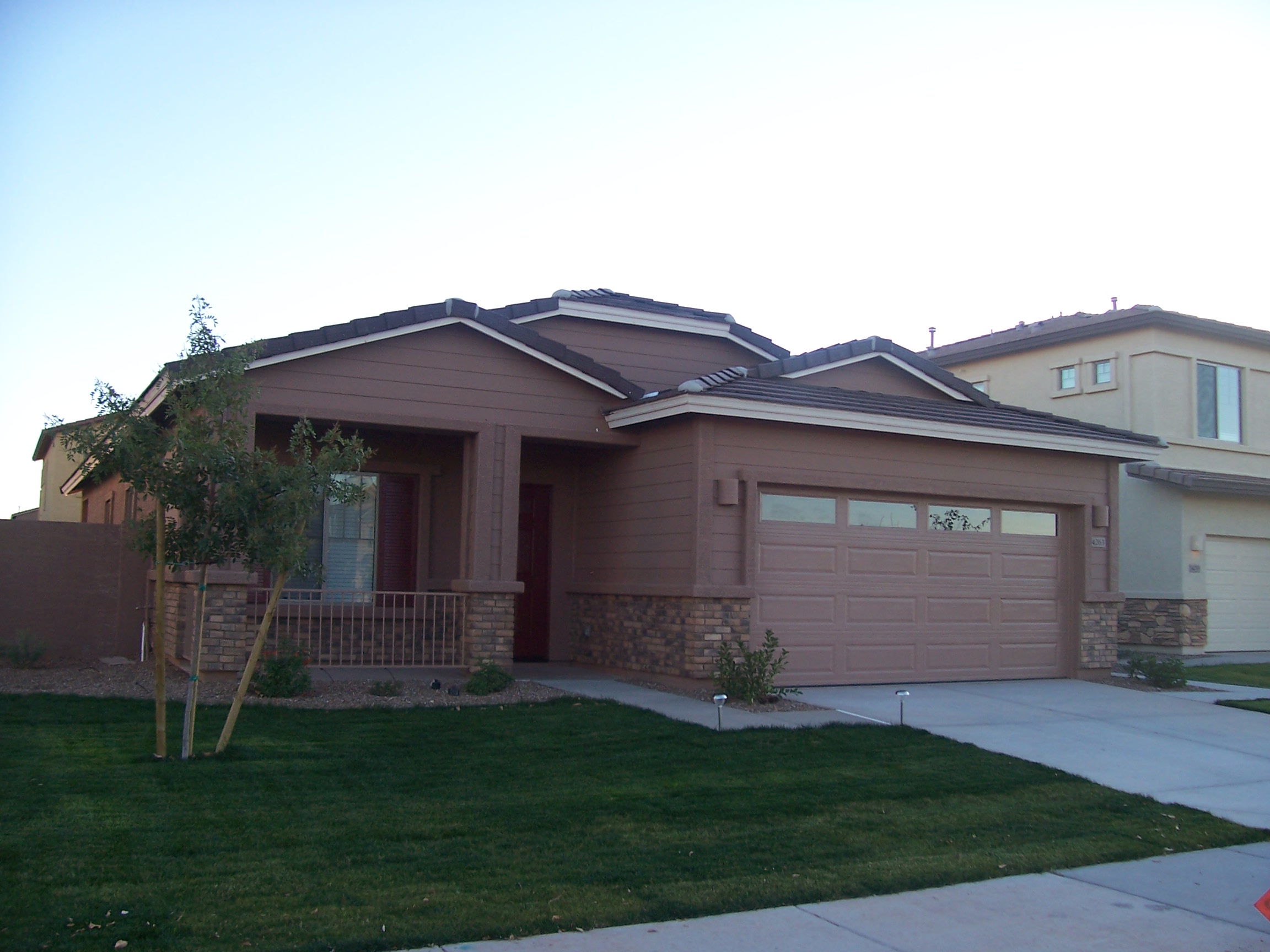

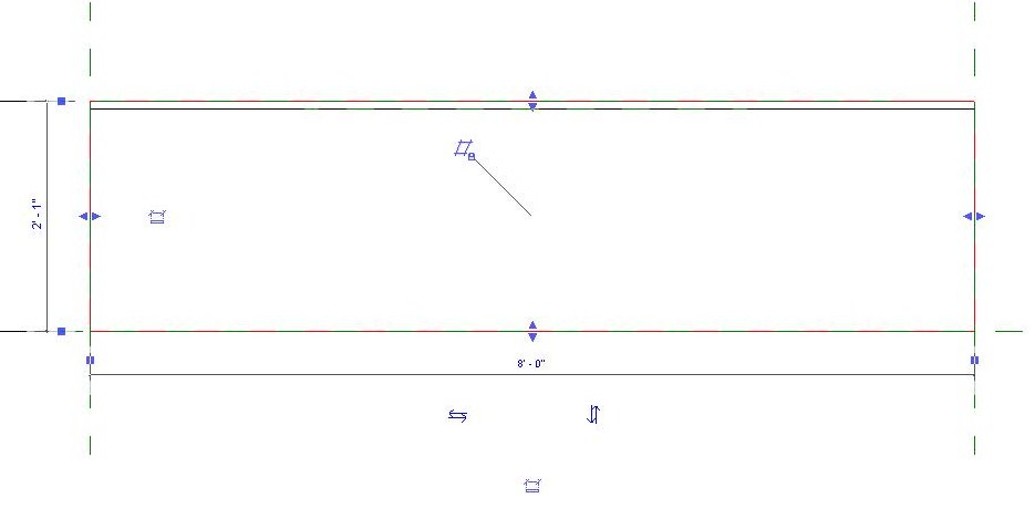

Finally, I posted them...
I need to make 1 more family for this wall projection which runs along the wall. Please look at the attached image. The extanded horizontal wall projection which runs above the stone clading...
How can I make it's lenght variable??? Which I can adjust in project. (i.e. small blue triangle in another image which i can drag and change the length. )
Thanks.

Use the "Wall Sweep" to do that, create a "Profile" family with the shape you want, then go to the properties of the wall>Edit/new and in "Section" you can add a "Sweep", check the HELP menu..... Also, search here in the forum for "Wall sweeps", there are lots of thread about this...
