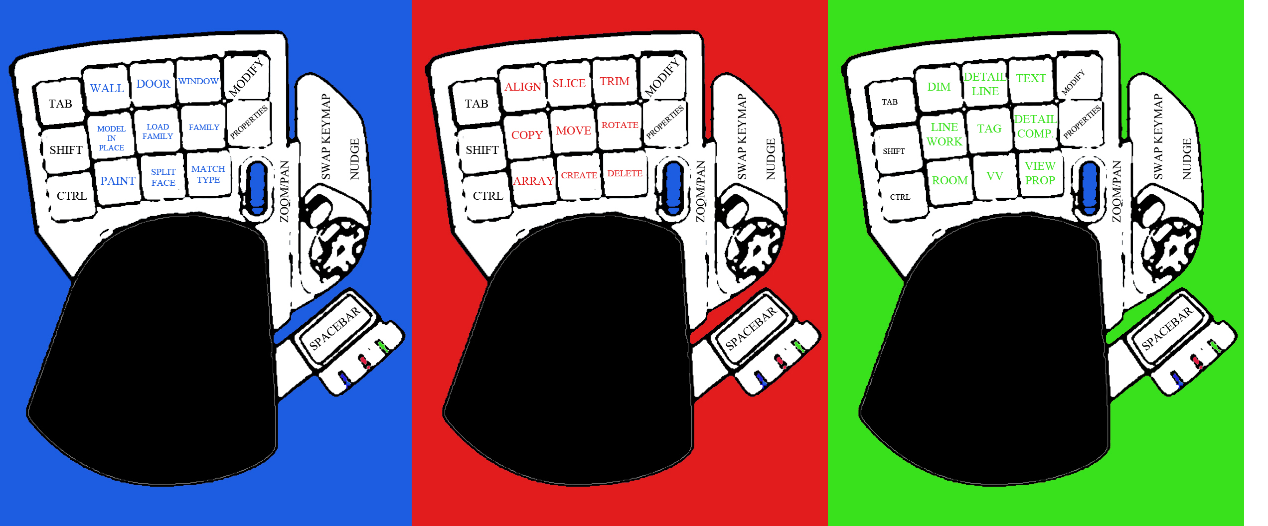

I am testing a Nostromo gaming pad (Belkin n52te) to reduce my time using 2 keystroke commands and working within the ribbon. Here is my macro setup and it is sort of evolving as I find what works and what doesnt. You can see that the commands in color are specific to that Keymap and the black ones are universal.

Don't map something you use a lot to the 'space bar' because repeted use of that one will cause it to stick.

well this is not a two hundered dollar programmable keypad so i like that part..
how many key map swaps can you do? just three?
and how do you know which key map is active?

Yes it is three Keymaps with 15 keys/Scroll/D-Pad and once extra button. On the lower right of the D-Pad are 3 LED lights and whatever Keymap I am in that color LED is lit up. So far the immediate benefit I see is the reduction of repeditive movement. I am going to use it for a few more days and see if I can any speed with it.

alabaster- i'll just let you be the human guinea pig with this thing
and i'll be checking back with you in a week or so.. but it sounds
like you might be on to something good..
i guess you would have to look down and see what keymap light
is lit- but that seems fine.. i like the idea of low cost
top name brand stuff like that.. at least it's a start- and they
do make more expensive pads with more keys..
