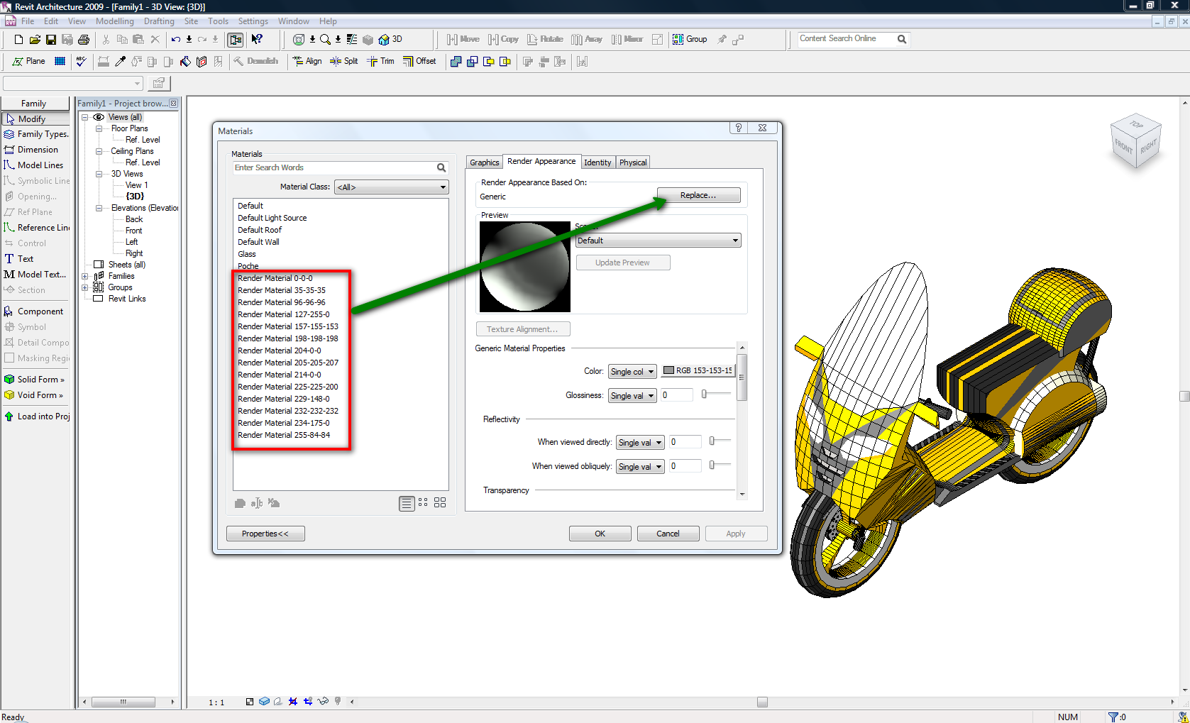

Just go to Settings-->Materials...& change your materials there....

Here an example.....

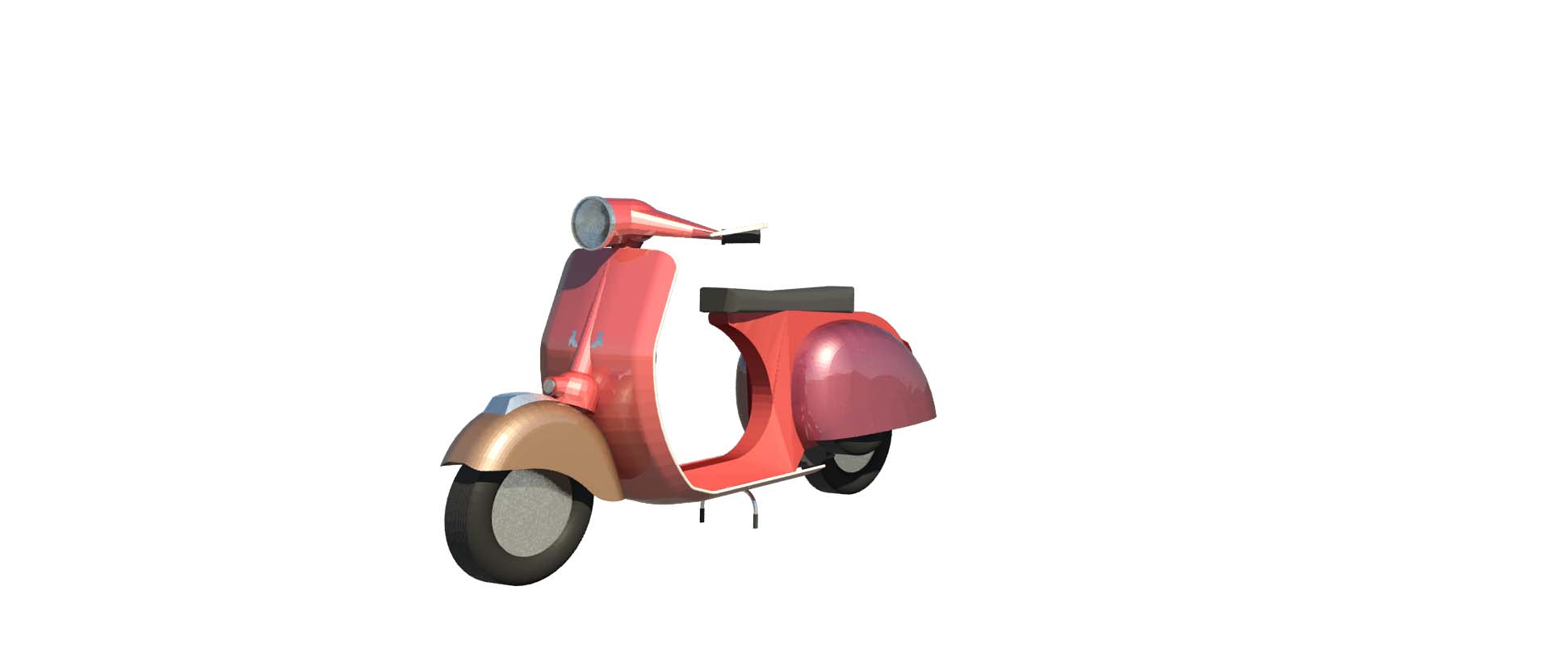

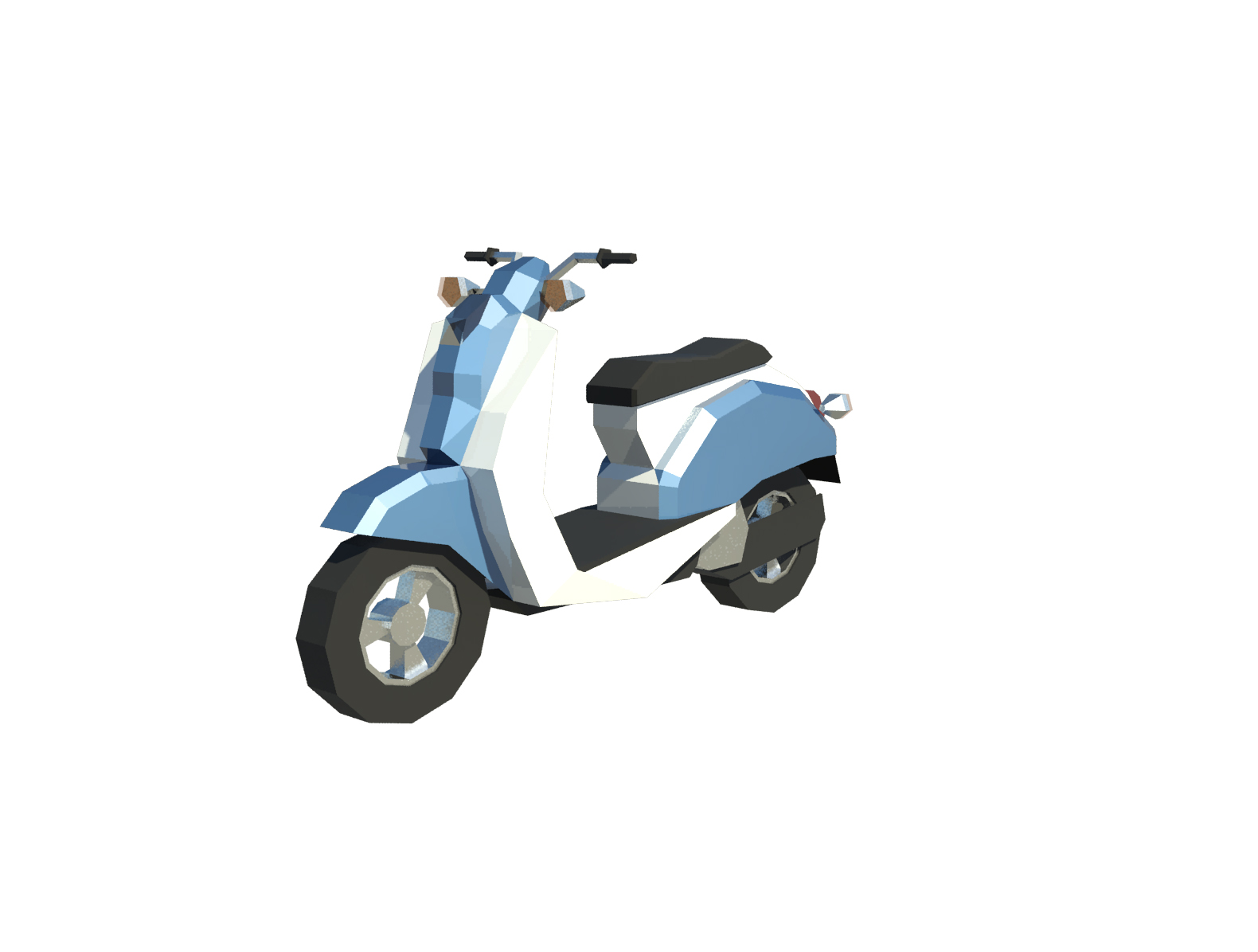

I did that but it didnt work. Ive been trying for the last 3 days... And I need it for my presentation on Wednesday. Do you think you could chang the materials for me for the 3 scooters and attach the revit file?
Thanks so much for your time.

Here your Scooter...

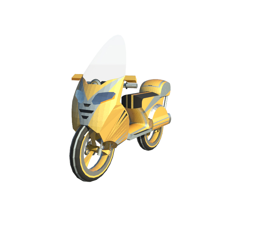

Your Vespa 200.....

Thank you so much!!! I really need to know how to do it though for my Graduation project for next year..

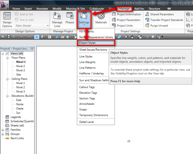

I'm using revit architecture 2010, and I cant figure out how to get to object styles... can anyone help???

Manage-->Settings-->Object Styles.....
