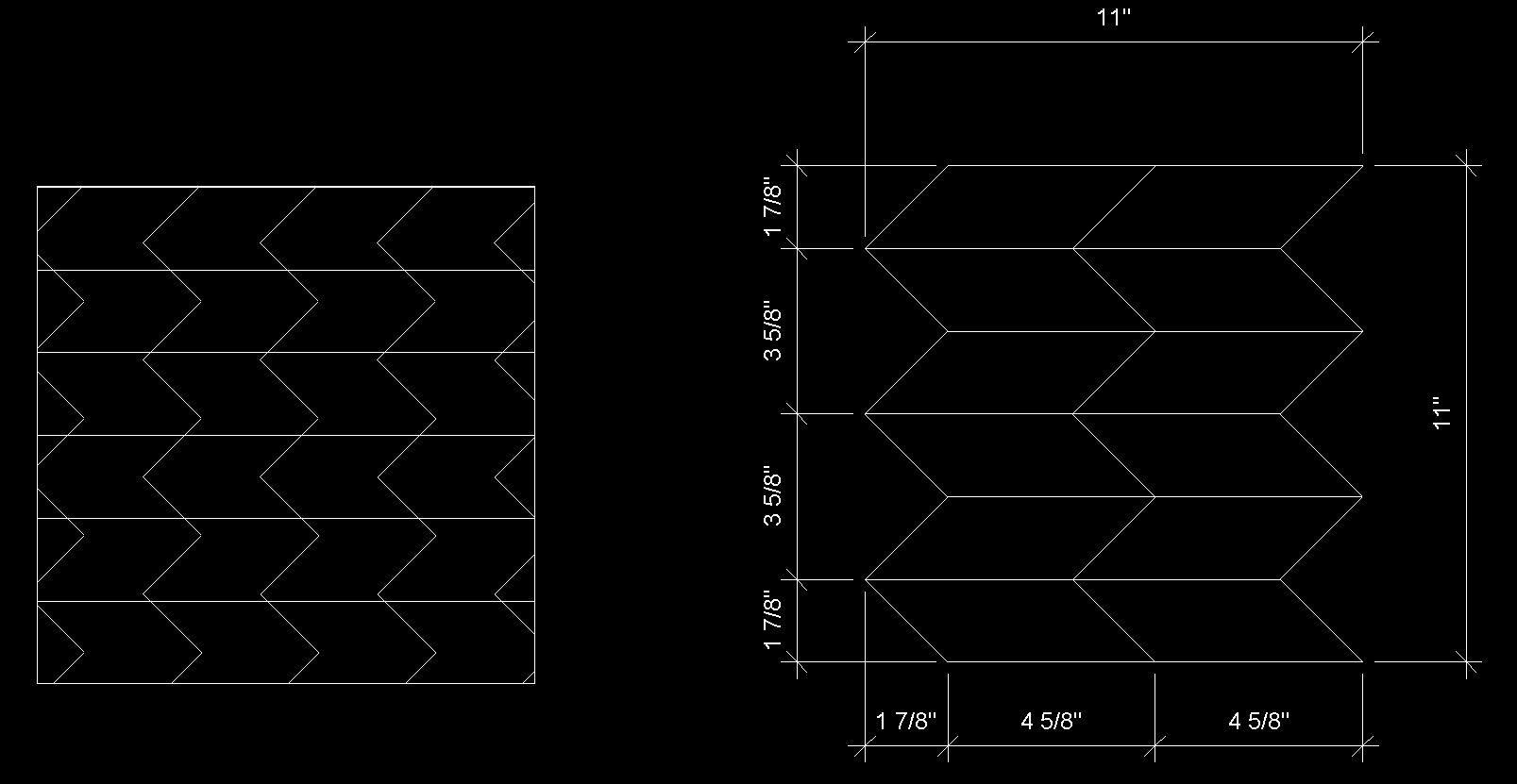

Need help making this pattern for a .pat file.
The pat file attached is what I have been able to get so far. Can't figure out how to space the angles.

Can you post a picture of the pattern look you are going for. it is not clear from the .pat you posted.

Sorry I originally posted it but I didn't notice when I edited the post it took it away.

This is what I have so far and what it needs to look like.  I can't figure out the offset/ shift spacing.

Here is the pattern that works. I made the tiles 2" wide x 8" long as that is alot easier to work with for numbers rathr than the 1.83 you had the lines at in your attempt.
*WT-3
;%TYPE=MODEL
90, 0,0, 0,2
45, 0,0, 5.65685424949238,5.65685424949238, 2.82842712474619,-8.4852813742385
45, 4,0, 5.65685424949238,5.65685424949238, 2.82842712474619,-8.4852813742385
-45, 2,2, 5.65685424949238,5.65685424949238, 2.82842712474619,-8.4852813742385
-45, 6,2, 5.65685424949238,5.65685424949238, 2.82842712474619,-8.4852813742385

I figure it out. Iposted my last response before you had sent the screenshot with the dimensions. It was a lot more complicated because of the distance betreen the lines that actually line up on the angle which dictates the penup pendown distances.
