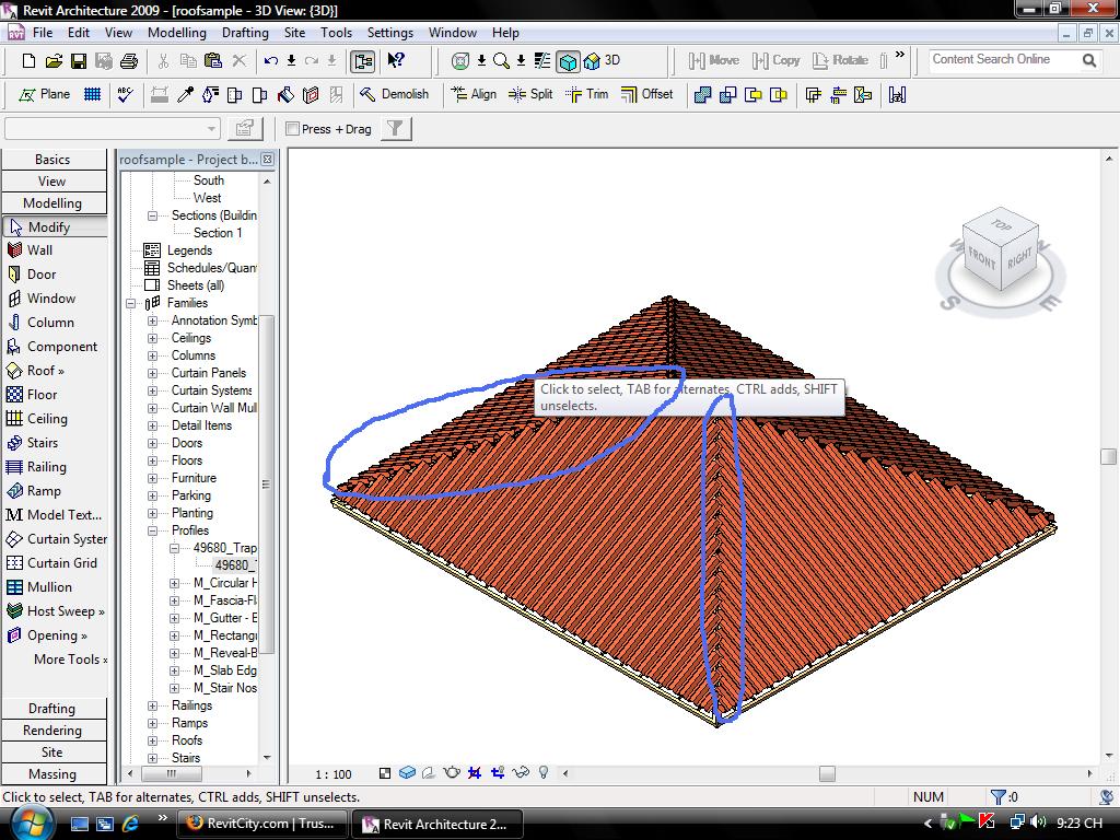

Trandung, dont use the "Cumeeira2.rfa" to create the tiles, vreate the profile you want in 2D and load to project, then use them like Tiles in the mullion, ok? I attach "Trap2"

Thanks Typhoon so much . I success the metal roof , but have lack coner .
Have you tile file family same trap2 .rfa . I do not understand cumeria2.rfa what is it ? .

Hi, See how you can use "Cumeira2", to create something like this, create a New family profile 2D, then save and load to the project, go to Moddeling-Host Sweep-Roof Fascia, see the video....

I used trap2 and creat a new profile . I have a question : telho.rfa , when creat on roof very difficult  for right plane ???

Hi trand, see this: http://www.megaupload.com/pt/?d=RDSETBFM

I understand . I must creat a new sloped glazing for telho ! . Thanks you , you are wonderful
