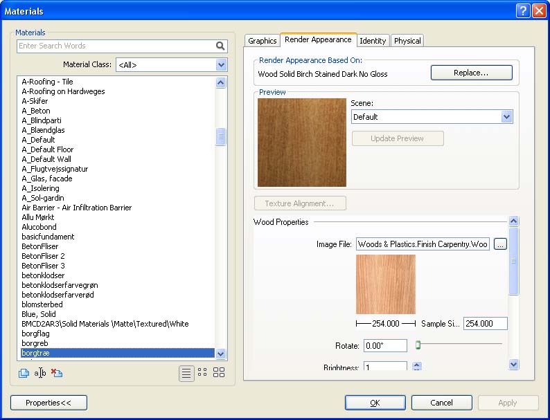

If it renders the default grey then that's because you have not assigned it a material.  Post a screen shot of the material assignments in the family and then one of the project.  In the project it should be under settings materials.  Have the material picked in the left column and the render appearance tab selected in the right column.

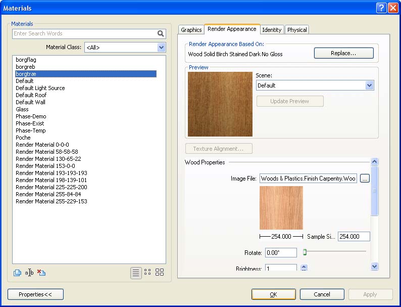

They are identical... I've attached them, just in case there is something I simply cannot see! ;-)

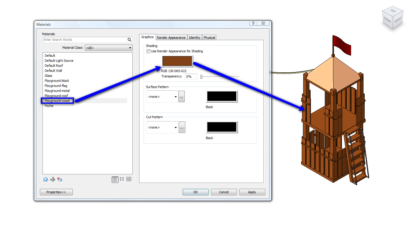

Are you seeing that "Render ###.###.###" in the Family??? Change those colors by the material you want and I BET you solve the problem....

In addition, I always recommend to change those names i.e. "Render Material 200-200-200" to "XYZ" this for a  better identification of these materials in your project and because of what WWHub told you before about that the project over-rides the material assignment in the family....

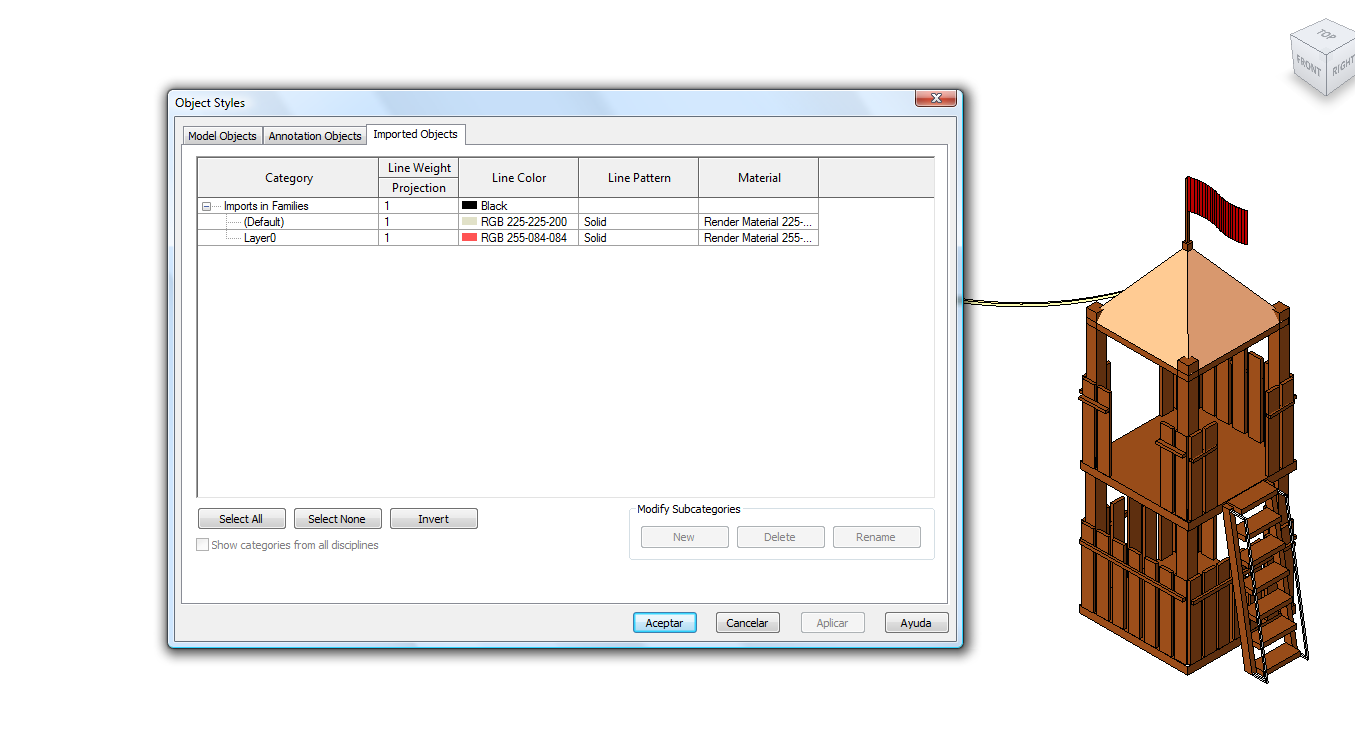

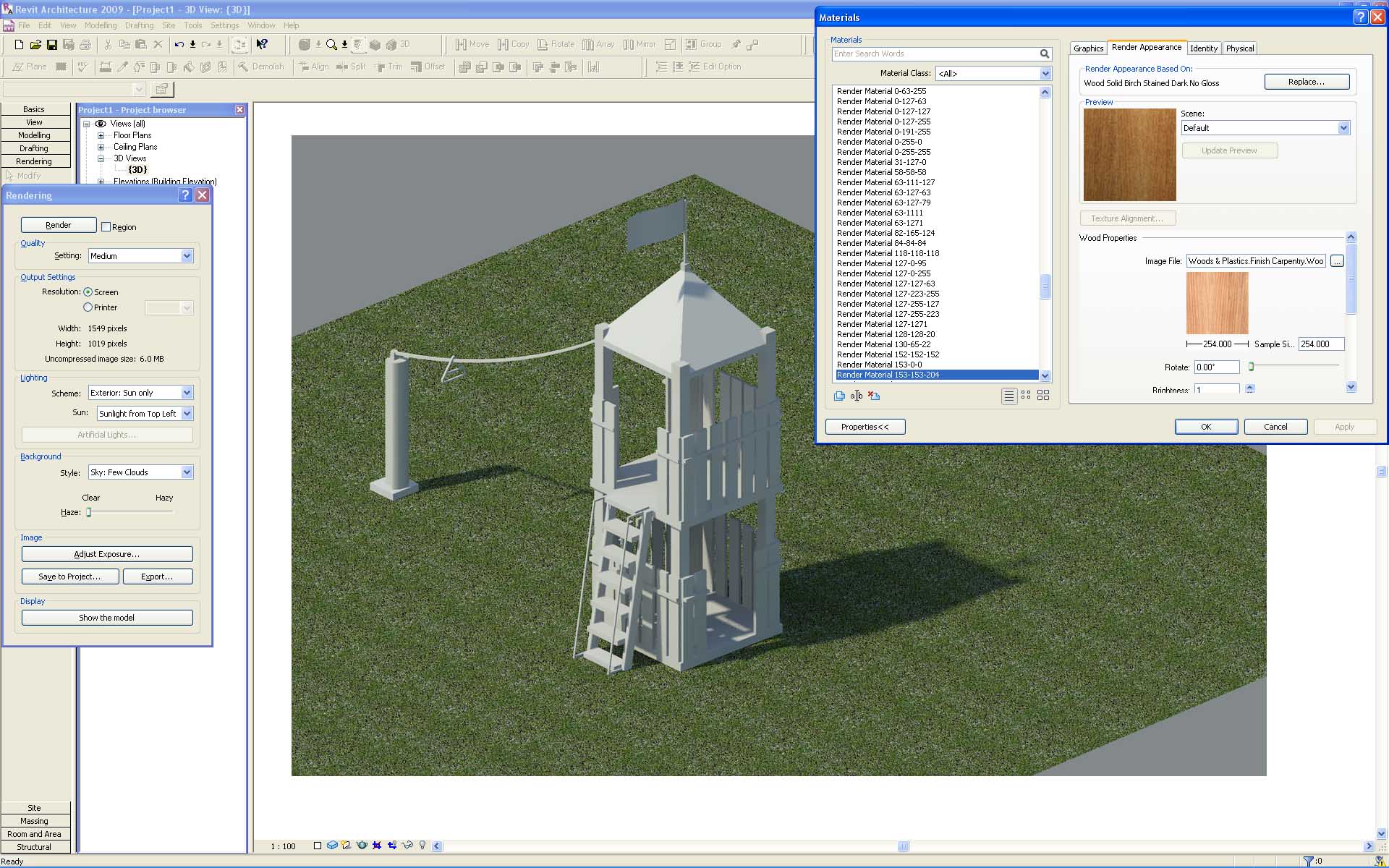

Tried to go back to the beginning... and did it all as simple and as straight forward as I could, from your advice there Typhoon!... Imported my SketchUp model to a new family, went to Settings/Objert Styles/ and instead of making new materials and assigning those, I located the different RENDER xxx.xxx.xxx materials allready assigned to the different layers from SketchUp, and simply changed them to the material I wanted. As I see it, I am doing excatly what you suggest Typhoon... right? Then I imported this new family into a clean model, made a toposurface and placed my little kids castle there on the ground... checked that the RENDER xxx.xxx.xxx materials from the Family, were there in the material settings, and checked that the materials I assigned were really assigned... and so they were!... and then I did a small testrender...
And SAME curse HAPPENED AGAIN!!! :-/ (See attached bitmap)
What am I doing wrong here???

"...Imported my SketchUp model to a new family, went to Settings/Objert Styles/ and instead of making new materials and assigning those"... Compare the first image with the second one, that's why I prefer to change the materials in Settings--> Materials.... you can see that there are more materials available and what I did is just to change the names...

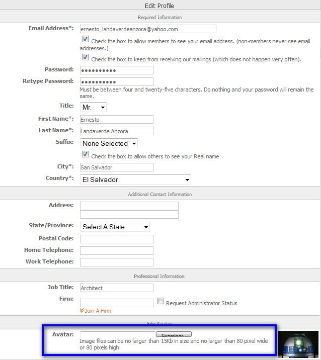

BTW can you tell what is the exact pixel and dimension of the avatar to achive the uploadable size?like i opened it on photoshop and pressed Ctrl+Alt+I = can you share what to input?thank you again my friend..i can't really post comments -_-" haha...glad it's workin on posting reply on forum.

"BTW can you tell what is the exact pixel and dimension of the avatar to achive the uploadable size?"....well, see the image....To tell you the truth, I don't know anything about anime or manga, well, maybe the old ones: Mazinger Z, Astro boy, etc, when I was a kid, perhaps 25 years ago hahaha.....
