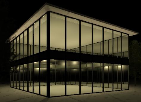

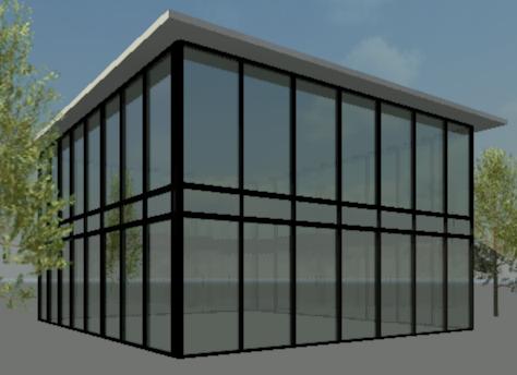

PeteGGA
Joined: Wed, Jan 16, 2008
25 Posts
5 Stars: 1 Votes
You have to have some content near by or it will just reflect the blue sky background. boost up your reflection to 25%-35% and add massing or walls near by and look at the effect it will have, also some lights inside do wonders(you need to increase the light strenght X10 to appear in a daylight shot)
Thu, Oct 30, 2008 at 12:36:15 PM | Rendering glass in revit 2009
#20
PeteGGA
25 Posts
5 Stars: 1 Votes
Sorry tried to load image but file siZe was too big, try this
