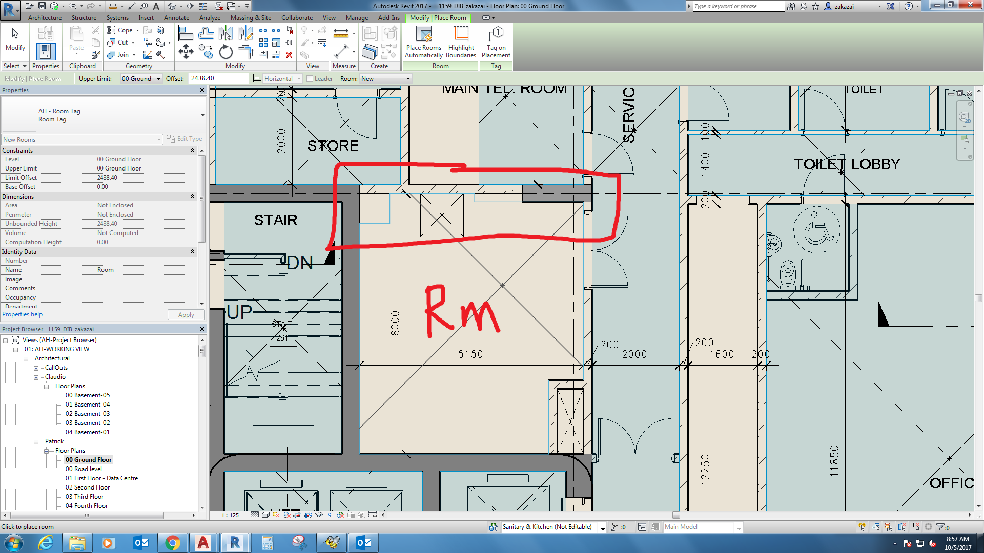

This is the issue as shown in the attached snap.
i am not able to edit and redefine the Rm boundary.
how i can remove that boundary and create new room.

  • i think you need to show us a section ( check if there is a room bounding floor or something ),
  •  check hidden objects ,
  • Open the room separation lines from the visibility graphics
  • Finally check that the plan associated level is the same as the room ( not the plan name , check the parameter )
thats what on my mind hope it helps

I see a room there but no room tag.  What are the properties of this room when you select it?  It may be the room below.
