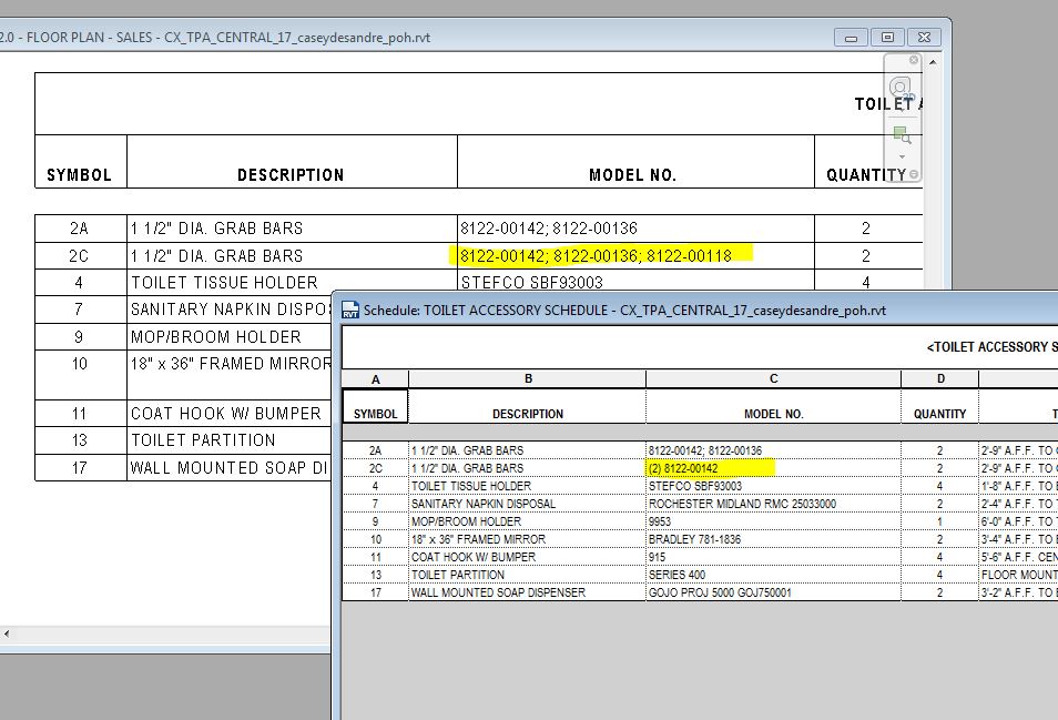

Just ran into this with a lighting fixture schedule in Revit 2016 Build: 16.0.1092.0
20151209_0715(x64)
Update1 for R2
Just figured I'd keep this thread alive until Autodesk fixes this. It's a little scary given how much we rely on Revit to stay in sync.

I also just had this problem. I just deleted the schedule off the sheet and placed it on the sheet again, updated the fields I was looking for. Fixes the problem this time, but now I'm suspicious of all of my schedules!

I am having this problem as well.  On an area schedule.  Updated space in plan and has not updated in the schedule on the sheet but when i click to edit the schedule it is shown updated.  Realized that this was the cause of a mis-communication earlier in the project while referring to this schedule.
-Byron
RMW Arch
Fully Engaged,
-Byron W. Saunders

We are currently exporting the schedules to PDF via Reports to avoid this sort of issues.
