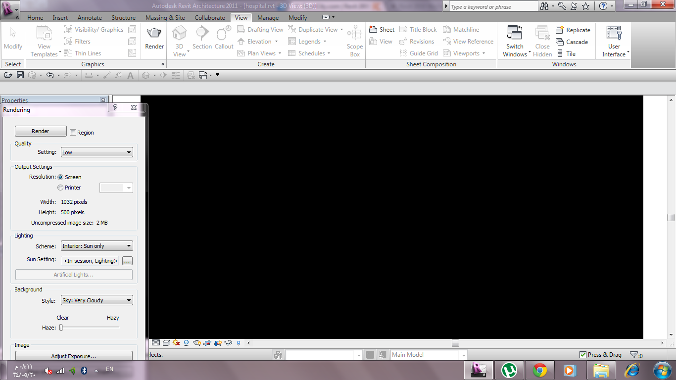

reham
Joined: Thu, Dec 20, 2012
4 Posts
I'm a student and I suffer from the same problem and I do not know I Masbb want a solution to this problem
Mon, Apr 1, 2013 at 12:25:41 PM | Revit 2009 Rendering Problem(Black screen)
#23
Joined: Tue, May 22, 2007
5921 Posts
4 Stars: 205 Votes
It's an "Interior" Render with "Sun only", did you have any light in there? Did you active "Portal Daylights"?
Mon, Apr 1, 2013 at 12:41:10 PM | Revit 2009 Rendering Problem(Black screen)
#24
reham
4 Posts
Yes, there have lighting but all attempts the same result
Mon, Apr 1, 2013 at 12:47:38 PM | Revit 2009 Rendering Problem(Black screen)
#25
That image says sun only!!!!!!
You have to turn on your lights and they can't be hidden by a ceiling.
Perhaps you should post the view before you render so we can see what you have.

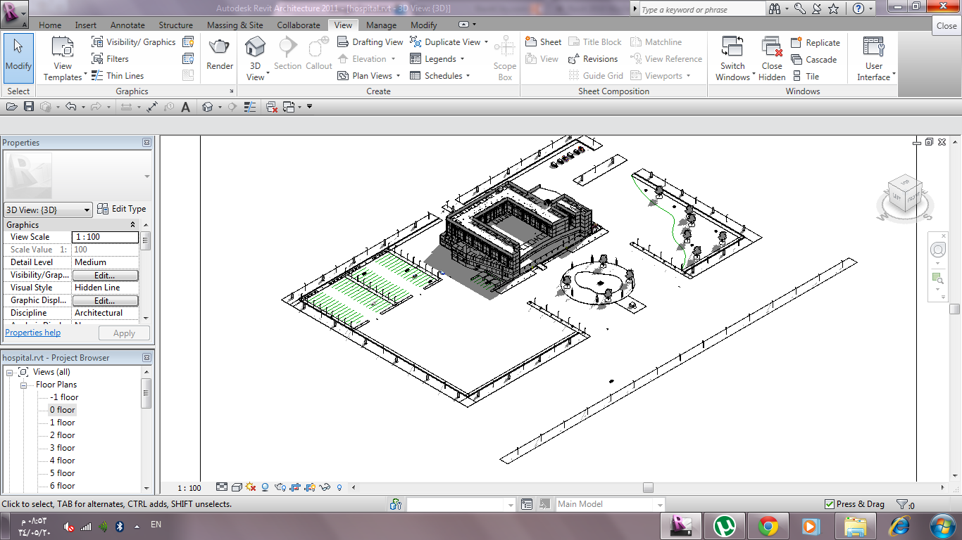

Mon, Apr 1, 2013 at 12:55:09 PM | Revit 2009 Rendering Problem(Black screen)
#26
reham
4 Posts
This prior work render
Mon, Apr 1, 2013 at 1:56:43 PM | Revit 2009 Rendering Problem(Black screen)
#27
teafoe5
teafoe5 Avatar
Joined: Fri, Nov 12, 2010
1749 Posts
4 Stars: 47 Votes
This is an exterior view so you should be using EXTIEROR Sun not interior
Mon, Apr 1, 2013 at 2:45:28 PM | Revit 2009 Rendering Problem(Black screen)
#28
reham
4 Posts
But I worked the same outcome
