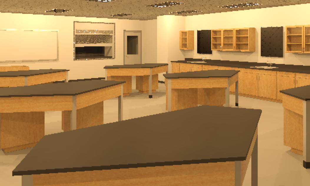

Can Anyone Help me? I was Recently still using REVIT 2008 and now using 2009 at work. When I opened up my Existing project into 2009, I had to update and reload my bitmap textures and other custom surfaces...but for some reason, when I run an Interior Only Render, all the Ligthing comes out a bright Gold/Yellow and look just terrible...i can tell that my objects are textured the way they are suppose to but with all the odd lighting everything in the room looks GOLD...What am i doing Wrong here? This Version of REVIT is mostly the same as 2008 with the exception of the Rendering Tab. Im kind of stuck at this point and I want to be able to see if my colors and textures are coming out properly but its hard to know now.

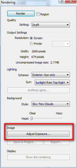

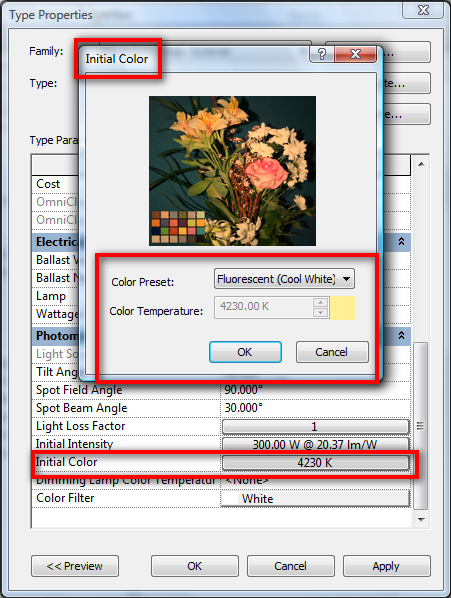

You must check in the lights properties the "initial color" and change that if you want, also after the render you have the "Adjust Exposure" where you can "play" with those parameters until you reached the "Perfect" image...

Hey Thanks alot! I did edit the "Adjust Exposure" Settings and it Helped ALOT...Big Difference. I'll do the Rest in Photoshop.
