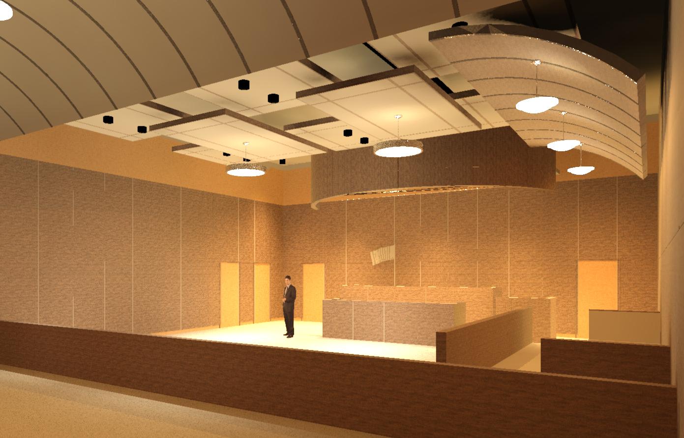

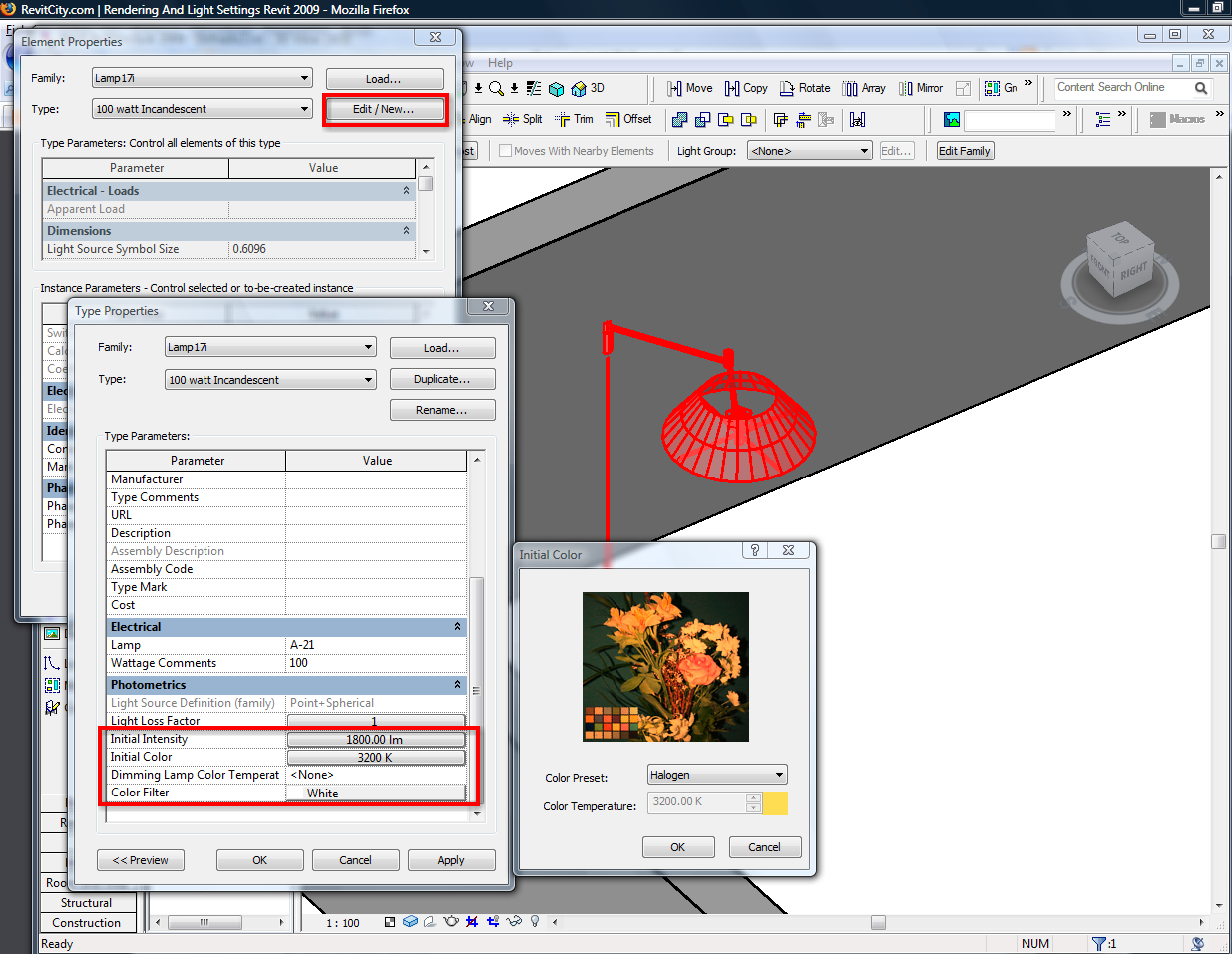

3 Stars: 1 Votes
I'm having the same problem with my renderings, the lighting tends to be too orange, and it also looks as if my floors are burning out.  (also having problems with light fixtures being too deep and I'm unsure how to edit them so they stay in the ceiling)  Any suggestions?
Wed, Sep 10, 2008 at 2:59:05 PM | Rendering And Light Settings Revit 2009
#22
Joined: Tue, May 22, 2007
5921 Posts
4 Stars: 205 Votes
Pick in the light, go to the properties> edit/new and change the parameters, see the image attached.

I've found this "yellowing" to be particularly bad in files created in older versions of Revit. You can edit the light fixture family and change the family type to use a cooler light source, lie fluorescent. They provide a nice preview of the how the chromaticity (color temperature) of different light sources will affect a standard image.
