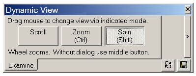

F8 - View > Dynamically Modify View - Dynamic View menu - How to get around? I want to spin and scroll with using some shortcut on the keyboard. I DO NOT WANT TO FIRST USE F8 - Functions tangent 8 -. and then from a new menu - Dynamic View -. select Scroll- Zoom and Spin or using SHIFT - CTRL to get at the commands at the menu. I DO NOT WANT TO USE THAT STUPID - DYNAMIC VIEW MENU - I HAVE TO CLOSE AFTER USING IT. I HAVE NEVER MET SUCH A STUPID 3D-PROGRAM . In all other programs you have shortcuts direct to zoom., scroll/pan and spin. - Or perhaps I am the stupid one . having missed something? HOW TO GET AROUND THIS???? YOU CAN OPEN the file KeyboardShortcuts.txt - to change other shortcuts to your own likings . but here in KeyboardShortcuts.txt you cannot find any way to use SCROLL, ZOOM AND SPIN direct . always you have to go through this stupid menu - View Dynamically.... HELP - SOMEONE WHO HAS A SOLUTION???

If you are using an intellipoint mouse, you can hold down shift, then hold down the centre button of your mouse and that will spin around the view, and still enable your objects to stay selected before and after the spin.

Sorry! The space tangent is no good!!! You can use it to open the Dynamic View. But then you cannot use it to close the Dynamic view because of an undocumented feature. Your are told to use SHIFT and CTRL to change to SPIN and ZOOM but you can also use the space tangent to change between SCROLL, SPIN AND ZOOM. So therefore you cannot shut down the menu with the space tangent, So now I have in keyboardshortcuts.txt decided to use "BB" to bring up and close the Dynamic view! Why is Revit so stupid? I believe it is programmers that has made this in some respects very good program. But those programmers have not worked with the program themselves. They have never realized that SPIN, SCROLL and ZOOM are the most frequent used commands. Animation Master www.hash.com is programmed of people using the program -. and the program started on the Amiga - therefore this program are userfriendly. Have a look at AutoCad that is the most stupid program I Know - it is a DOS program from the beginning made by people wanting to sell - making money - profits -not even programmers.... I have made my own CAD.program - but it is taking to much time to do your own CAD-.programs..- Perhaps someone are willing to do a little CAD-programming? on http://sourceforge.net/???? Making a new userfriendly Revit???

regardles oof how you work, without the use of a mouse the dynamic view can still be accessed and shut whilst maintaining your selection. Simply select your objects, press f8, then scroll, spin, whatever, then press f8 again to shut the dynamic view and you will return to the screen with your selection in place. I'm sure thats not perfect and does require one tap for f8, and one click for spin, but its not too bad. Be intersted to hear if there is a way to modify the keyboard shortcuts that is quicker than that. Post edited on 2005-02-09 11:16:34 Post edited on 2005-02-09 11:17:43

Double click the elevation datum symbol, (circle with hatching at the end of a level) You can...notice under the VIEW menu Temporary Hide Isolate and the nested menu options beneath. If you select items and use the shortcuts available you can do this. May make you irritable but F8 is what your choice is if you don't wish to use a mouse or pen.... edit: I included quotes from your text, but after editing the post they disappeared, looks like a glitch in the forum? Post edited on 2005-02-09 15:08:17 Post edited on 2005-02-09 15:09:36

With a mouse: Views other than 3D: Mbutton = pan Mbutton+ctrl = Zoom 3D views: Mbutton = pan Mbutton+shift = spin Mbutton + Ctrl = zoom With a pen: (pressing shift initiates behavior, this also works with mouse) Not 3d views: Right Click+Shift = pan, release shift, press Ctrl = zoom 3d views: Shift then Right Click = spin Release Shift = Pan Press Ctrl = zoom Press Shift = spin again with Shift pressed, release right click = end or press Esc to quit dynamic viewing Pen sounds hard, easier to do than write. You asked why no shortcut to level views (floor plans), double clicking the datum on a level will take you to the floor plan for that level, like elevations or section do if you double click on them. You can make shortcuts for the temporary hide isolate features. I've attached our keyboard shortcuts file which has every command in Revit 7.0 listed even if no shortcut is assigned. Post edited on 2005-02-09 18:08:52
