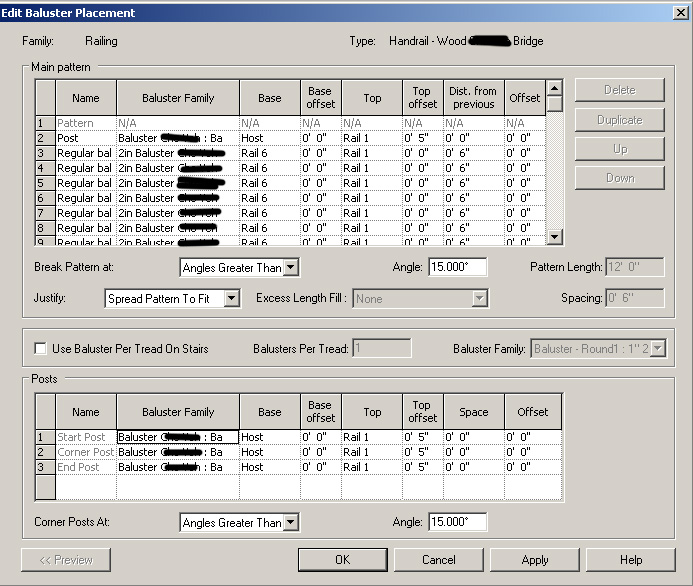

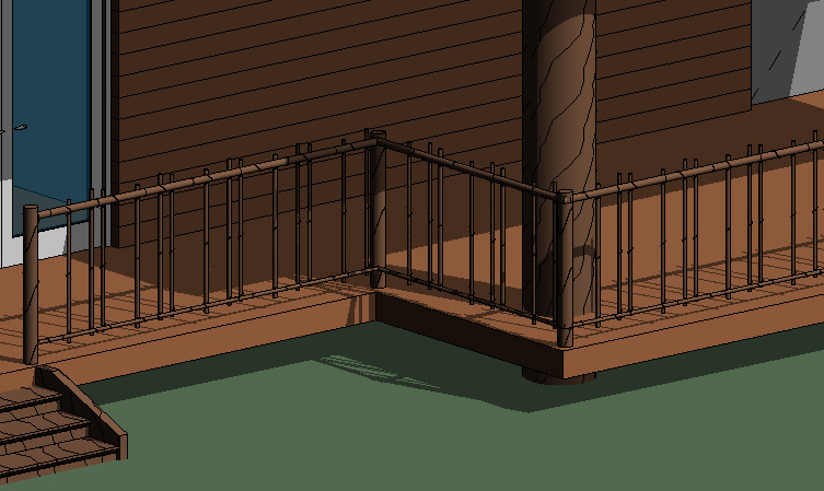

 here are a couple of pictures of a rail i made.  It looks pretty simple, but i had to create everything in the family editor and then figure out the placment on my own.
(i blacked out the name of my project for security reasons)

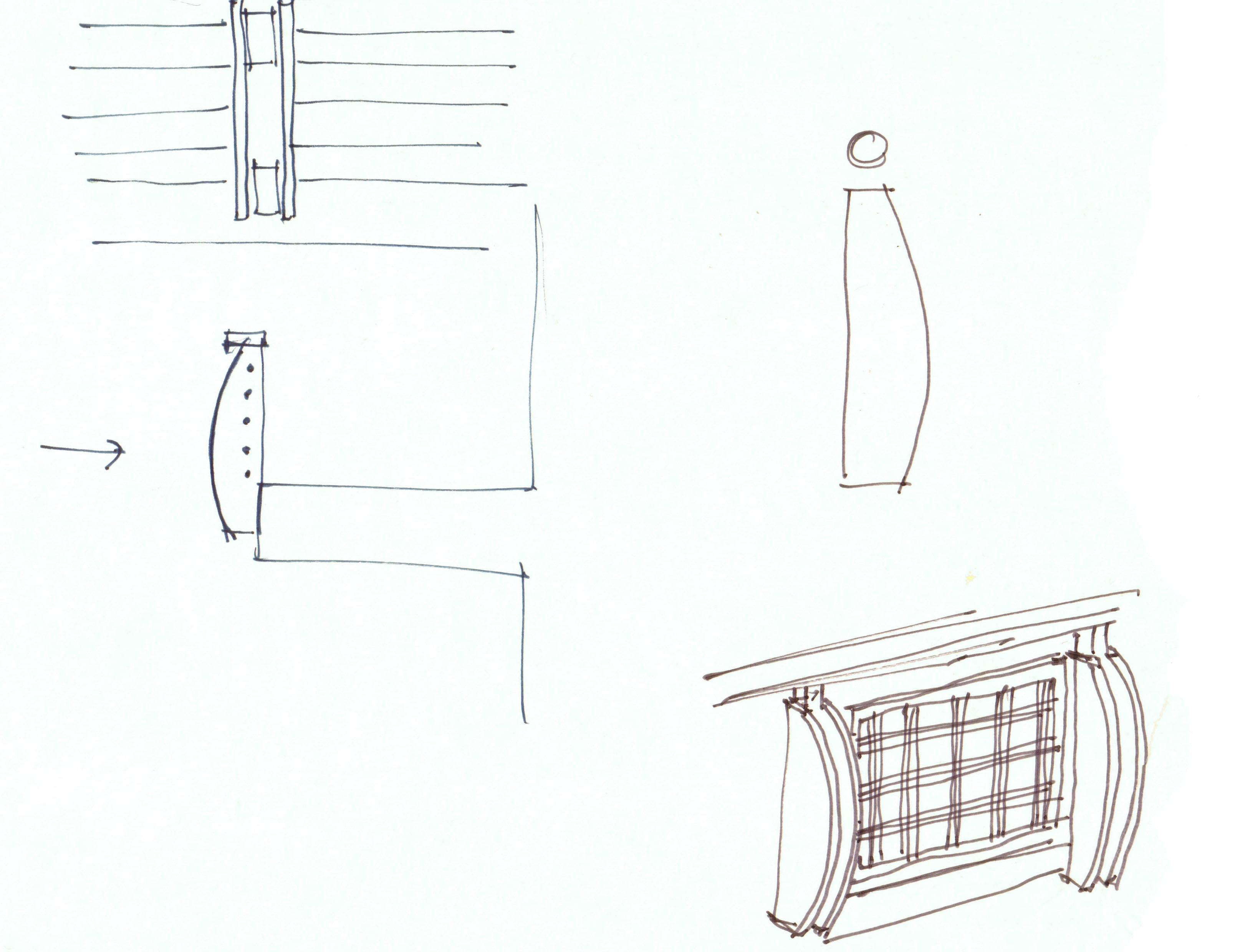

Tue, Jun 12, 2007 at 6:21:15 PM | Creating your own custom railing?
DLicata
DLicata Avatar
Joined: Mon, Apr 2, 2007
278 Posts
3.5 Stars: 7 Votes
Ok heres a profile and some other little sketches.  I hope you can understand these.

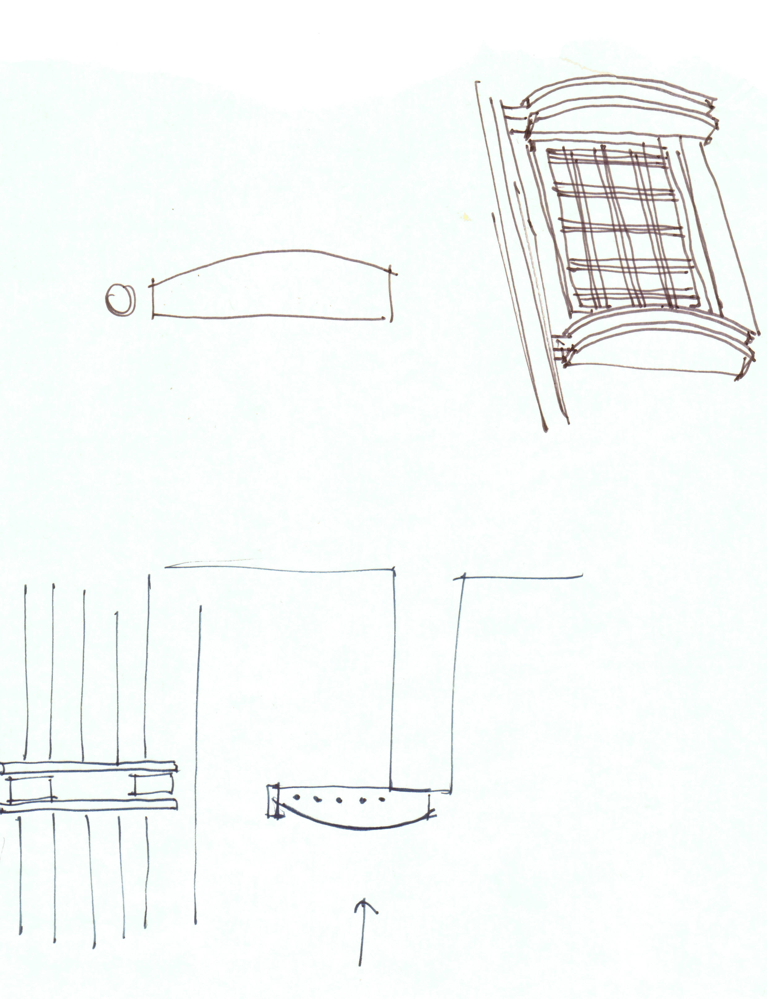

Tue, Jun 12, 2007 at 6:24:12 PM | Creating your own custom railing?
DLicata
DLicata Avatar
278 Posts
3.5 Stars: 7 Votes
Wow it came in sideways... sorry here you go.

Wed, Jun 13, 2007 at 10:56:32 AM | Creating your own custom railing?
broncos4life
Joined: Thu, Nov 10, 2005
390 Posts
3.5 Stars: 11 Votes

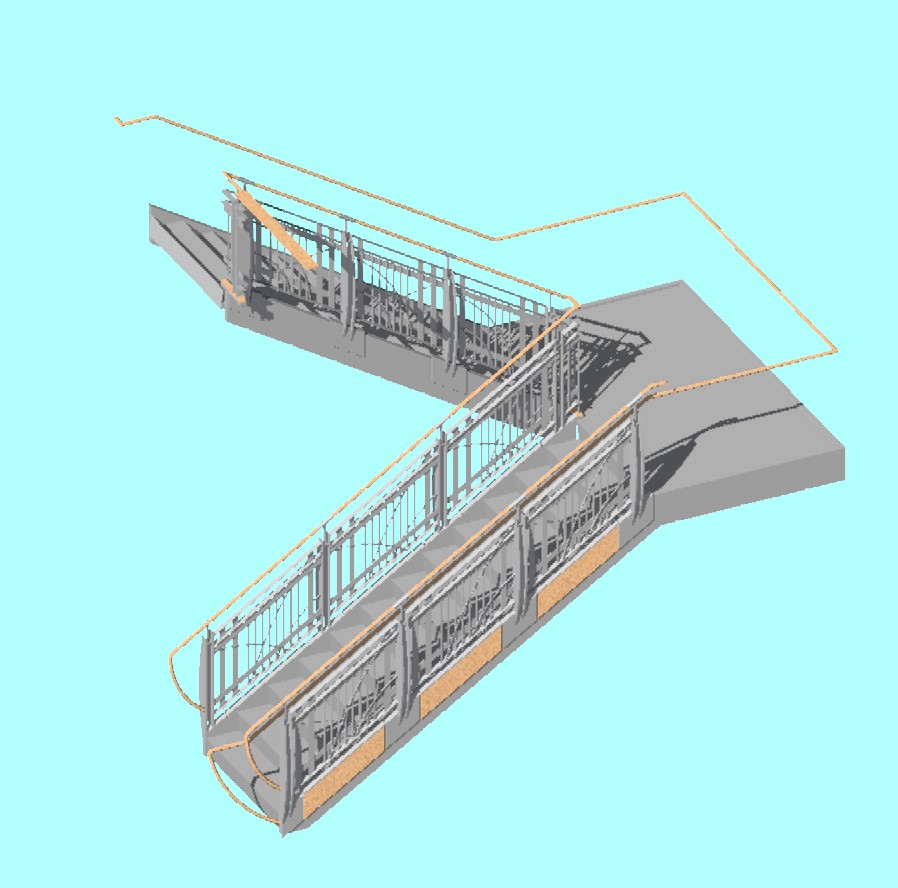

Im not sure how great the picture turned out, but here is a set of railings that I did for a project of mine.  I had to use massing, and in place familys to create this.  It took me about three days to build this, with all the correct ADA, and other regulations.  The rendering is pretty shotty, but it should be alright to get the jist.  I will post a better rendering of it later.  Let me know what you all think, as well as if you know of a way to create that using revits "Railing" comand.

Wed, Jun 13, 2007 at 5:04:00 PM | Creating your own custom railing?
Atomsk
Joined: Mon, Mar 19, 2007
39 Posts
5 Stars: 3 Votes
Bronco, your rendering is bad, but the railing is sweet.  I don't think i could do better.
DLicata, your sketch is do-able in Revit.  Just build the post and balusters in the family editor.  (mesh=balusters)
You wont have any rails.  Unless you decide to go with just cables.  If you do then you probably have to make those yourself too. (super easy)
Revit 2010

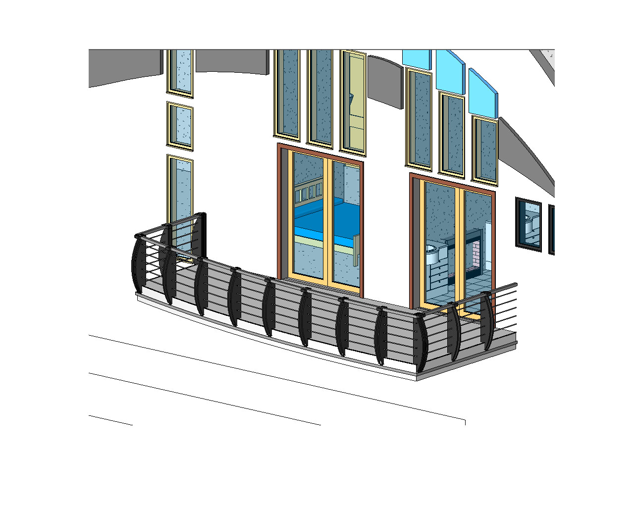

HAHA cool.  I understand it now.  Thanks Atomsk.  It's getting closer but this is how it looks so far.

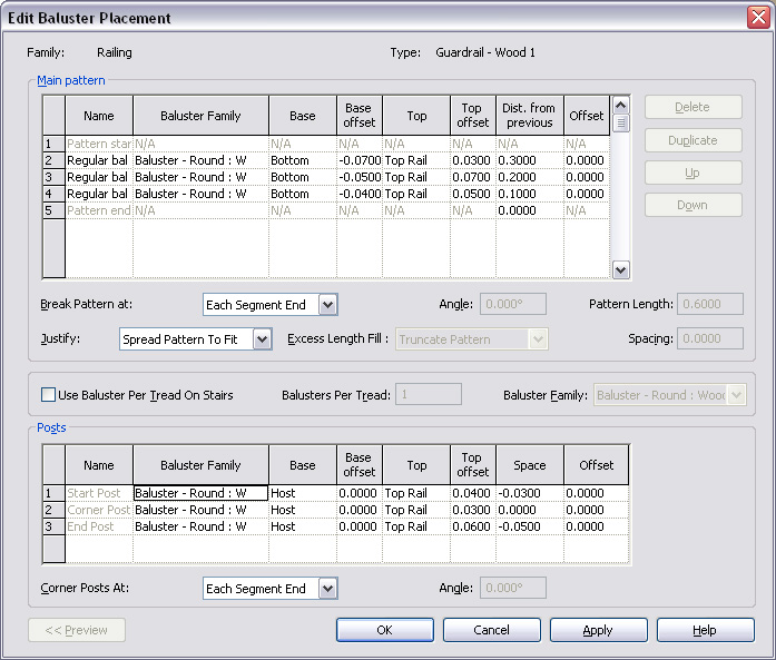

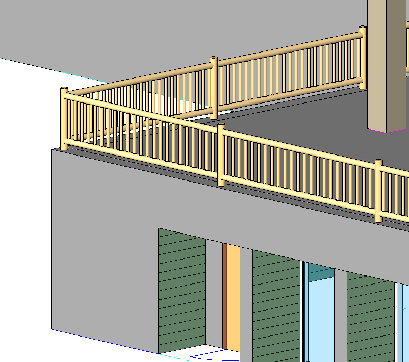

Pretty simple. Just space and offset several round balusters at odd distances and give them a wood material. I did this for a project I'm currently working on. Here are some settings.

That's exactly what I needed. Your help is greatly appreciated
