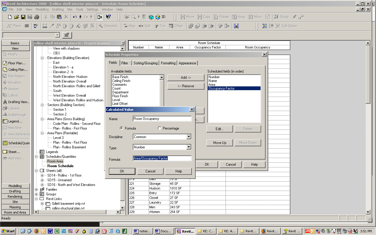

I tried the schedule idea and still hit a dead end.  Sorry, I'm an experienced Autocad user but a fairly new Revit user so could be missing a basic issue.  Attached is a screen shot... maybe you have some thoughts?  I keep getting Boolean and various formula errors.  The Revit help... wasn't much help on formula syntax.

That part looks good. Make sure that your "Occupancy Factor" is a "Area" type, not "Number" type, but may want to try this formula for code purposes (fraction of a person counts as a whole person):
(Area / Occupancy Factor) + 0.499

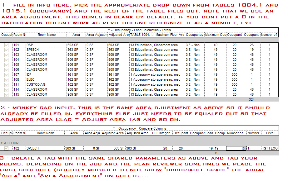

It looks like your issue could be related to the units not meshing out. The formula we use is as follows:
(Area / Occupant Load Factor) / 1 SF + 0.499
You have to remove the area in oder to get an Occ load.
Along the lines of other life saftey issues, we use schedule keys for Occupant Load Factor, Gross/ Net and # of exits Required. It takes a little setup but in the end it works very well.
Our basic flow for life saftey is:
- Use the Load Calculation table to input all of the required information (Revit gives you area between wall faces but you may want an area adjustment for spaces that allow net; ie removing fixed casework)
- Use a Compare Columns table to push the calculated values into shared parameters (the same calculations as above but with a filter set up so that if the shared parameter Occ Load = the calcualted value Occupant Load and the same for number of occupants and exits then that row doesnt show up) So that when theCompare Columns schedule is empty then you know the calculated values are the same as the tagged valuses
I find that the area adjustment works well for exiting and then you can use the base area for program justification. If you want to get really compliacted you can have 2 area adjustments; 1 that is subtractive for fixed casework and the like which is used in exiting and the other would be additive where you take the perimiter of the room x half the average thickness of the wall (manuall input) for a more accurate occupancy usage within the building area.
Hope thats not to confusing. I will provide screen shots but the grunt work of getting the schedules to work and talk to each other is up to you Smile
Nick
PS I know this uses many a dreaded work around, but its better than drawing a polyline, getting that area, putting it into a spreadsheet to calculate and then placing it back in a tag. At least some of it updates automatically and you just learn to check the Compare Columns schedule before printing for agency review.
