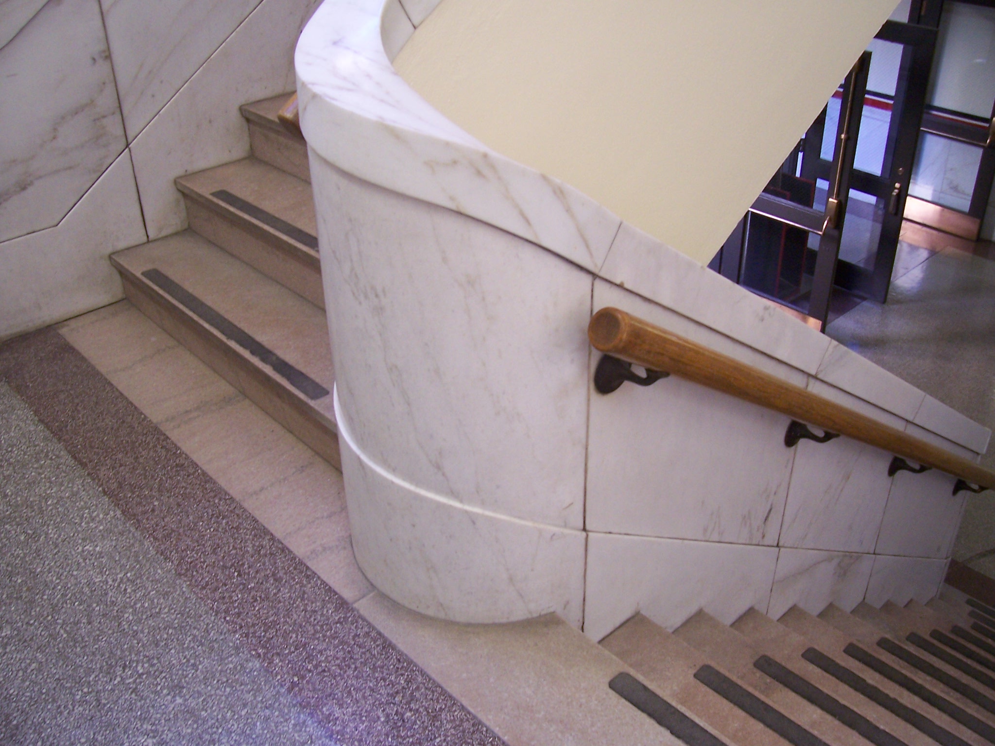

Got the stairs all figured out. thanks for your response. now, another problem. How do I build this?

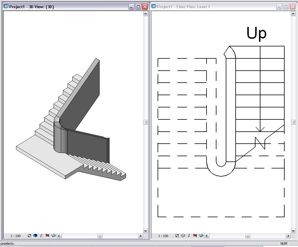

Just do it as a railing.  My example is pretty simple, you could easily make it more detailed by using a couple of railings - you aren't limited to one railing per stair.

I can't get the rail to follow my stair. First corner (landing) is fine, and then when it takes the next corner UP, the rail changes its height. what am I doing wrong?

Hard to pinpoint without knowing the exact layout of the stair.
Upload a purged file of just the railing and the stair and i'll try to have a look at it.

Looking at your stair sketch its pretty rough which is probably the cause of your issue.  For starters you have run lines located in some strange location that doesn't even correspond to your stair layout.  This has probably happen as you've tried to edit the layout...  Also the tread depths vary which i'm pretty sure is illegal.
Basically I'd suggest delete your current stair sketch, then sketch out the boundaries of the stair with reference planes as well as the middle of the run.  Before drawing your runs using the run command ensure you have set the correct tread depth that you require in your properties as well as top and bottom levels and number of risers you desire.  You can then edit the inside landing sketch line to have a curved boundary to your needs.  Simple delete the unwanted line, trim the other boundaries to your curved line and then ensure your tread lines are correct extended to meet the curve.
Then its just a simple matter of using the edge of your stair as the path for your railing and giving the railing an appropriate offset so it is correctly located in plan.
