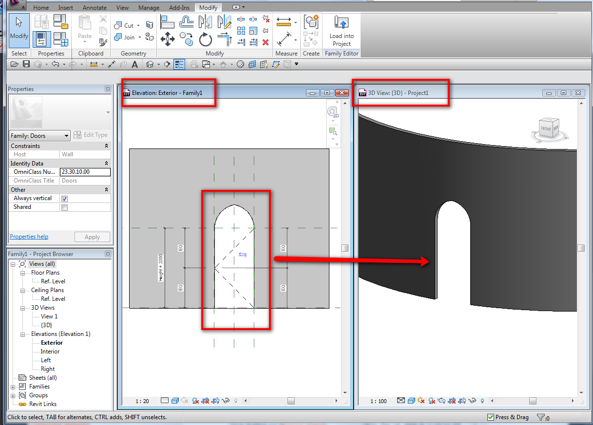

Hi folks, I am having a modeling problem that I thought someone might be able to help me with.
I have a curved wall, or a wall with a radius - its actually a "turret" on the front of a house as the entrace - and I want to create an arched opening in this wall. Usually, when I want to create an arch, I just edit the profile of the wall. However, that option is not available with a circular wall.
I can create an opening in the wall - through the Modelling tab, under openings - but this only allows for a rectangular openings.
Anyone have any ideas? Thanks in advance!
AJ

too easy..
put a reference plane infront of your wall,
under your modeling tab click "create..." select a wall category (won't make any difference just keeping it tidy)
choose void extrusion, set your work plane and choose the reference plane, go to the elevation of the wall,
sketch your opening, finish, make sure the void is going through the wall, cut the void from the wall.
finish family.
see attached image.
HTH

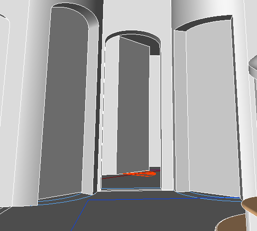

what if you have a smaller radius wall?
I'm attaching some pictures to demonstrate.

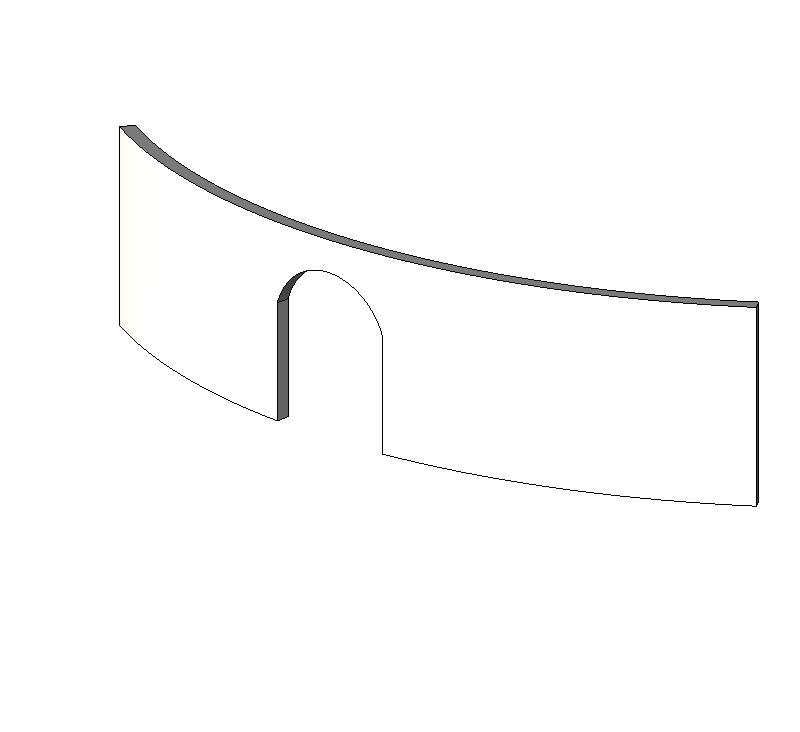

Tue, Jan 23, 2007 at 6:26:37 PM | Arched Opening in a Curved Wall
sabaka
Joined: Tue, Apr 18, 2006
16 Posts
well, you're right.
I guess i didn't pose my question correctly
What I was thinking was: Is it possible to create an arched opening that will resemble the rectangular opening using the method you provided (which, by the way, was extremely helpful)
I attached an image to compensate my bad explanation Smile

In this case I'd suggest doing as eldad suggested - an inplace family void, but not an extrusion, as a blend (you could also create this as an external family with adjustable parameters that calculate the blend requirements based on the radius and size of the opening, but that would be fairly complex.
Basically you could use the same principles as my tutorial on attaching a wall to the underside of a stair to achieve the desired result.
HTH.

Thu, Jan 25, 2007 at 4:53:28 PM | Arched Opening in a Curved Wall
sabaka
16 Posts
WOW
It took me longer to find that tutorial you mentioned than to actually read it and use my new found knowledge to make that arched opening.
I'll attach some drawings, just in case someone wants to see what the heck I was trying to do.
