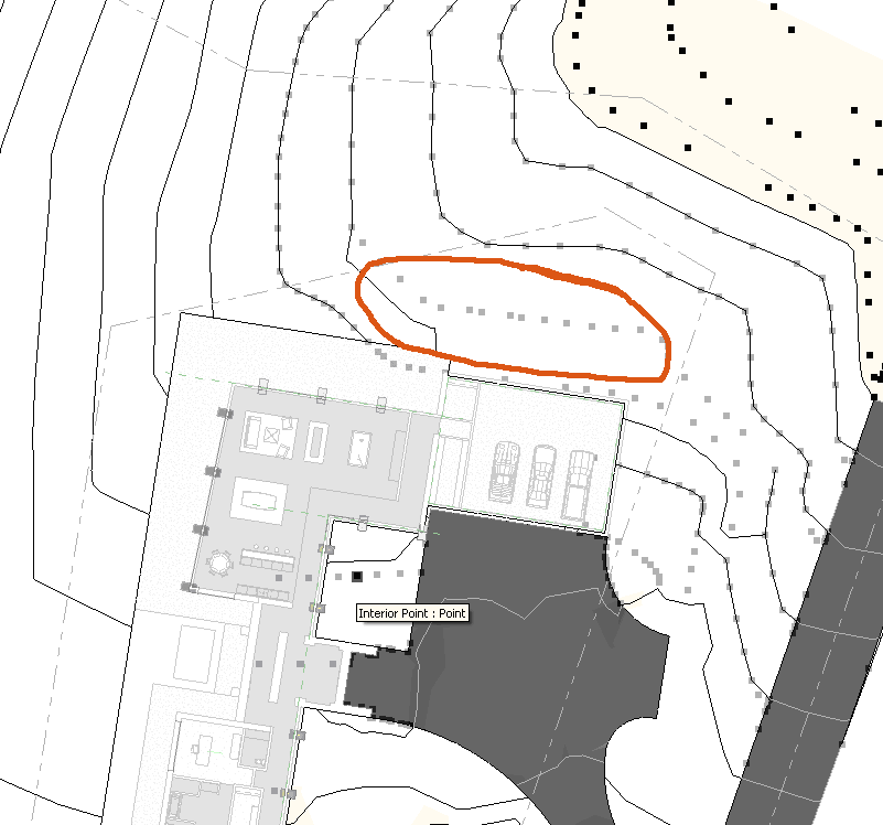

Thu, Dec 7, 2006 at 10:57:55 AM | Topography Quality
markdecker
Joined: Mon, Nov 20, 2006
5 Posts
Mr. Spot
Thanks again for the response.  Try this picture out.  Our biggest fear is that we are receiving topo from our surveyors, we are bringing those points into Revit, and then Revit is creating a topo skin that doesn't follow our entered points.  I know that our points are in Revit correctly because when I try to edit the topography they are correct, as shown in the image provided.  I can appreciate the accuracy in section and elevation, but our plan (and hopefully our 3D) needs to be correct too.
Thanks again for the help, its tough to answer these questions.
Thu, Dec 7, 2006 at 4:14:17 PM | markdecker
Mr Spot
Mr Spot Avatar
Joined: Mon, Jan 12, 2004
2889 Posts
4.5 Stars: 93 Votes
Quoting markdecker from 2006-12-07 10:57:55
Mr. Spot
 Like I said before the actual modelling of the topography will be correct in 3D.  If the display of the contour lines in plan is a major issue, the only real solution is to turn them off and use the survey plan dwg as an overlay and display their contour lines instead.
HTH.
Regards,
Chris.

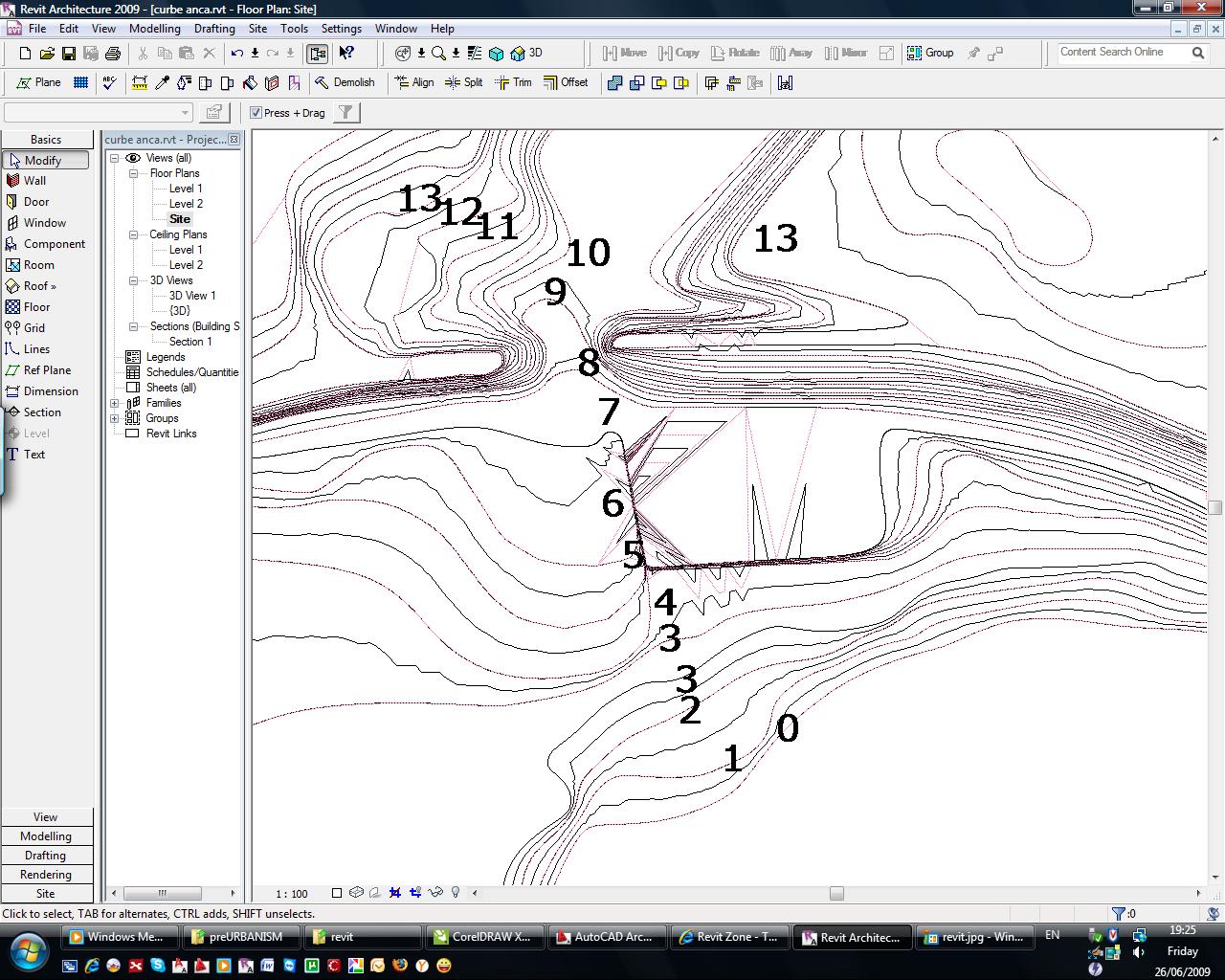

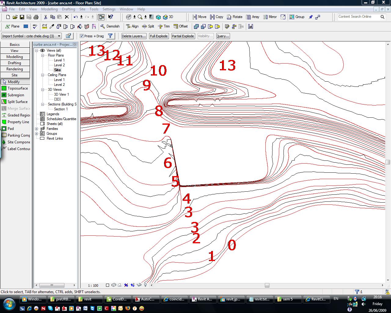

Fri, Jun 26, 2009 at 11:45:32 AM | Topography Quality
vrijaya
Joined: Fri, Jun 26, 2009
10 Posts
Can anyone tell me why this errors occurs in a topography? I atached the picture. This is a site generated with imported dwg splines...I am using Revit Architecture 2009. Pink lines are secondary lines.

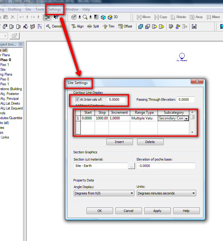

Fri, Jun 26, 2009 at 11:57:28 AM | Topography Quality
#9
Joined: Tue, May 22, 2007
5921 Posts
4 Stars: 205 Votes
Edit the Topo and increase the number of points in those zones...
Fri, Jun 26, 2009 at 12:03:41 PM | Topography Quality
#10
Maybe you should examine the points on the imported splines.  I would look at the dwg in a 3d mode.  I think you will find teh problems are in that file.
Fri, Jun 26, 2009 at 12:25:08 PM | Typhoon
#11
vrijaya
10 Posts
Quoting Typhoon from 2009-06-26 11:57:28
Thanks a lot, it worked by increasing the number of points, but I still don't understand, why the Revit curves don't overlap the Autocad curves or points. The red lines are the dwg file. Is it possible to improve the quality of my toposurface somehow, I tried to use Simplify Surface tool but it did a slight difference.
I am new to Revit so I might ask things that are already obvious to the others. Smile
Veronica.

Fri, Jun 26, 2009 at 12:35:09 PM | Topography Quality
#12
5921 Posts
4 Stars: 205 Votes
Go to Settings>Site settings then you can increse the value you want....
Fri, Jun 26, 2009 at 12:37:06 PM | Topography Quality
#13
You said the cad drawing was splined.  Splines in CAD follow a set of rules based on where the points are.  Revit's topography lines too follow a set of rules based on where the points are but in this case, the points are probably few.  Remember... topography lines are either just a "drafter's interpolation of surveyed points or a CAD interpolation.  The points may be correct but between those points, two draftsmen could draw it differently.  Mor points - more accuracy.
Mon, Jun 29, 2009 at 6:10:52 AM | Topography Quality
#14
sagarkagathara
sagarkagathara Avatar
Joined: Sat, Jul 5, 2008
30 Posts
Mark,
You need to go to 'Settings'--> 'Site Settings' and  then adjust distance between 2 contours down to 1' (or whatever the minimum distance you want to see on your drawing).
 Now your contour lines should follow the points you entered.
Mon, Jun 29, 2009 at 6:52:06 AM | Topography Quality
#15
vrijaya
10 Posts
Thanks for your responses. I've managed it!
