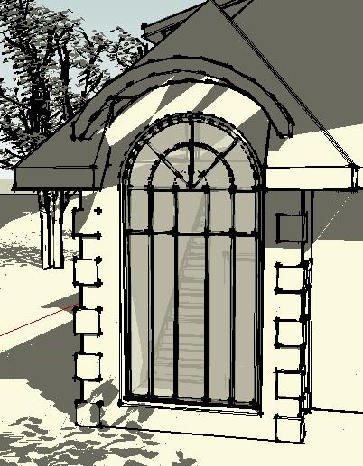

. I realize I'm a little late getting on the SketchUp boat. Too much production work to keep me busy.... I agree with Kesflower. I have started to export from REVIT to DWG (acis solids) then inport into SketchUp (don't forget to change your units to inches) and then BACK to REVIT with a cool jpg snap shot ! In sketchup I apply the sun shadows, display line 'jitter', add in a few trees, cars, people, air planes background buildings or whatever and just like that I am an Architectal illustrator, Well not quite but good enough to fool most, hehehe. I also leave it in Black and White on a tinted background some times and it looks even more like a hand sketch on tracing paper. Seriously my clients don't know what hit them. I do a screen capture of the new cool sketchup 3d view, save as jpg and import it back onto a REVIT sheet. My drawing presentations have taken on an entire new look. I am, also working on a large residential developement project where by I am providing the cool Sketchup 3d views in black and white after designing in REVIT, and then a real illustrator gets out the colored markers and goes to town. This works great for closeups too. Zoom right in and capture just the entrance or another special detail you want to enphasize. I have attached a sample that took nothing to create. I can add color or leave it as is.
