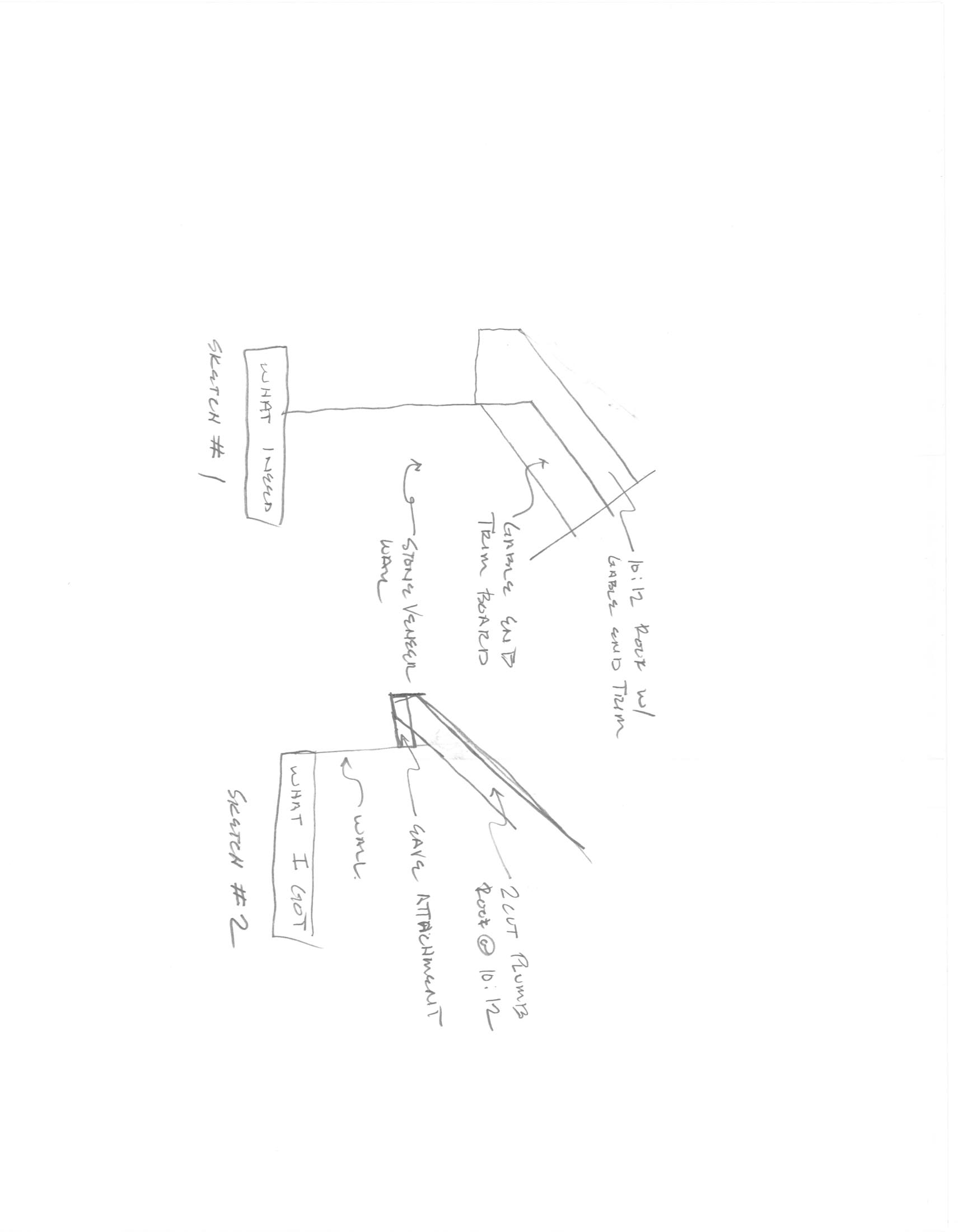

I can not find the referenced information on the AUGI site.  and I am trying to get my roof eaves to look like the following.  Any suggestions, right now i have the second sketch from what i can figure out.

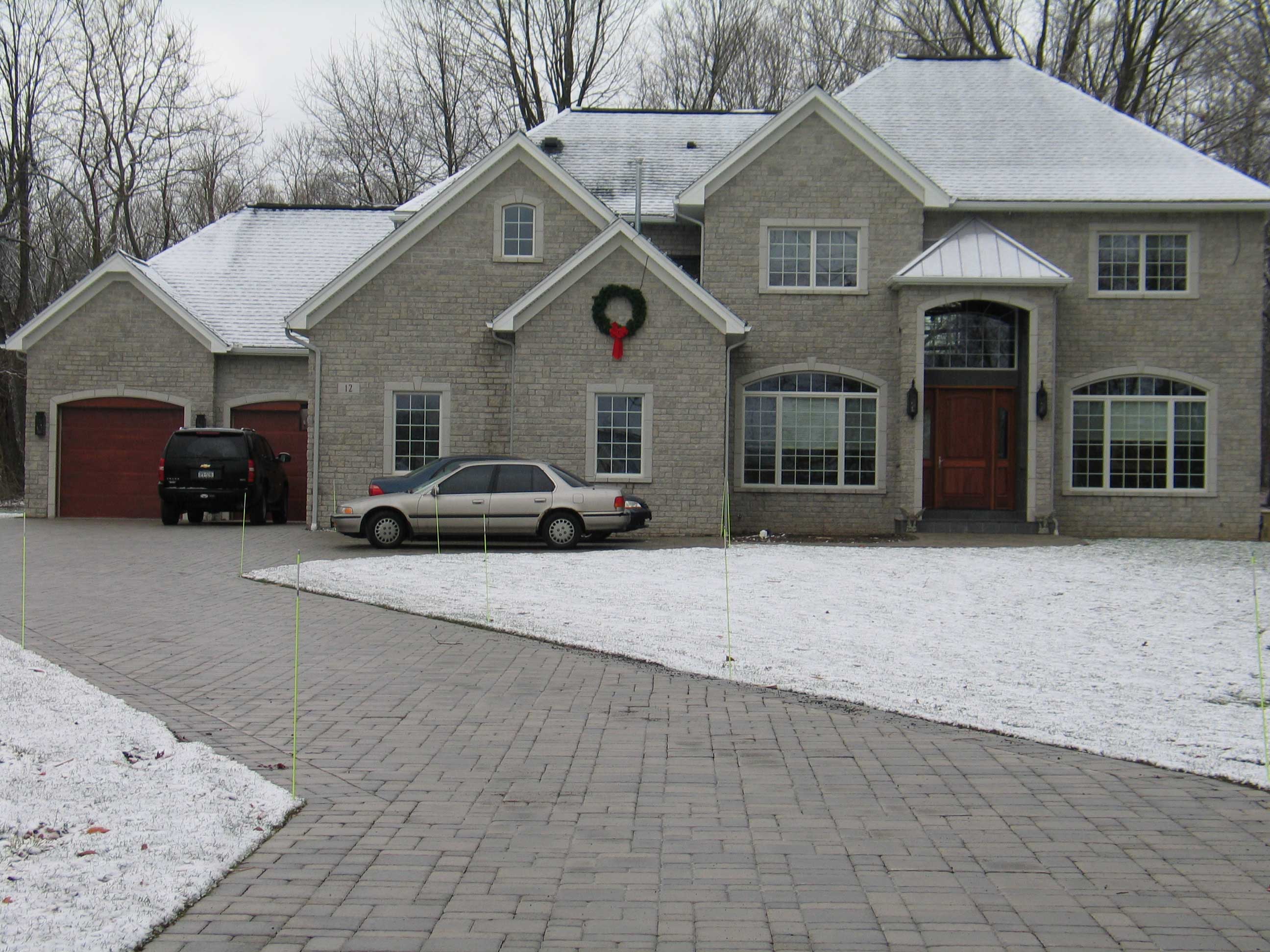

I am looking for both the solid eave return and the gable end trim board.  As you can see from my sketch (maybe) i can get an eave return but it leaves a triangular void above it that shows in the elevational views.  Do i have to do it like i would in autocad and draw the triangular profile and extrude it around the roof profile?

ok, long story short, I did the attached house in Autocad, we are trying to put it into revit to use it for modelling and other marketing purposes.  With that being said, we used extended bottomo chord trusses to get flat eave returns.  Revit is only using extended top chord trusses (sorta) to frame the roof so I need to get the gable ends to have the profile in the attached photo.  Any suggestions, please be explicited as i have about 2 weeks of self taught training.
