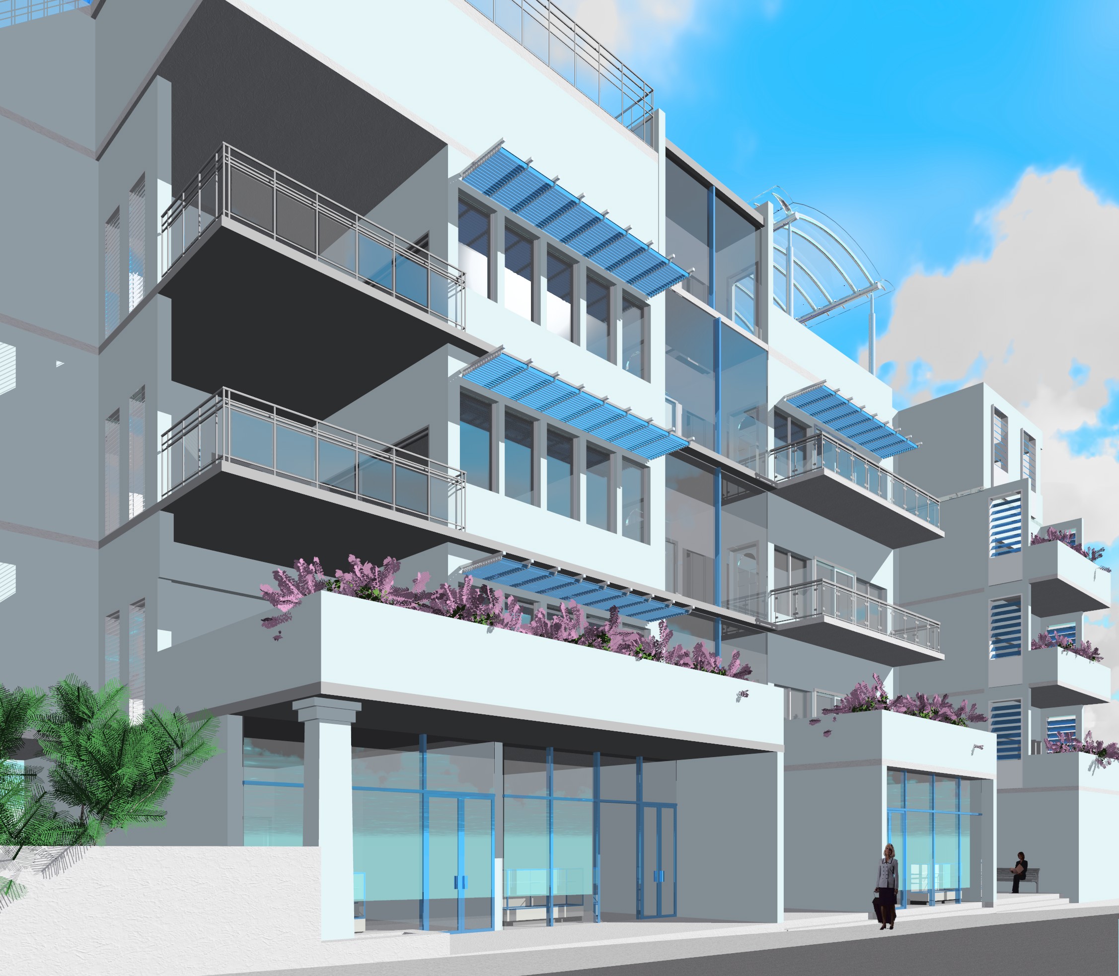

well i can say this was my first time using revit and actually my 1st big project at school. I can say that i recieved high marks due to not just my design but realistic renderings. I had absolutly no experience and taught myself with the help of revit chat room and helpful revit city members. I used raytrace quite a lot because some materials just look bad so i played with many different materials although i didnt go into to much depth as time was a factor. I recieved comments on my project that the presentation was excellent. I will attach a few renders and also some other attachments just to show what i did with revit and id used it for no longer than 2-3 months. There were many other aspects of my project i could have improved and also i would have loved to have tried lighting and night renders although time was a problem. Im still deciding whether to use ADT (Viz Render) or Revit this term for my new projects which are very important to me. So any opinions on these 2 programs like negatives and positives would be greatly appreciated. Also many of these renders i reduced the quality so i could attach them and i never used photoshop

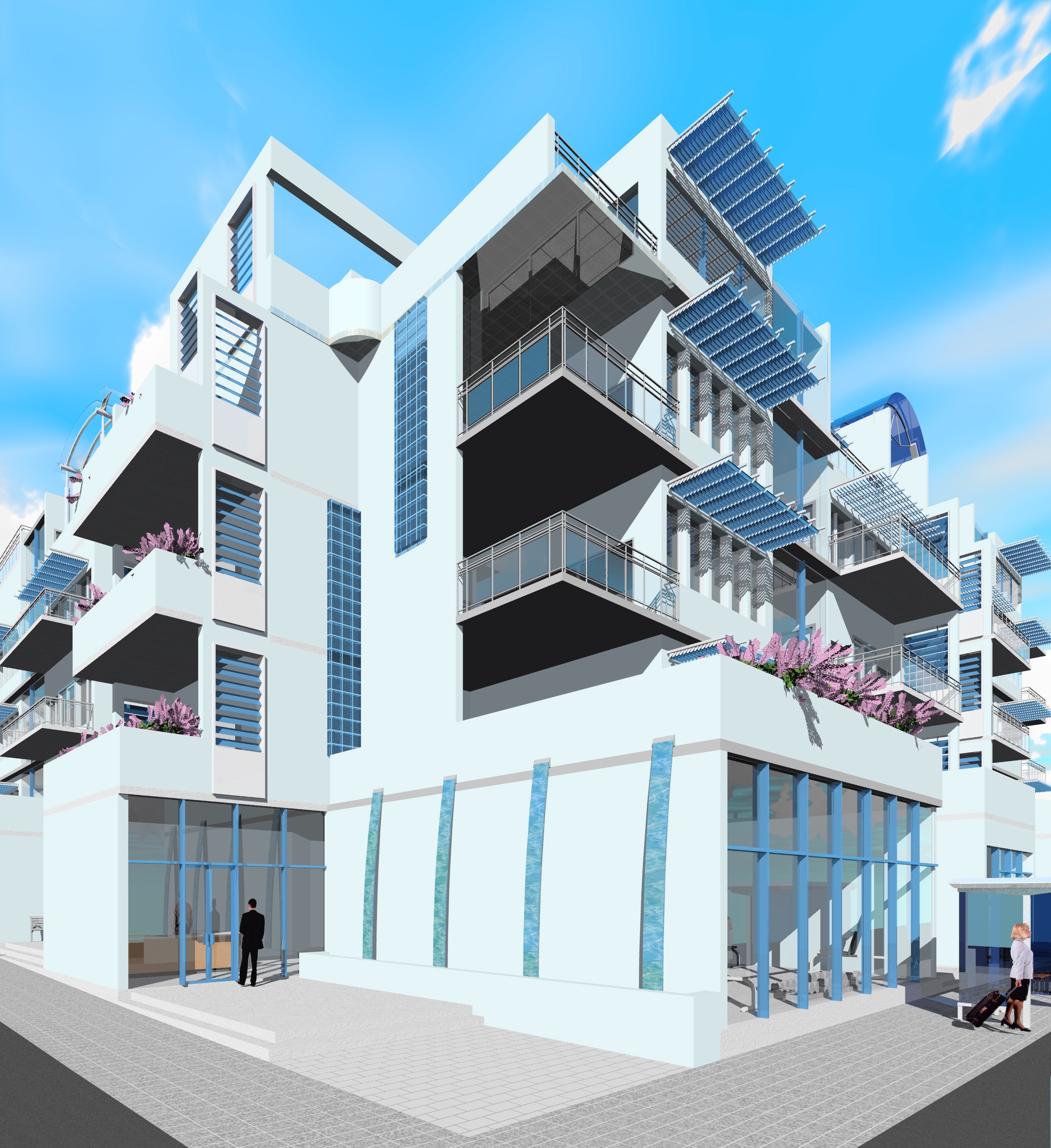

corner view has many improvements needed such as sky and the lady is floating a bit haha. easily fixed but had no time

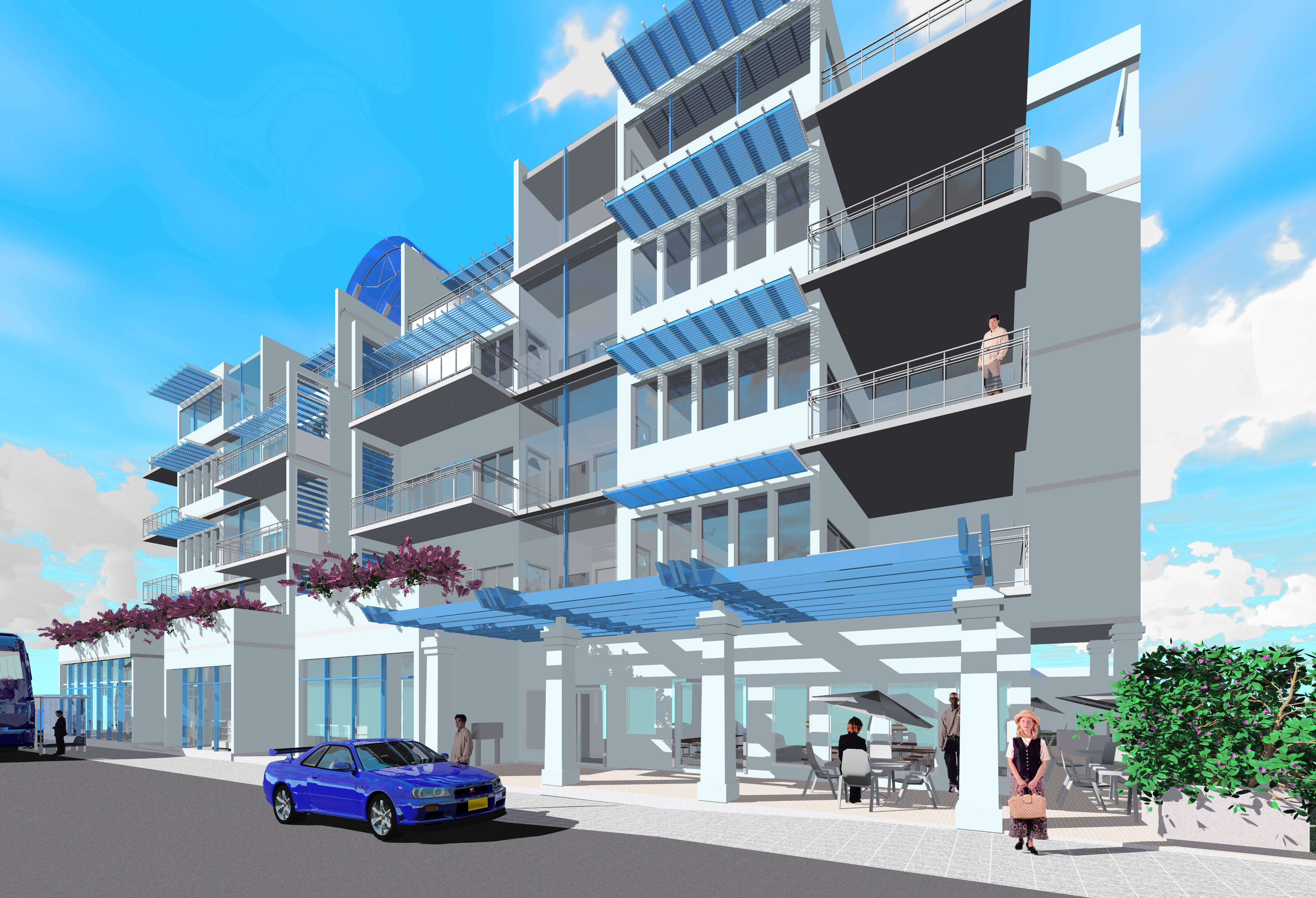

another view of my building i did many others but dont want to spam the topic lmao. I mean i dont know how realistic your talking but when these are printed with my lazer jet printer they look really impressive. So i mean thats 2-3 months experience and time on a project that was really big. I must admit when getting towards the end of my project i needed to buy another gig of ram my pc started to slow down a lot. Any thoughts on viz and accurender would be greatly appreciated thanks. I wasnt just impressed with renders but also the presentation floor plans and site plans that came out really well also.

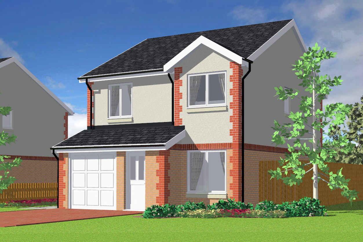

Hi All, First post so here goes...
The company I work for design residential properties so good quality renderings are a must for sales.
I find that the quality of your materials plays a great part in the final image, however try as I might I can't lose the cartoony feel. I tend to touch up the images in Photoshop before release which does help the image appearance.
Any feedback would be welcome.

As good as Revit is -- I don't think you can achieve what you are really after...when you see what others are doing with Strata, for example (see their gallery compared to the Revit). The problem I have - and I am new as well - is that Revit and Strata does not seem very compatible. I am playing around w/ a Revit 3ds Max combo...but have not figured out the nuances yet. Revit embeds textures I believe when tranfered to Max - and I have not figured out how to shed them quite yet. It is cool, however, because the Revit camera views are supported.

I'm sorry to butt in, but I think Revit is more than capable at creating high quality renderings. It's the same with any software, the end user needs to know how to use it to their advantage.
While accurender doesn't seem to work all that well, check out the accurender site and see for yourself what can be accomplished. and if not, max/viz puts it to almost perfection. revit has trouble with rounded surfaces being smooth, but if you know how to use max, then there should be no problems at all.

Strata does seem impressive but as I've never used it I can't really comment.
I've seen the accurender gallery and it can create some really good images. It's such a shame the the version in Revit is pared down to the bare minimum with extremely poor documentation. Almost all of the advanced controls which really help the final output have been removed. This is most noticable when rendering interior scenes which are at best horrible. I know that this is done for simplicity and ease of use but when you have reached the limits of it's capabilities you have nowhere to go apart from Max or Viz as Revit does not communicate very well with 3rd party apps.
One of the main problems is that people buy Revit as a one stop shop, expecting the same quality output as Max, but in really it's not the case. Autodesk could bundle viz with Revit, that would be a great solution and enhance Revit no end.
