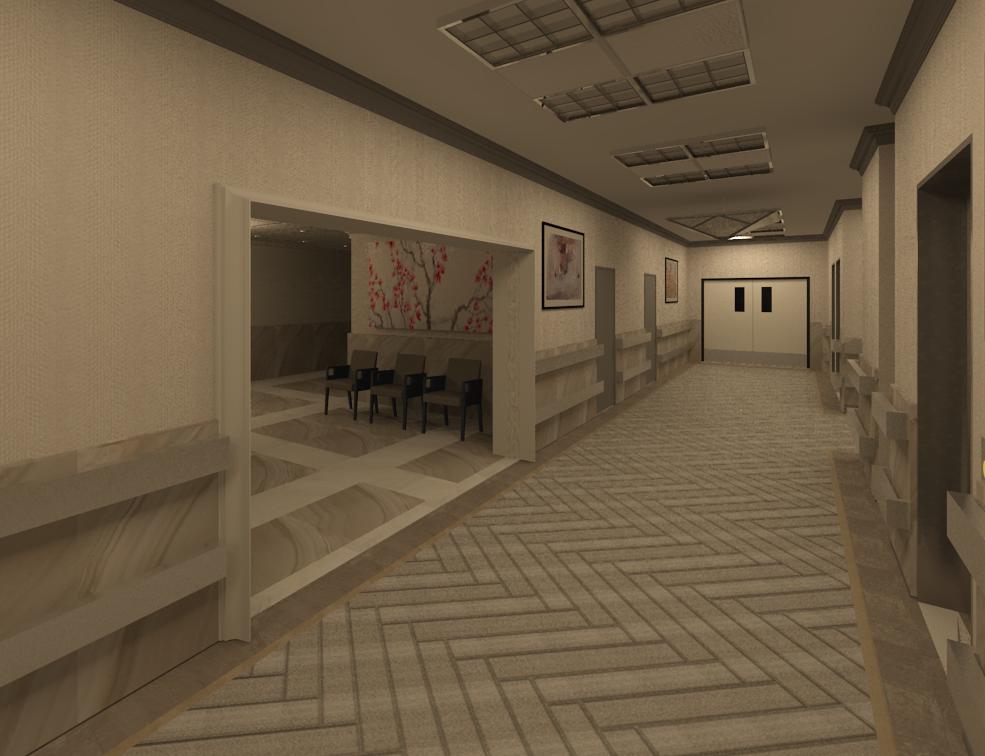

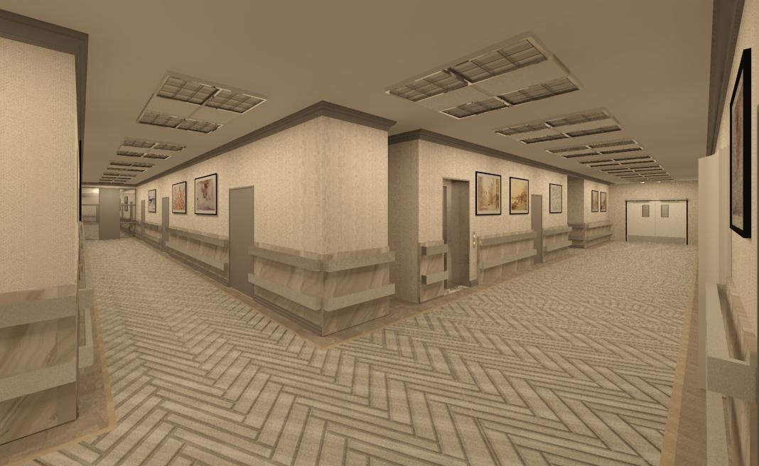

I'm trying to give my tile a texture look. I did this by creating a bump pattern in autocad and then layering on top of my floor.  The bump lines look so thick and heavy.  What am I doing wrong?
Attached is a picture of the floor tiles.

What is the correct way to set up this floor for rendering?  I would like to be able to see the herringbone pattern on my floor.  Without the bump that I stuck in there, all I see is a gray smooth floor. I can create the model hatch pattern, but there are no grout lines when I render.  I don't know how to define the shape of my tiles in realistic view when using the herringbone pattern.

Sorry.  That's what you are looking at in that picture.  It's a custom relief pattern.  But the lines are so heavy.  How do I make them thin?

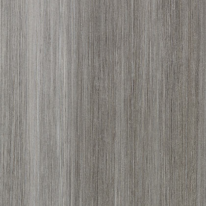

The picture that I used was a single tile.  I was trying to add the herringbone pattern so we could actually see the layout.  Without the relief pattern, it appeared like a smooth grey floor.
Attached is the tile that I used.  Is there another way to layout this tile and still get the pattern into the image?

You could try making the pattern in the tile image itself and have it cropped so that the edges align that way when it is repeated it looks correct

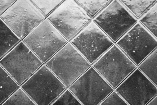

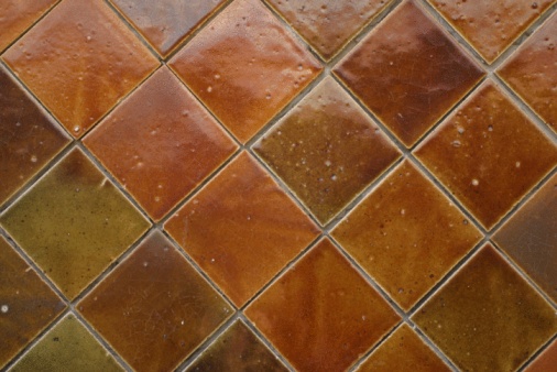

Interesting...so, your appearence image is not a tiled flooring pattern itself; instead, it's a single piece of tile, like a 12"x12" or 8"x8"? And, onto that image your're  overlaying the grout lines as a bump and/or relief image?  Is that right? I have never used this approach. I don't even know how that would work. The way I do it is to go online and Google for images of flooring tile. I pick an image that shows a section of 4 or more tiles grouted together. Also, I use the exact same image (including the image settings) for my material, bump and relief custom images

Here's an example of what I mean...same image; the grayscale for the bump...

You can do this for your tile you wojust need to put in some time and make the pattern as a single image that can be repeated. You would have to insert your image and place it and then insert again and place it and rotate it and so on an so forth and then you would need to make sure the top/bottom edges and left/right edges align with each other. Bartholomew's example image would not work very well as the if you repeated that image side by side the edges would not line up. so that any cut tiles come together to make full tiles.

Actually, the image works wonderfully. The image scale was adjusted inside Revit; essentially cropping it so it would tile seamlessly. Also, this is the tile's orientatation. It's a kitchen counter backsplash. BTW: the as-built home's backsplack looks remarkably similar to the renderings.
