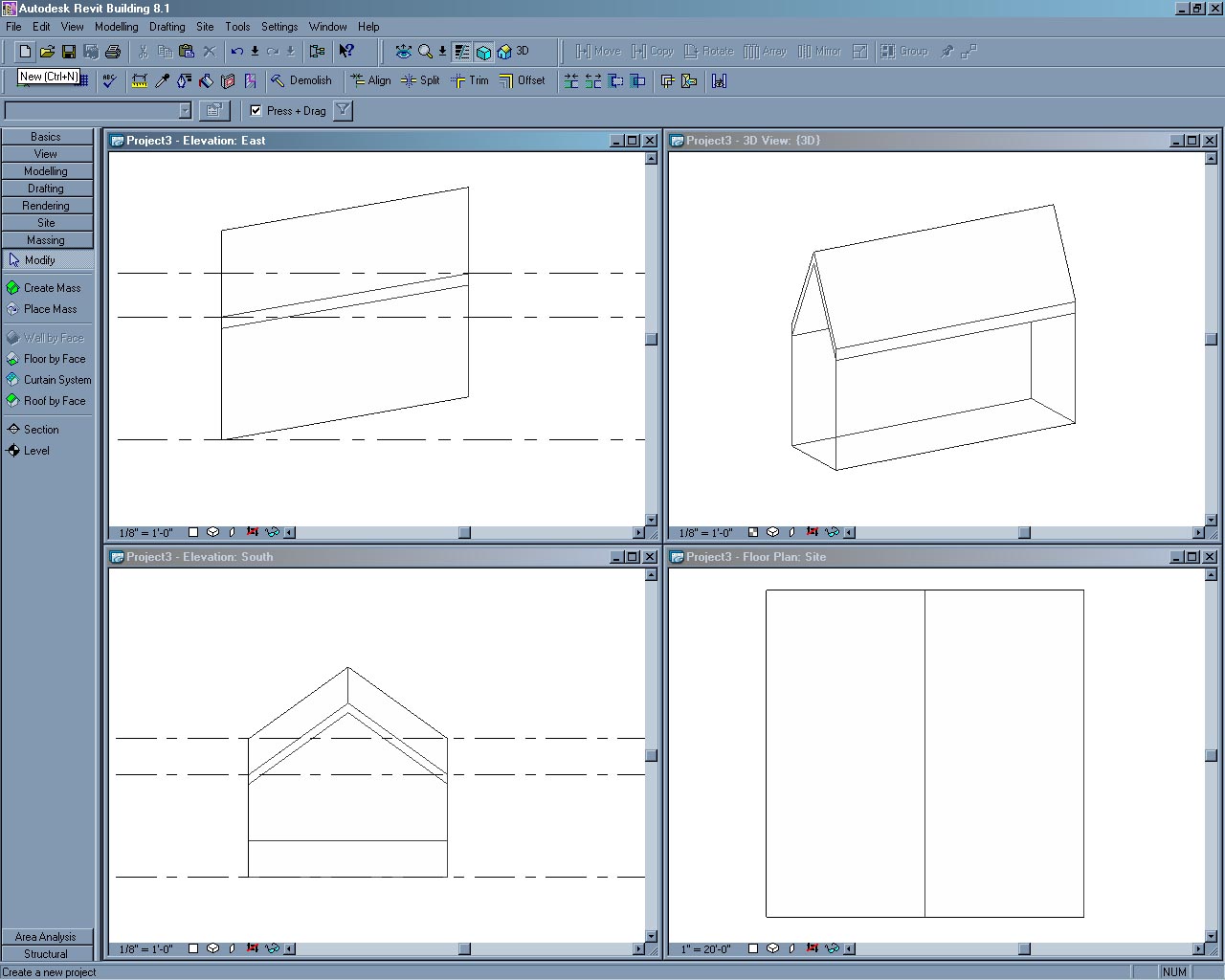

It seems like you could use the Roof by Face command in the massing menu -- use the Solid Blend command in Create Mass mode to model a mass that has the appropriate shape, thenwith the Roof by Face command, you'll just click on the top faces of your mass model, and a roof will appear. You can then manipulate the mass model if need be, and then if you select the roof, you'll get an option to Update, and the roof will then realign itself with the new shape of the mass. Hope this helps. -Erin

Seriously, Roof by Face is the answer. I just tried it out -- it took all of two minutes. It produced a gable roof with a sloping eave. Let me know if you want more detailed instructions for this process... I'll even let you keep your 800 pounds. Post edited on 2006-03-28 16:31:50

p.s. I don't see a sketch anywhere -- I assume I understand what you're asking for -- look at this jpeg and see if that's what you're after.

Thanks Erin This looks like what I am trying to do. However, I cannot figure roof by face out. When I click on roof by face I am unable to select any faces. I have dreated a box and assumed that face means a wall face. If you can let me have some instructions I would be very grateful Terry
