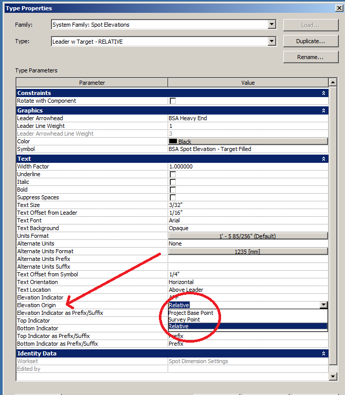

I suspect the topo was built in relation to the default first floor.  That may or may not relate to your first floor.
You can set point elevation tags to read relative to survey or to a reference level.  You should create both in your project and note them accordingly.
You should probably relocate the project and survey points and their numbers.  Watch this video to help you understand these.

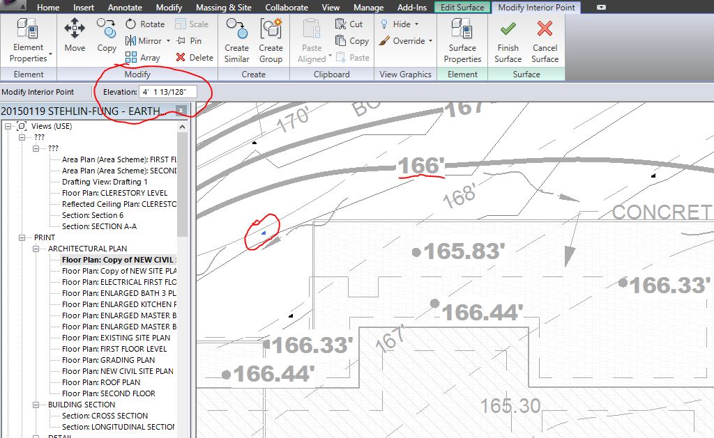

I watched that video before but it only talks about the differences between Survey point and Project Base point, but my problem is that I already have a topo surface that when I try to edit it, I click on each of its points and they display an elevation that is not relative to the Survey point nor to the Project base point but instead they are relative to a third 0.0 that I don't know where it is or how can I change it to match the real Survey Point.
Both my Survey point and Project Base point are set at -166' which is sea level, but then when I edit the topo surface, this one has points elevations that are in between -10'  - 0'  -  10', so they refer to some other reference.
I don't want to just display the right elevations with Spot coordinates on the topo, I want the topo to have real point elevations referring to the Survey point. I don't want to move all the model up, there should be a way to change that strange 0.0 wherever that is...

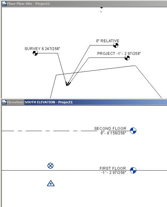

You are not reading our responses.   LOOK AT THIS IMAGE!
Show us an elevation that shows your level and your site!
In my second image, I have a site (flat) that was originally created at first floor which was then the 0 level PROJECT.   Then I moved the survey and project points.  I show all three possible spot elevations and as you can see, the site is at 0 RELATIVE

This is an image that I think it is self explanatory of the problem. I don't find any way to change the points elevation reference.

The points you are looking at on the site plan are all RELATIVE!!! to the level they were created from.
  1. Edit the site
  2. select a point and tag it with a survey base elevation tag.  (MUST BE SURVEY REFERENCE !!!!)
  3. Let's say it tags 10'  and you know it should be 2683.46' (SURVEY) ...
  4. goto the mysterious elevation you won't show us
  5. from the modify tab choose move then select the site
  6. now move the site up 2683.46' minus 10' !!!!
When you try to edit the site again, the points will still be strange numbers to you because they are still RELATIVE to that original reference but ALL elevation tags (SURVEY, PROJECT, RELATIVE) will be correct based on your survey and project locations.
