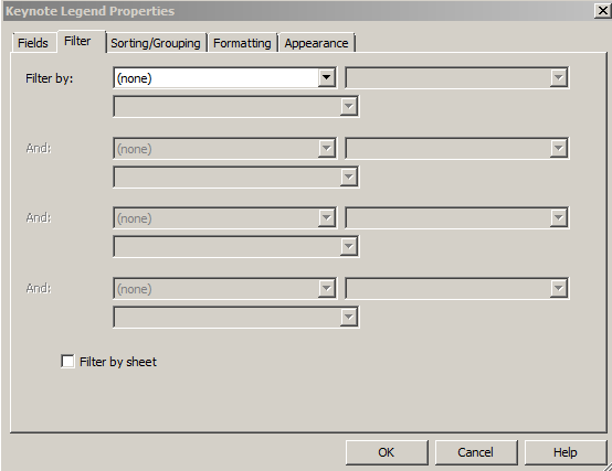

OK.... I think your problem is that you don't understand keynote legends.   There are several settings that affect this.
  1. When you set up your legend, what did you set your legend filter to be?  first image
  2. How did you set up your keynotes?  By sheet or by project and do you have the path set right?  second image
If your answer to #1 above is filter by sheet, then a copy of the legend must be on the sheet.
If not by sheet then the legend will populate when each keynote is used.
You must have the path set to see any keynotes.

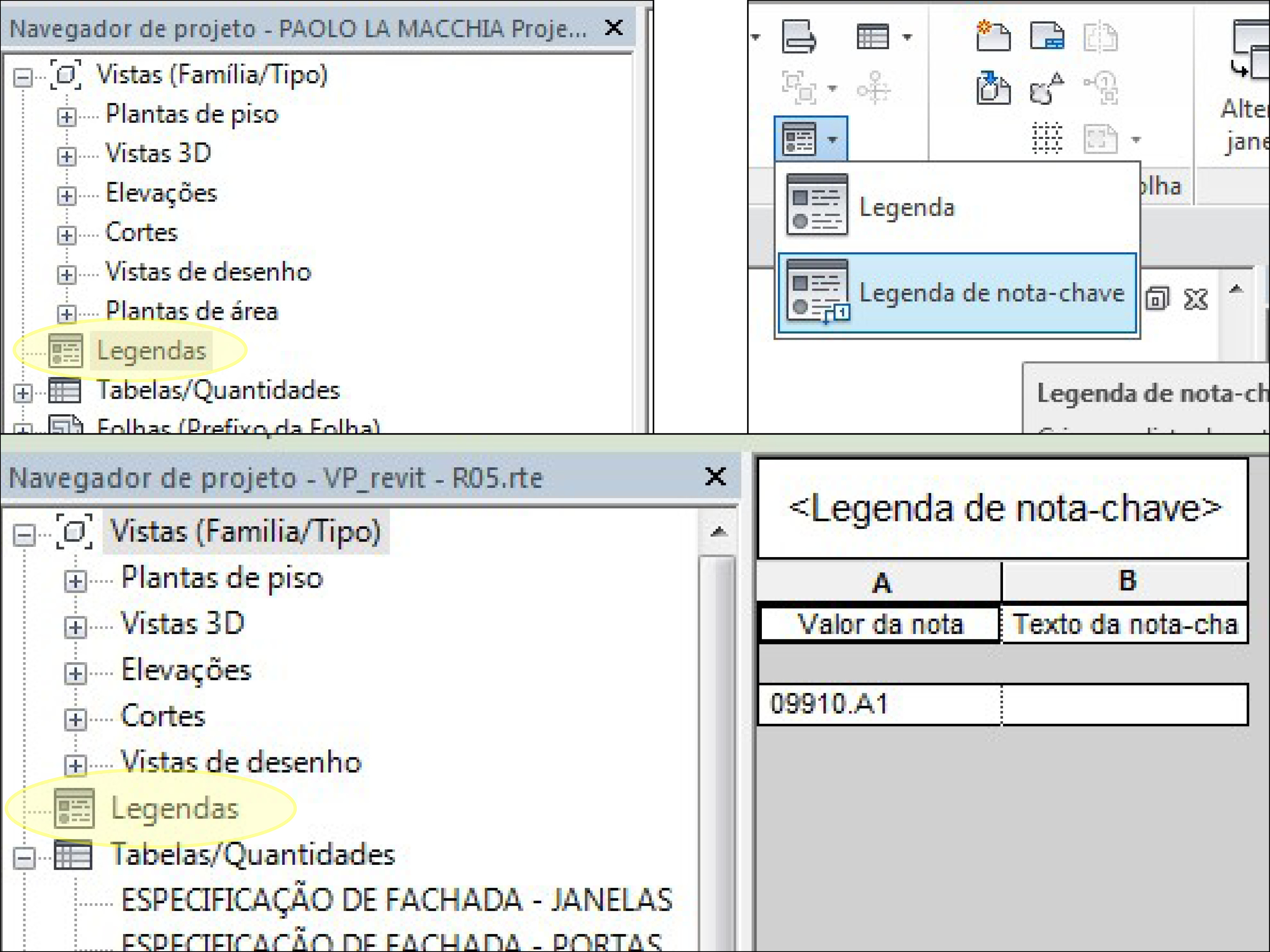

Tue, May 13, 2014 at 1:59:30 PM | Legend not showing in Project Browser
Dauster
Joined: Mon, Mar 28, 2011
0 Posts
No, that's not the problem. The functionality of the legend is fine. The Bug is that it won't show on the Project Browser, and therefore, it only exists while it's window is open.
See the image atached. My Revit is in Portuguese, so: Legenda = Legend; Legenda de Nota Chave = Key Note Legend
In the top left box I have the project browser with no legend created. Then I create it on the top righ box. I the bottom box I have the Key Note Legend created and populated (I've only placed I key note just to show), but if you the Project Browser, the Legend header is still there, but no instances of the legend family where created.
So, when I close this view, It will no longer exist. Know what I mean?

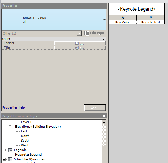

Tue, May 13, 2014 at 3:10:18 PM | Legend not showing in Project Browser
#10
My 2014 - update 2 - new project using the commercial template.  And here is my browser showing the new keynote legend I just created.
Something has to be bad in your program.
