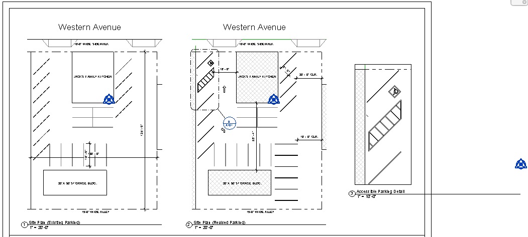

I created a site plan and hatched the adjacent buildings with the region command.  I created a copy of the drawing with dependents (not sure what the options were or meant) but now  the regions are on the copy (new site plan with revised poarking lot striping) but are not visible on the orginal site plan.  What's worse is that I can't draw a region on the original site plan or select it to figure out the properties.

Here's a photo of what I'm dealing with.  Also why does the title line for parking detail stretching off the sheet?
Tue, Feb 25, 2014 at 10:06:32 AM | Problem with Reigion Hatching on Site Plan
You don't understand what dependent plans are.  That process is best used with split (match-line) needs.  It allows for one main views with partial views cut from that main view.  If you change or add an annotation in any view it is changed in all views that show it.
You should have initially copied with detailing.  That allows you to copy all annotations but they are now independednt and can be modified.
You can read about dependent views in your HELP.

So without starting over, should I create a copy with detailing of the new site plan and work backwards to create the original plan?  Also, If I cropped the view of the accessible parking detail, why is it so big when I insert it on to the sheet?
Tue, Feb 25, 2014 at 10:42:42 AM | Problem with Reigion Hatching on Site Plan
View scale is not independent in dependent views.
Just copy your original view with detailing to get a clean independent view.  Anything you added will still be there.   Then you can change this view scale as needed and delete that dependent view.

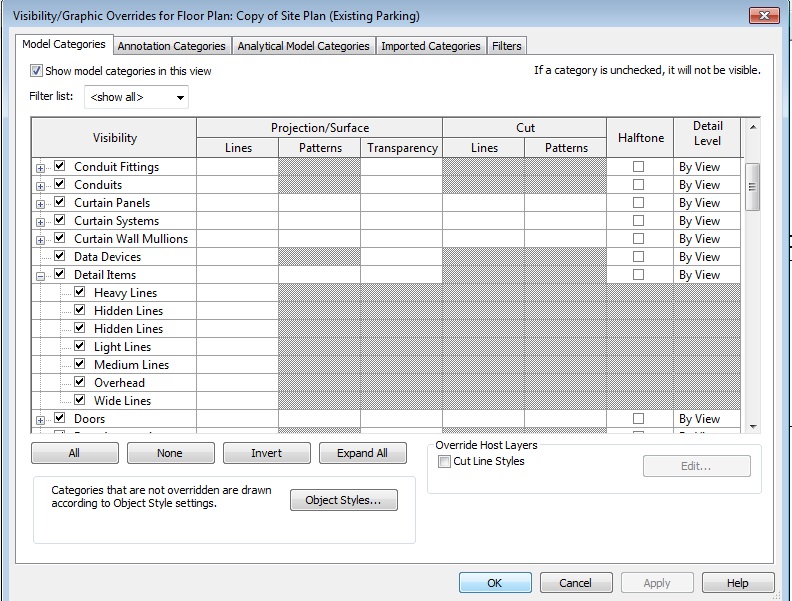

What is the filled region you are trying to create?  Show us a screen shot of the properties.
Tue, Feb 25, 2014 at 12:42:16 PM | Problem with Reigion Hatching on Site Plan
#13
Again, you don't tell us anything.  Do you start the process?  What happens?  Do you get what I have attached?  If so then do what I told you.... TURN ON LINES ... not just the lines under detail elements!

That doesn't answer my question. Theres multiple things it could be..
-if the scale of the view is too large the filled region may show white as if it’s too dense
- try creating a View Template from a view which you can apply a filled region correctly and applying it to the view thats not working
-Try turning hardware acceleration off
-Upgrading your graphics card
-do you have all of the updates installed
