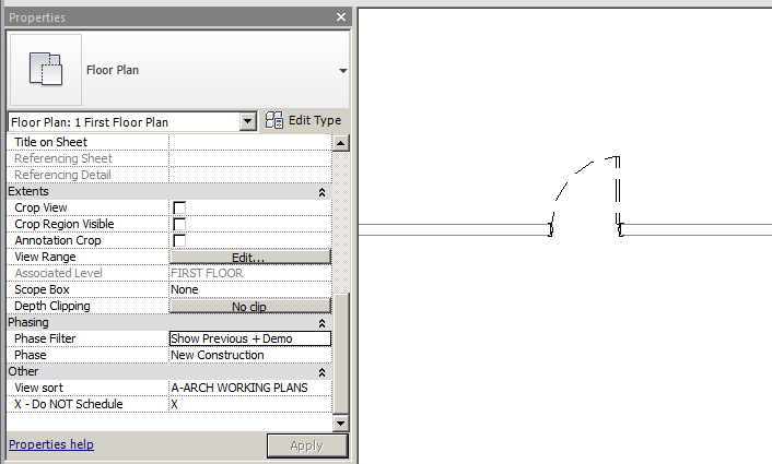

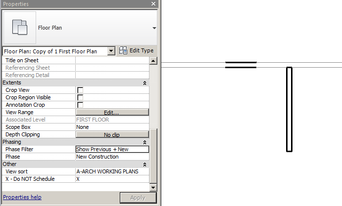

Thu, Feb 6, 2014 at 7:18:45 AM | DUMMY ROOM TAG
Take a look -
  • Light Wall and door - exist
  • Door demoed in new
  • New wall dark

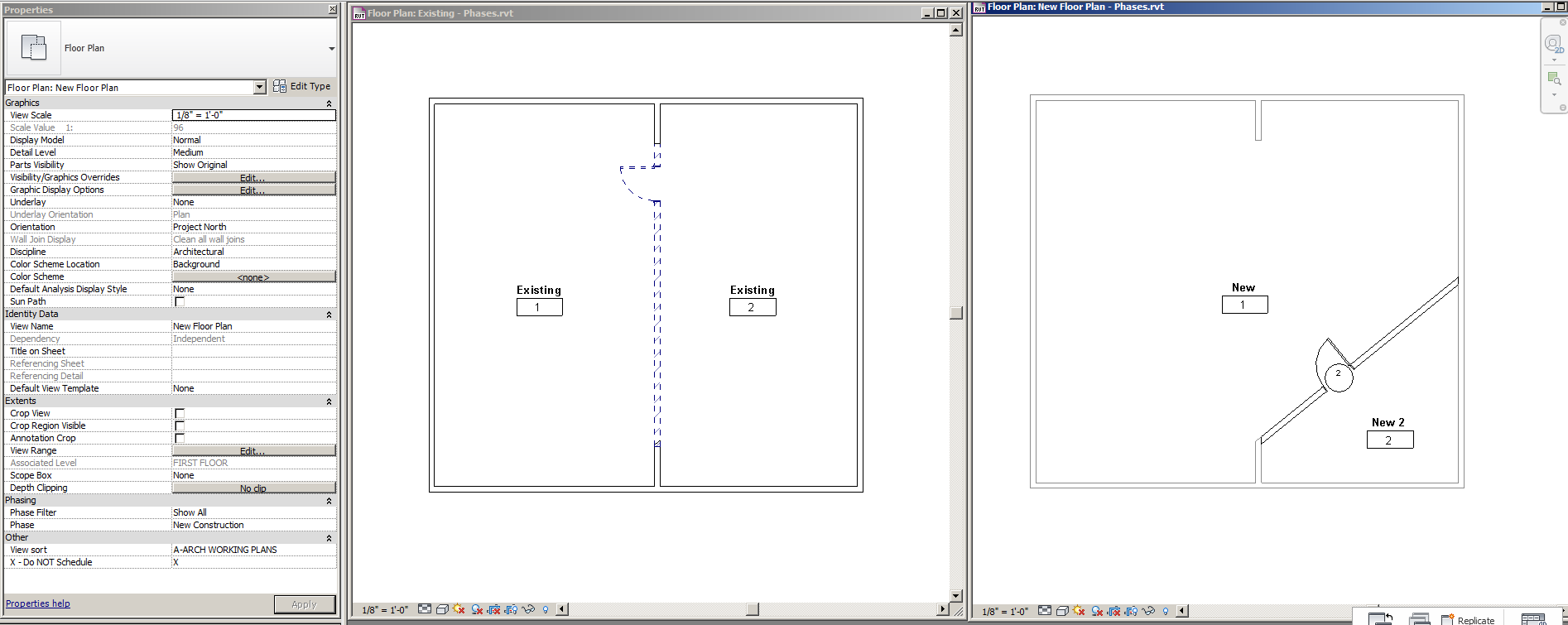

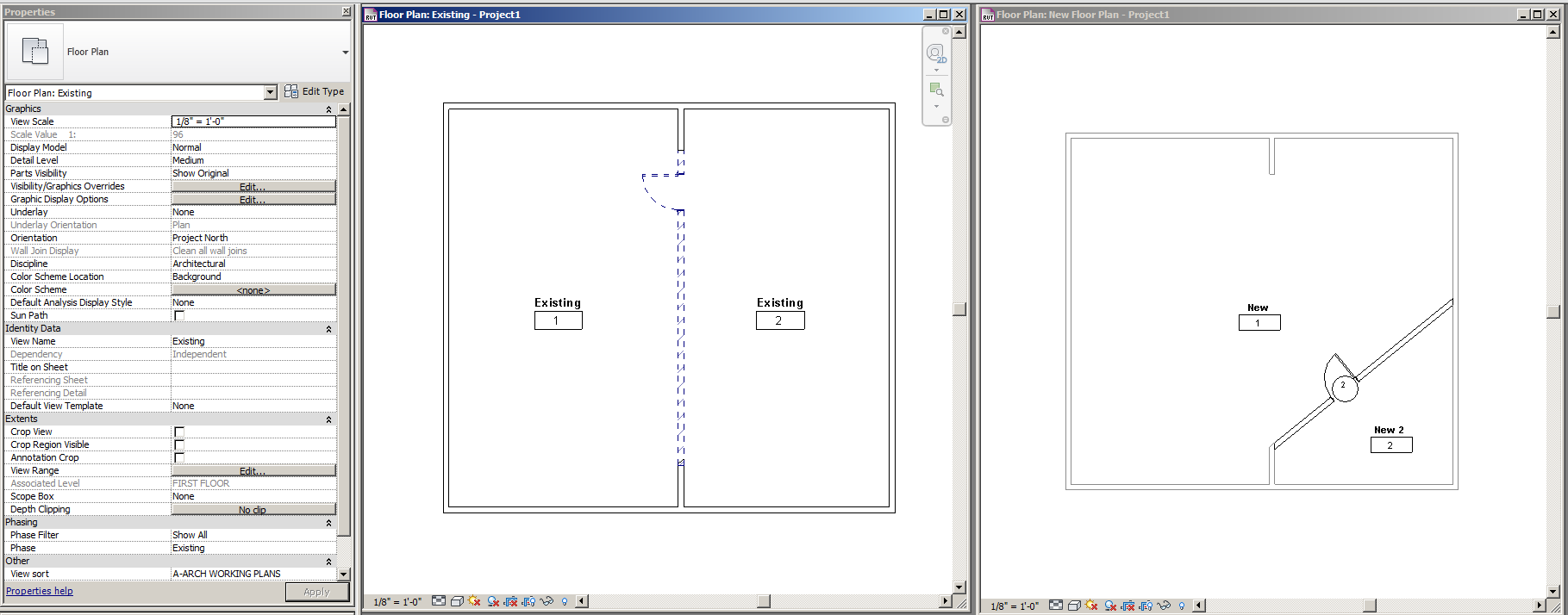

Thu, Feb 6, 2014 at 1:02:17 PM | DUMMY ROOM TAG
#12
I did exactly as you asked.
  1. The plan view on the left has all existing components including rooms in the existing phase.  Note that the phase of the view is set to existing and the phase filter is set to show all.  Since new is not there in the existing phase, nothing new will show.
  2. For the plan view on the right (tiled view), I could not show the view settings at the same time as the existing so here that is.  This view shows existing items that remained, new items and new rooms.   Setting is new phase filter show all.
NO DUMMY TAGS NEEDED - NO SPECIAL PHASES!

Fri, Feb 7, 2014 at 9:25:50 AM | DUMMY ROOM TAG
#15
The original poster in this thread does not seem to read the answers given.
  • He wrote in his 2/5 post "[If I Set my Demo Phase to "Existing with show Existing + Demo"  = I get nothing (because if you demo existing walls they can not show up in an existing plan) so that doesn't work.]"  So I responded on 2/6 and showed that this was wrong, he was just using the wrong settings.
  • He then wrote in response to that "Your image sample woudl be great for question of thread about  demolishing doors."   Obviously he couldn't make a connection between doors and walls ... that the process is the same.
  • Then he wrote "I don't have time to educate you  on creating  demo plans that show existing room tags. You could try to do a demo plan as i mentioned yourself if your interested.  Anyway, I found my answer on other forums using a work around." So I responded and showed that he did not need a work around.  He obviously did not read or look at my answer because he wrote "Try creating a demo plan using the exiting room tags without making an entirely new 'phase' with a new set of rooms.  You cannot demo rooms so you need a work around, just saying."
So, for future readers of this post, please read the questions and answers.  Phases are hard for new users to understand.  The poster said he has been using Revit since 2004 yet he still has problems.
Architecturally, we think of demo as a phase but in Revit, it is a process done in another phase.  That phase is your choice.  Typically, we like to demo in the new phase but in this instance, setting the demo of the walls to existing allows the room tags to show.  If you are not sure about the process, do some tests where you try out all the settings.  Always remember that there are two settings for every view.  What phase the view is and what phase filter is applied.  A view in existing phase will not show anything if the view is set to previous.
