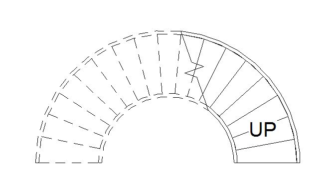

Mine are parallel.  If that's not what you mean then be more descriptive.

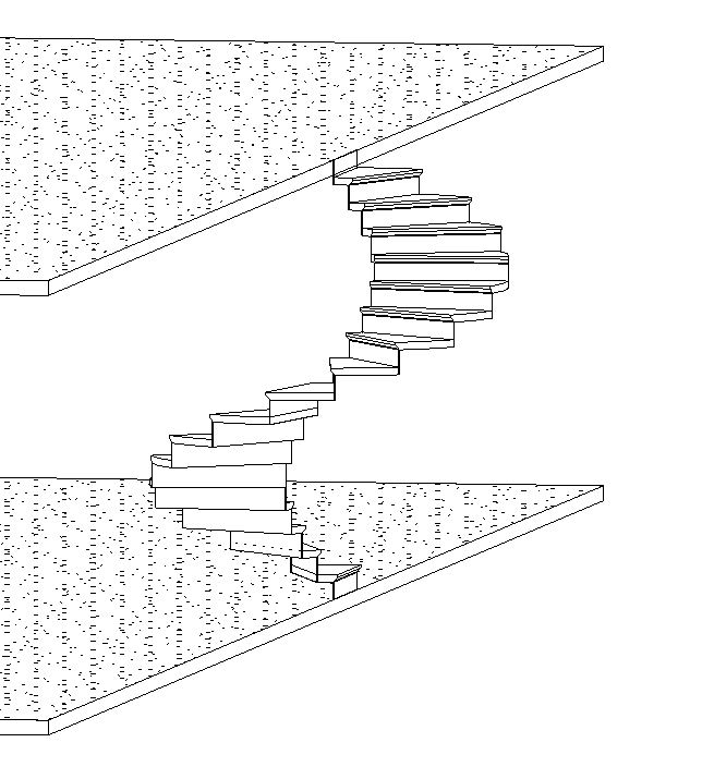

doesnt look parrallel...looks like the top tread/riser is at an angle

Mine are parallel but I sketched mine.

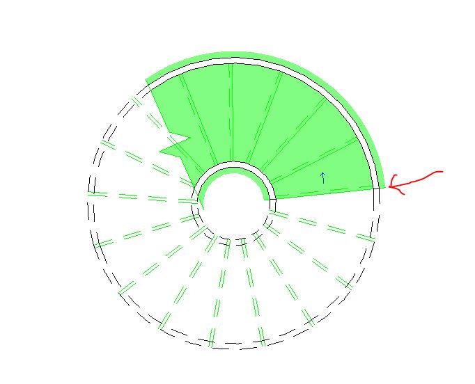

Right and you can sketch it so long as you are not rotating 360 degrees but you cannot create a spiral that rotates 360 and ends with the starting riser parrallel to the final riser without being able to adjust the tread depth
Wed, Feb 19, 2014 at 7:32:39 AM | Spiral Stair I Need to start at 90 degrees and end at 90 degrees
Finally you tell us something, you want a full 360 degree stair.  That would have been beneficial from the beginning.  That begin 90 degrees and end 90 degrees has no bearing at all.
Just do your stair in two sections.

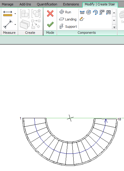

I'm not seeing the problem?  Here is a 360 that starts at 90 and ends at do to eachother (rotated on screen a bit due to doing it fast).  This is done with stair by component.  Or as WWHub said do it in 2 sections.

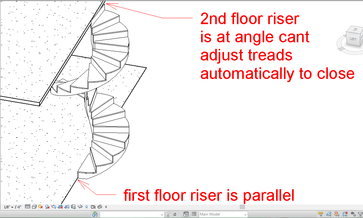

maybe this image will help.

well WWHUB it cant be done either way whether its 90 or 360 stair by component

I just did it with stair by component, 10' floor to floor height... I'm still not seeing why you are having a problem.  It can be done as I did it or as WWHub said in 2 pieces, you just need to watch your radius size.

I see what you are saying tafoe.  If i needed a specific radius then its not possible without adjusting the tread depth

Correct
