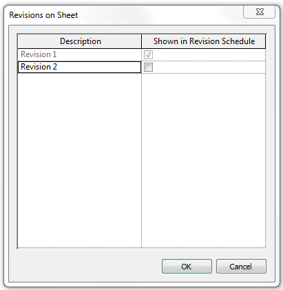

One of my users asked me why the revisions aren't showing up in the revision schedule in the title block of a project made with our new 2014 template. After much searching I discovered that the Revisions on Sheet dialog box in our template is broken. The problem is that I have no idea how to fix it. The attached images show how it is supposed to work (right.png) and what we're getting (wrong.png).The title block is just about the only thing I didn't make from scratch when making the new template but I don't think it's an issue with the family because if I insert it into the default Architectural template it works fine. What the heck is going on here?

The problem is not with having or not having a revision cloud on the sheet. The purpose of this dialog box is to populate the revision schedule on the title block when there is no cloud on the sheet. When you go to the sheet properties and select the Edit... button by the Revisions on Sheet parameter it is supposed to pull up the dialog box with the check boxes. In my new template this dialog box is not showing the check boxes. So there is some error somewhere that has fouled up this parameter resulting in a broken dialog box and a revision schedule that will not populate.

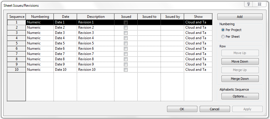

From your project, please post an image of the sheet issues/revisions that I pointed you to.

Not that it will make a difference but here you go. As you can see this dialog box works fine. I can add revisions to my heart's content but they will not show up on the title block. By the way, you can reach this dialog box directly from the View tab on the ribbon. It's in the Sheet Composition section with the button labeled "Revisions".
Wed, Nov 13, 2013 at 2:50:53 PM | 2014 - Revisions on Sheet dialog box is broken
NOTE: Your numbering is by project!  If you want the sheet function to work, you have to set that to by sheet.

Ask and you shall receive. I hope you enjoy the slide show and that this clarifies the issue.

I apologize.  We started using Revit a long time ago.  I do not know when this function was added but I missed it.  We only use revisions by project.  When I checked it out yesterday, it would only work when I set my revisions to by sheet.  I checked it both ways and that was the only way it worked.
Reading your post, I tried it again today with a new project and it works as you say it should.  I then wondered if I had checked this on an upgraded project to see if that is why it did not work yesterday.... but it worked on that project as well.
Looking at your last image, try the following.
  1. Bring in the default autodesk sheet and see if it works there.  If so, then your sheet family may be corrupted.
  2. Does this function work on other systems.  If yes, then your program is corrupted.
  3. Starting a new project with your sheet, does it work?  Yes - then your project is corrupted.  Send to Autodesk or goto a backup.
Again - Sorry and thanks for teaching me something new.
