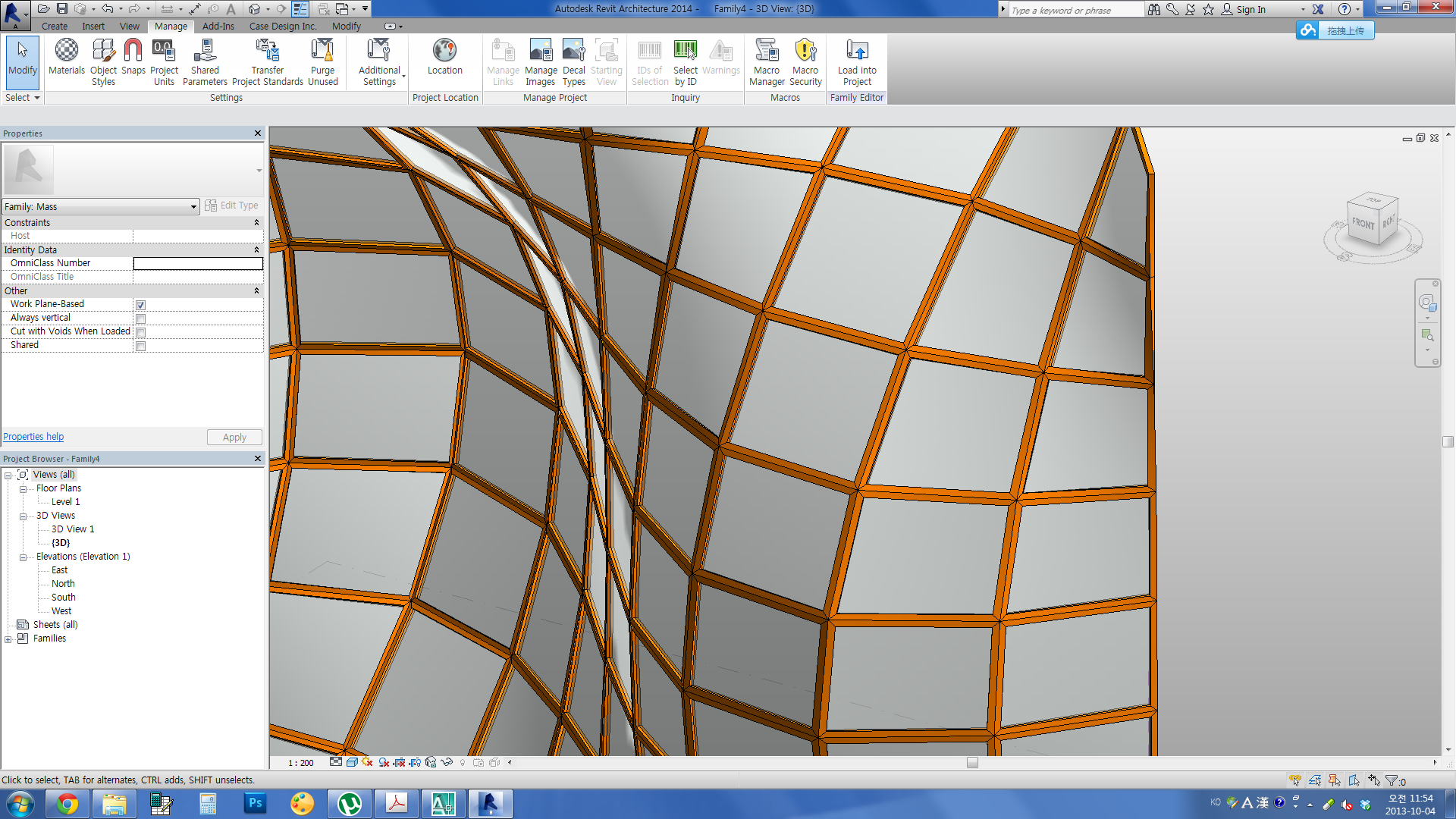

I have to model curtainwall that is double curve in plan and curved in vertical section, as the floor goes up the width is getting bigger, looks like trapezoid in elevation. I used massing but then the connection between mullion to mullion and mullion to transom was very ugly.  I try also using adaptive type but the glass goes in and out when I placed them in the project, and the mullion to mullion connection is bad also.  Can someone help me on this? Many Thanks,

Can you also please kindly check what is wrong with this adaptive component i make? because when I try to plot in my massing sometimes the profile was flipped back or sometimes the glass goes the outside..  Thank you very much. I need help very badly..

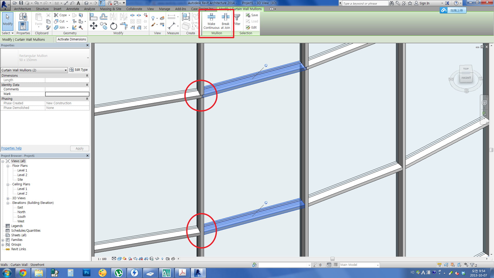

3. have you tried with mullion joiin type? see attached image.

1) my system is unitized so it needs to be modelled per module, same the way it was deliver and installed in site. Each trapezoid shape on conceptual mass attached are my panel shape.
2) Here I attached the actual part of building conceptual massing. it was double curve in plan and also curved on vertical section. none of the adjacent panels are the same and the shape of each panel is trapeziod.
3) Mullion joint not applicable.

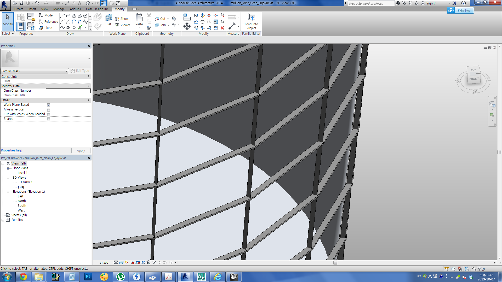

check attached file. I'm not sure but i think this should be what you want.
hope you can find a clue from attached file.

As I looked in your sample, it was not as per module as i want it to be?
Can you please kindly apply this panel in my attached mass previously?

i just saw your profiles... I think my last reply will score, Or seprate profiles left/right, top/bottom and make a border with them at pattern family.
but for fig4 from your pdf (gap between border mullion),you have to anoter custom pattern or adaptive family to make it fit.
