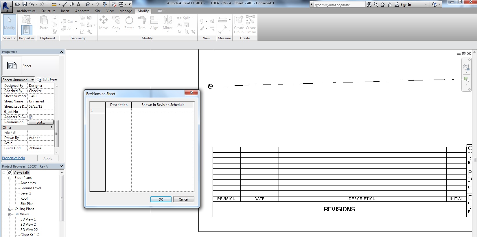

Using Revit LT 2014......setting up a custom title block.....adding all appropriate bits.....going ok......load into project.....start laying out sheet and adding project info.....going ok.....go to activate the revisions info.....then i get this (see attached - no check boxes available in Revisions on Sheet box)....therefore cant check them to get info to show......details are in Sheet Issues/Revisions. Have i got something wrong in here or have i missed something in the making of the revisions schedule in the custom titleblock....or is Revit just getting funky on me? Help. Thanks.
Wed, Sep 25, 2013 at 7:59:38 AM | revisions display issue
Since we don't know if you built your titleblock correctly, I don't think we can answer you.
Did you add a revision on the sheet?  Did you fill in the data for the revision under the manage tab?

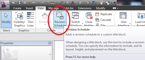

Im not sure how you got to this dialogue box. But a revision schedule is created easily enough in your titleblock family by clicking "Revision Schedule" under the insert tab.
Then add your revisions within the project environment.

i'm not sure how i got this dialouge box either. i've been using revit since 2009 and have made custom title blocks on mulitiple occasions as per the ways and means Revit allows one to do so. I've added a revision on the sheet and filled in the data for the revision under the manage tab in this instance, and thought I'd gone about it all the same as all the other occasions where it all worked fine.
I just droped an existing revit titleblock template into a fresh project to check it out and the same dialouge box comes up, unable to check revisions on or off (see attached). this is the first time i've been using an LT product but it should still work the same way as regular Revit right? is it something to do with my instalation of Revit LT 2014? is it the file itself? i don't have another Revit to check it on. Is this one for the good people of Autodesk?
This dialouge box is a mystery.

Righto,
After an uninstal & reinstal and service pack download, some further investigation and some input from the good people at autodesk and reseller CADgroup, I have come to know this.....
For starters, there were no family libraries or templates loaded up as part of the original software install (either download from web or instal from media)....which was none to handy.
Anywho....overcame that by getting an upload from CADgroup that contained all that data. Giddy-up, back in the game.
Next, no one at autodesk or CADgroup could explain the mystery revisions check box issue. So I open up a new drawing with a newly aquired template & families and load in the custom title block I made....it works fine. the original file with the 1st project I created still has the problem but it seems that all future projects will be functioning ok.
And then with the corrupt file caper, both autodesk and CADgroup were stumped by that one too, but I came across some other punters out there having some difficulties in this area. apparently there is a workaround to get around such a calamity...click the link to know more...
