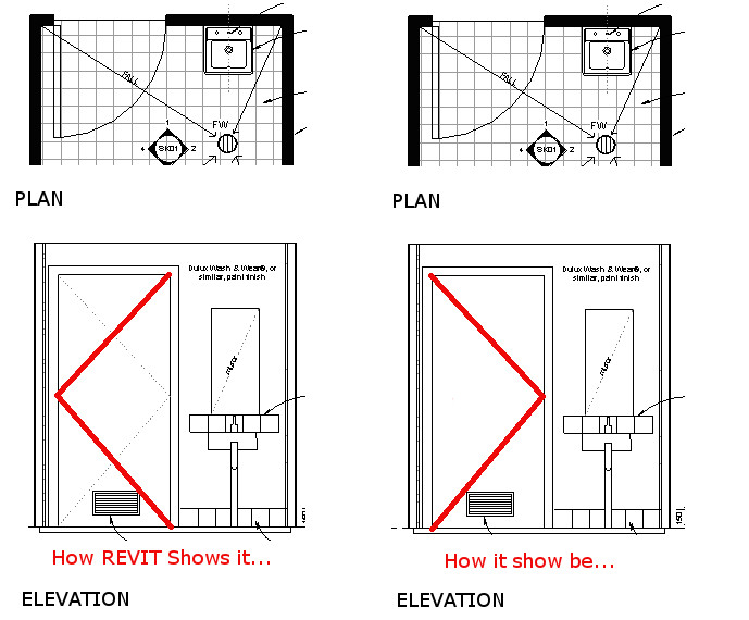

I just noticed that the standard REVIT Single Flush Door elevation swing lines are incorrect, refer to picture...Normally, the point of the arrow is where the door handle is...and the two ends of the arrow is where the hinges are - well in Australia at least.
Is there a way to overight the REVIT family WITHOUT doing a save-as? So that each time i start a new project the standard door type is correct?
In the end i just turned off the Door Swing lines through Visual Graphics....but it's annoying that the Standard REVIT door shows the wrong swing path.

Really?? the path on the left is correct in Korea..(also in US I suppose)
If it's not in AUS (though it's hard to believe), the file you have to fix is not only the door family file but also the project template file. Basic general families are already loaded in project template that you choose when you start the new project.
Reload the door file you fixed to the template you want to use, and overwrite the template file. Problem solved. :-)

Hmmm yeah, i was trying to avoid that way. Mainly because I will have to update the templates on everyone's C Drive.
Also, speaking to my German friend...he uses the same method as us. Must vary from country to country *shrugs*

WOW! after so much years, i just noticed. Infact I had assumed that the meeting points of the lines where the hinges are. Totally didnt think it could be the handles. Anyways, I just confirmed now, after an arguement with my collegue on the swing direction.
Its easy to correct, just edit the family.
Thu, Apr 9, 2015 at 8:53:46 AM | REVIT 2014: Door Elevations - swing lines are shown backwards?
In the US, the standard has always been like Revit shows it.  The 'arrow' points to the hinge side.

Things might be different in Australia, but in the US, the "arrow" indicates the hinge side of the door.

AUS/NZ 1100 standard states door knob is where lines meet.
Found a info that they've changed to other (normal) way in 2008, but it created confusion so they changed it back in 2011.

I've seen some drawings where they actually join the swing lines at the height of the door knob as well. So it doesn't just meet in the centre as the AUS/NZ 1100 states.

I agree with WWHub - been working in industry in three different regions of US since 1999 and always drew the swing lines as Revit does - arrow toward hinge side, and the lines open toward the opening side <> makes since to me.  I've never been corrected on this, and do not plan to change.
I found this thread after a search because I recently got shop drawings showing the wrong way >< (as pennyiscute prefers) and proceeded to correct their drawings with the correct swing indication <>  Smile

Revit draws it the way Americans signify the operability/hinge. A double door is drawn like this <>, and not like this ><. It was explained to me that the arrow points toward the hinge/pivot, also drawn that way in plan, meaning the point of the arrow symbolizes the pivot in plan. However in Denmark and in Portugal they draw it the other way, and it was explained to me that the arrow points to where the door is floating, thus the two arms of the arrow are holding up the door, just like the hinge does. They both make sense, I wonder where the divergence occured.
