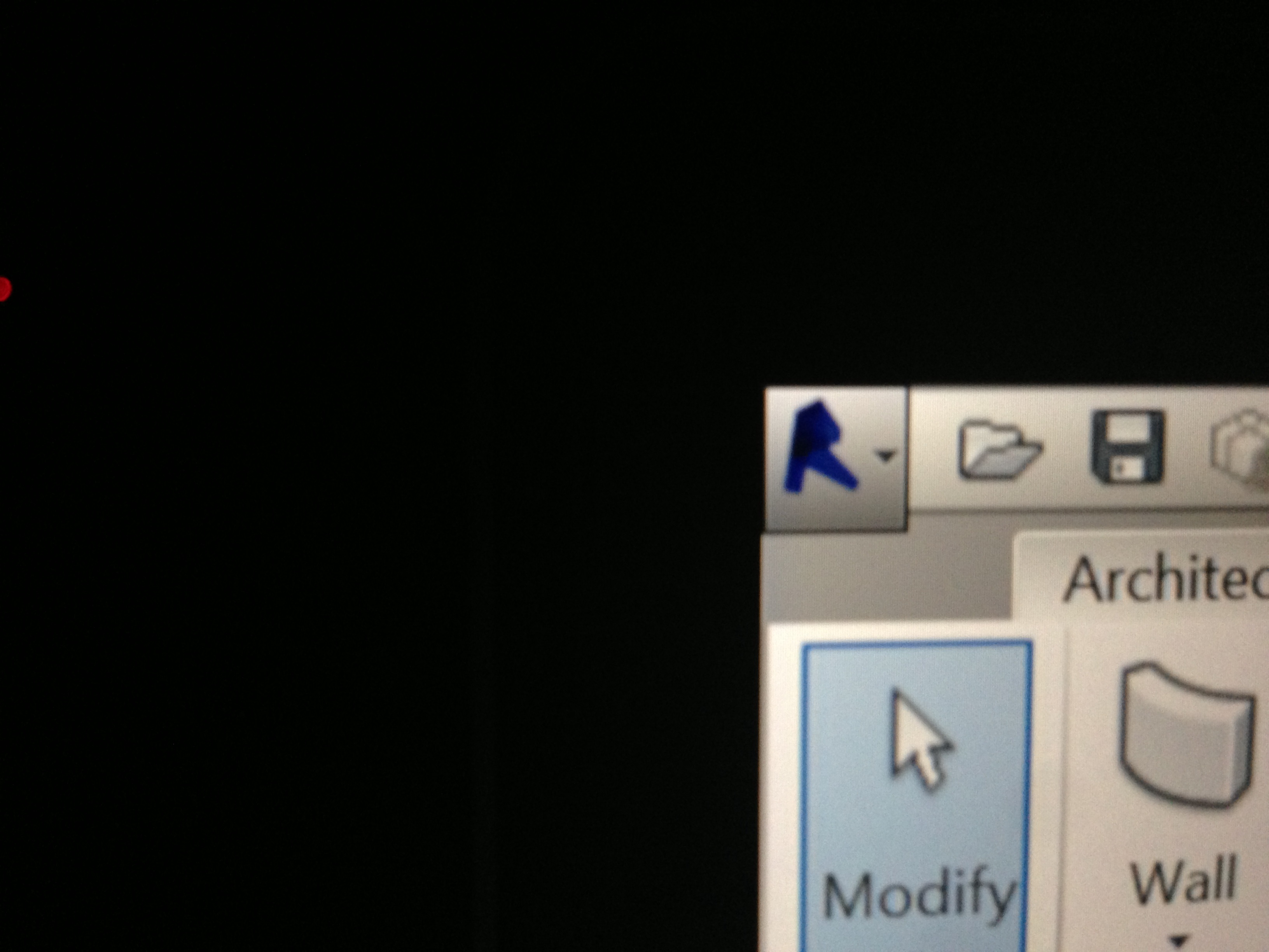

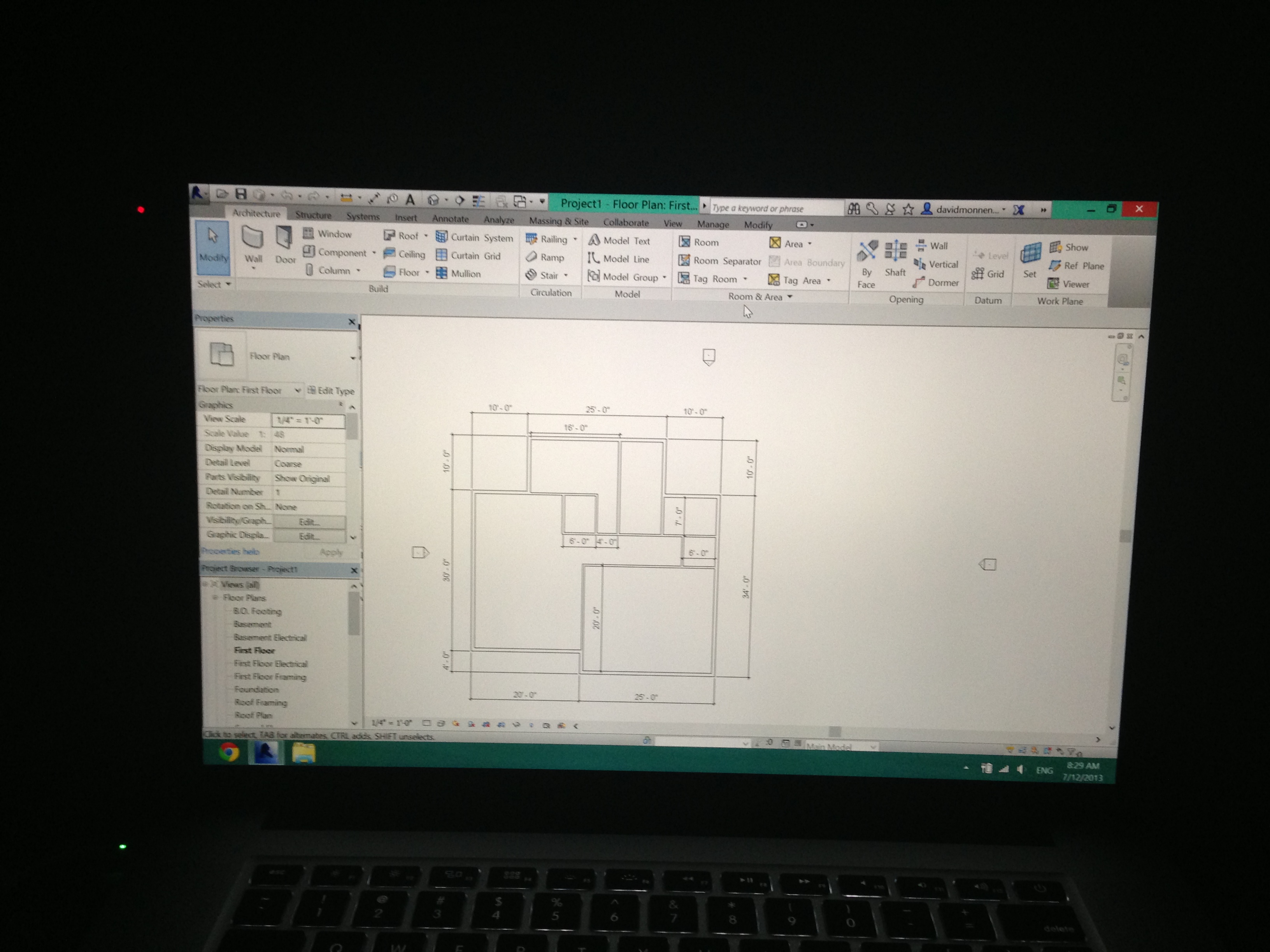

I have installed this on my MacBook Pro. There are a few issues with using the retina display compared to non retina macs. Revit 2011 2012 2013 (from what I've heard) has very annoying graphic glitching. It's useable. But it's annoying. I had 2011 installed and it had lots of glitching. I searched around a bit and found that in revit 2014 those issues are gone. So I installed it and that is true. No graphic glitching and I've used it quiet a bit. There's a few more minor issues. A few items are smaller. Such as R (file menu) icon is smaller. And things in the lower menu bar where there are those icons like the detail of the plan. Colors. Teapot for rendering. Light bulb. Those icons are smaller. But you can still see them. Windows itself sets the display at 2880x1800 which is quiet hard to read fine text. But you can always adjust that. Overall I am happy with the performance with rendering. Now that's not saying much. I used crappy windows computers at school and then a 2009 iMac with 4 gbs of ram. But this handles rendering well. I am happy with it. But if you have the money I would upgrade the ram to 16 gbs that would help performance as well. Let me know if you have any other questions. I'll post a few screen shots tomorrow to show you what I mean.

now second I'm not quiet sure what you asking. But let me tell you what I think your looking for. Your saying if you lower the screen resolution the smaller icons will be bigger again? The answer to that is no. There still smaller then normal. I think it's something to do with the retina display. I took a few pictures to show you some of the problems and what it looks like at different resolutions.

Yes, you perfectly understood what I meant... So the problem is still there at lower resolutions. Anyway, if it is only to have smaller icons, it is really not a problem !
