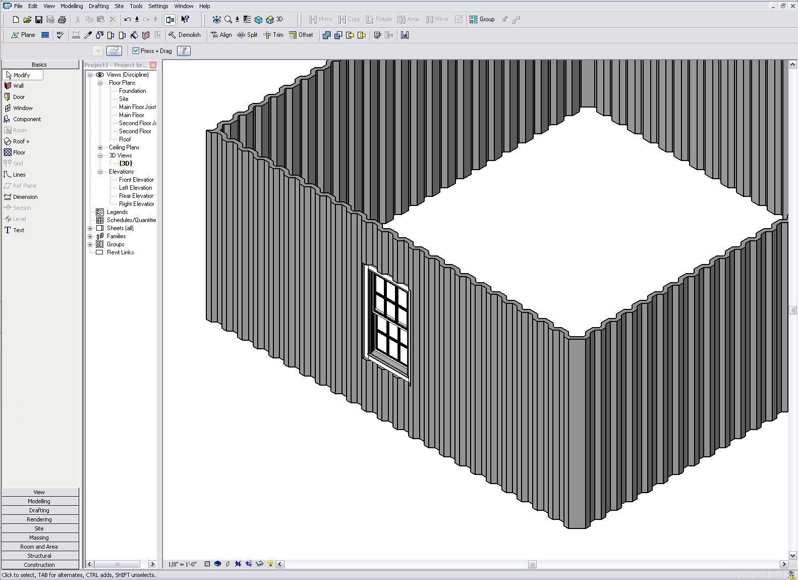

How I got to this test model is "create" under the modeling tab. when you select this, it asks you what category you want. select "wall" so now you are making an "in-place family" of a wall. create your profile using array, copy, whatever methods to spped this up. It didn't take me too long, but I don't know how big these are that you need. I offset these so I got an actual wall thickness instead of a huge block of mass.
after you create this wall, you may place doors, windows, whatever is necessary. However, since it is corrugated, I had to go back and edit the wall and create some voids to clean up the window opening. It would cut some, but not all of the wall. Revit will see each little leg and assume it's a different wall. Voids are not too hard, so I went with this route.

Thank you, this looks like a good approach I will give it a run and let you know how it works for us. Revit does seem a little weak in the mechanical design and detail area but maybe they will improve as they find out what peoples needs are and like autocad incorporate the ideas and work arounds created by the people actually using the software.
