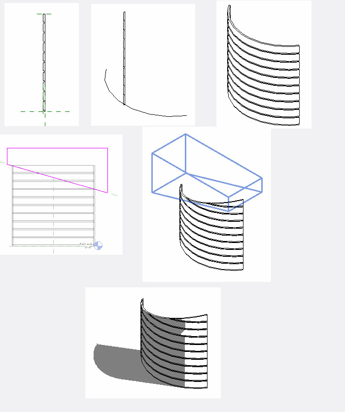

A different workflow:
In a generic model adaptive template, draw an arc in plan, and create a form. Divide the form. Go to a pattern-based curtain panel template, and create a panel that represents the wood, with the reveal. Load this panel into the other family, and apply it on the divided surface. Now, make a void that cuts the divided surface with panels.

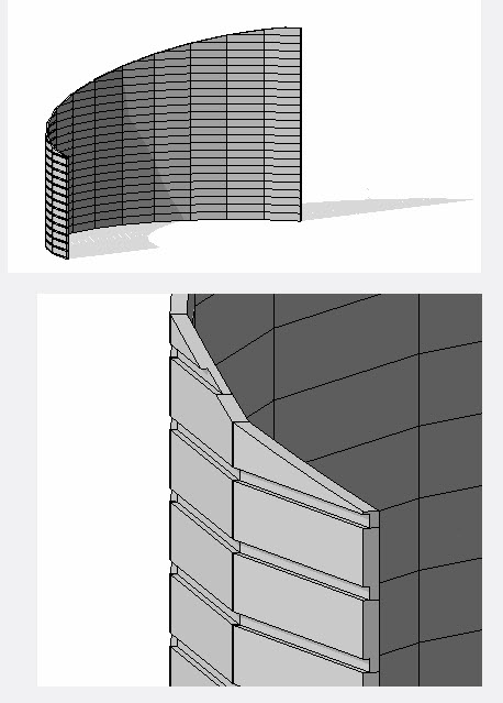

Thanks for your reply,
I tried out your suggestion but the void would not cut the completed surface with the pattern-based curtain panels in place. I then created the arc form again but this time cut the Void first and then added the surface divisions and panels but the panels were removed to give a stepped effect rather than cut by the Void object. It appears that unless there is space for a full panel they are ommited.
I have to achieve a curved surface rather than faceted so although an interesting method particularly if I get the panels to cut won't suffice for this project. I have attached the file and would appreciate if you can advise how you got the Void to cut the panels.

Yes, with the divided surface, the result will be a wall that is not really curved, but in segments. If the wall needs to be curved, this can be achieved by much simpler means. A profile, a sweep with that profile in a generic family, and a void :

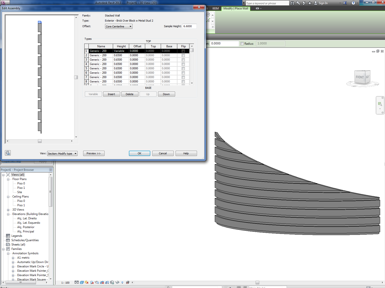

Sat, Jan 5, 2013 at 5:31:06 AM | Cut Adaptive Components
Joined: Tue, May 22, 2007
5921 Posts
4 Stars: 205 Votes
No need of sweep, create a "Stacked Wall" then an "In-place" void to cut the Wall.

Hey, Typhon, I love your solution ! Very cool, now you have a wall type with the whole profile !I wonder if you could have used only one continuous profile, with all the ins and outs, as in the Sweep in one of the previous posts.
@Peter : the workflow that I used to cut the panels is explained in that previous post. But that solution will give you a segmented wall, that's way I suggested something different with an arc, and a sweep with a profile. But now we have Typhon's wall type, which is perfect, simple, and powerful. It allows you to cover an entire house with that wall type.

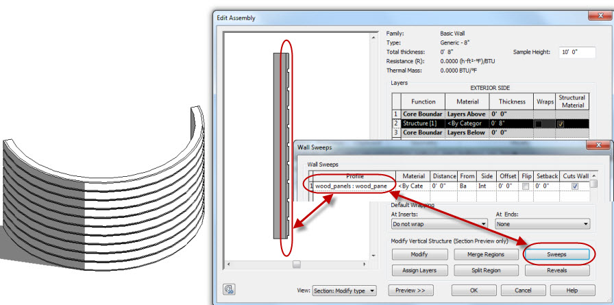

...and, simplifying Typhoon's idea, it could be just one profile in a regular wall (not stacked), like this:

"Why should you place a panel and then do "repeat" or place them one by one? A panel can be applied as a pattern to the surface. That's waht I did. Maybe that's what makes the difference with the void cutting or not cutting the form."
I place the first Adaptive Component manually so I can achieve the Curved effect rather than Faceted effect. Using a multi-point Adaptive Component I can place it on Surface Nodes which allows the componet to follow the contour of the curved form creating an adaptive curved element and then 'Repeat' will repeat the adaptive curved element. This can't be achieved using a Curtain Panel Pattern Based Family without the component being faceted.
But yes, a Void will cut the 'Panels' when using a 'Curtain Panel Pattern Based Family' added through the Type Selector but not when using 'Generic Model Adaptive Components' added using 'Repeat'.

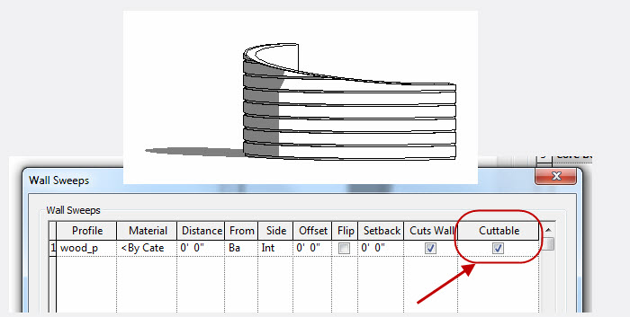

Your solution to use a 'Sweep' in a Basic Compound Wall is more efficient than creating a Stacked Wall but the 'Profile' in the Sweep doesn't cut with a Void unless the Void fully intersects the Wall. When cutting a Void from the Stacked Wall each segment has to be cut individually which is very time consuming but it will cut. This leaves me with the same problem I had with the adaptive components not cutting with a Void ObjectSmile

Quoting designimpressions from 2013-01-05 12:16:41
...Your solution to use a 'Sweep' in a Basic Compound Wall is more efficient than creating a Stacked Wall but the 'Profile' in the Sweep doesn't cut with a Void unless the Void fully intersects the Wall. ..."
Not really. The void does cut the wall and the sweep profile, but the profile must be "cuttable". Did you check "cuttable" for the profile?
