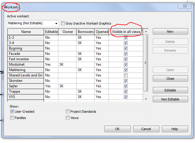

Wed, Nov 21, 2012 at 10:03:13 AM | Turn off the same linked elements in every view
#13
Sofus
Joined: Mon, Nov 12, 2007
19 Posts
1 Stars: 1 Votes
Wed, Nov 21, 2012 at 10:11:48 AM | Turn off the same linked elements in every view
#14
That image is correct and you normally use it when creating a workset and you should be using it.  But you have now mandated that you need to turn ON that workset in views where you need it.  That is kind of a wash.  The better BEST process is to USE VIEW TEMPLATES!
Wed, Nov 21, 2012 at 10:52:07 AM | Turn off the same linked elements in every view
#15
Sofus
19 Posts
1 Stars: 1 Votes
Leo asked if there was a way to turn of elements in a link in every view. What i was supposed to mandate was, put them in worksets and leave all worksets on in the linked file, then its possible have full control of their visibility by creating empty worksets named the same way in the host file, or individual control of them on each view with VG.
