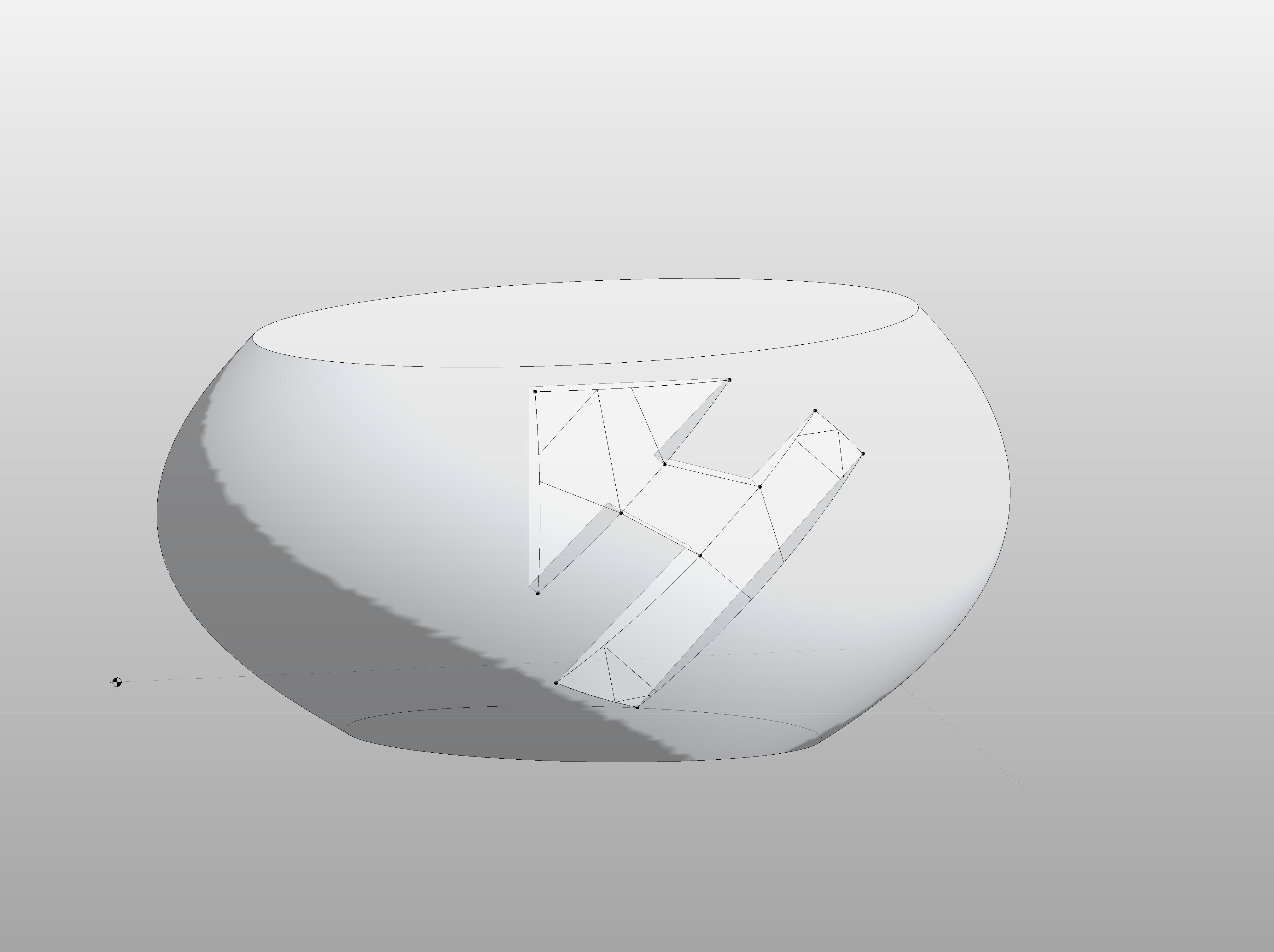

Hi!
I am unable to fill an opening I created on a curved wall.
I have attached a image of the opening, is it possible to fill the opening with glass? If so, how?
Thanks in advance!!! :D
Thu, Sep 13, 2012 at 10:35:41 AM | How To Fill A Curved Wall Opening?
An opening is just that - an opening.  If you want glass, then you need a family or model in place element.  So model a curved glass - in place.... or flat.

thanks for the reply!
so i would to produce a mass model which is sized to fit in the opening created?
that sounds very difficult :/

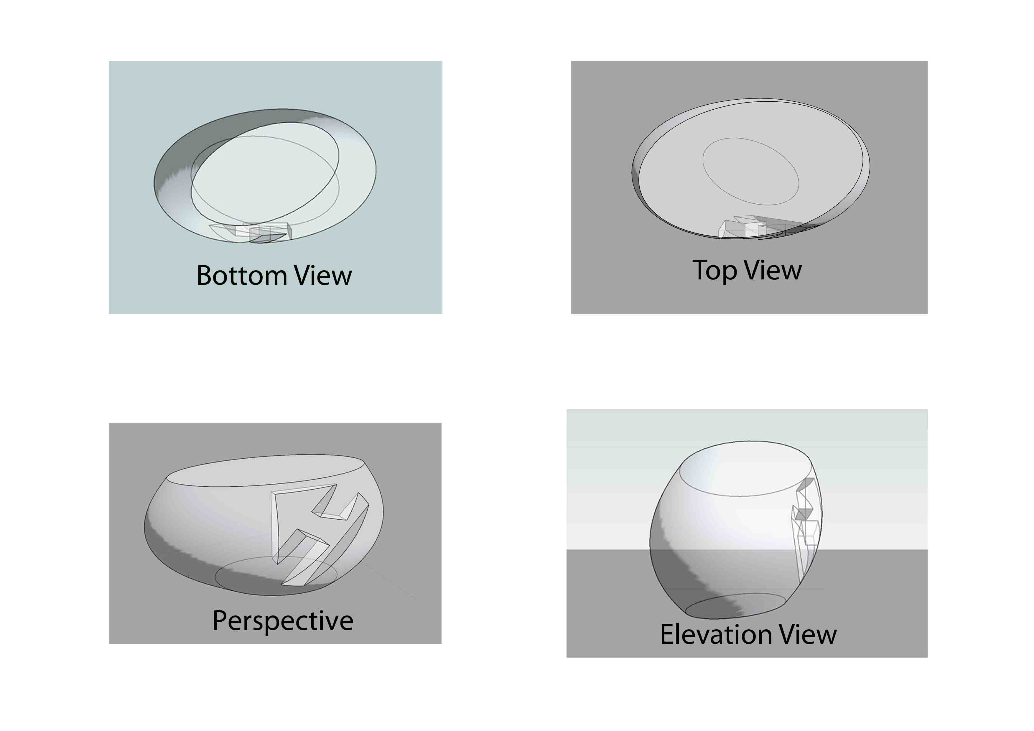

Thu, Sep 13, 2012 at 10:49:07 AM | How To Fill A Curved Wall Opening?
Why do people think they have to use a mass?  If you can create a mass, then you can create an inplace element - NO MASS!
The wall is curved only in plan?  Then just extrude a vertically curved form.
BTW - You posts don't tell us anything more than an opening in a cuved wall.  It would be better if you are more descriptive when posting since Revit is a 3D program.

The Wall is not only curved in plan, ive attached an image file which shows the top, bottom and elevation views to highlight its ‘obscure’ shape.
I am unable to simply extrude a form since the form from the base begins to flare out and then shrinks back in, similar to a vase.
Thanks for the help to date!

Ok the solution is this.  See attached file.  You need to create lines for the perimeter of the window and check 3d snapping and follow surface in your options bar .  Sketch the window with the lines then in properties select the is reference lines.  Convert the lines to reference and then create the mass form.  Then change mass material to window

Thu, Sep 13, 2012 at 12:33:04 PM | How To Fill A Curved Wall Opening?
chau
Joined: Sat, Mar 6, 2010
12 Posts
THANKS FOR THE HELP GUYS!!!
ive just outlined the opening with 3D snap and follow surface and created the form.
It has a little angular look and not as smooth as the form but looks like its worked! :D
