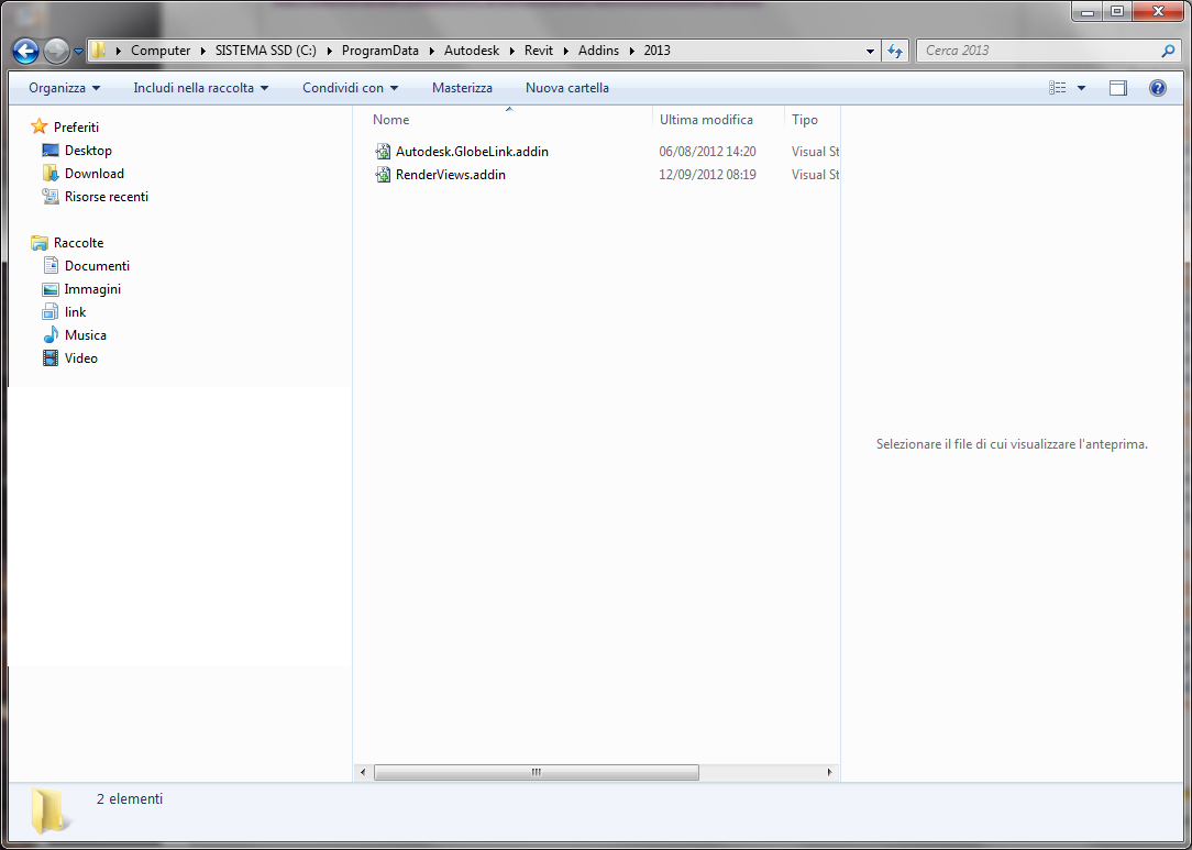

Thank you very much, but in my case I loaded Revit13 recently and I have no addsin file in the destination you mentioned,I didn't bit any addsin before
 so what shall I do ?

 sorry for the disturbance, I did find the file and change the path but I didn't find the "external tool" in mange tab? Is it because I never use addsin before this one ?

i sort of "invented" that tab. i have the german version and dont know how it is called in the english version. i will check asap!

here we go...
follow this to be sure that it is installed correctly. (its not my plug in but the procedure is the same) http://usa.autodesk.com/adsk/servlet/ps/dl/item?siteID=123112&id=19399552&linkID=9243099
then when youre sure that it is installed correctly look at the video i posted yesterday and try to follow the images on the buttons instead of the text. unfortunatly having only the german version its difficult for me to find out what the english products are labeled like.
please let me know!
regards
igor
Check out my new Renderlist add-in to render multiple views in sequence overnight! Get it here and remember to leave some feedback Shadey http://www.revitcity.com/forums.php?action=viewthread&thread_id=28381
Fri, Sep 14, 2012 at 1:24:35 AM | Render list of views
frifer
Joined: Mon, Jul 30, 2012
107 Posts
5 Stars: 4 Votes
ok, found infos on the web! if correctly installed an "add-ins" tab should appear like in this image!
http://thebuildingcoder.typepad.com/.a/6a00e553e1689788330133f529cccf970b-800wi
and here is a sample of the location for the .addin file. attention, you must modify the file with NOTEPAD not with word.
whats the language of your revit?

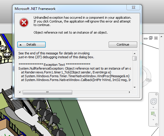

Mon, Sep 17, 2012 at 12:50:28 AM | Render list of views
#12
frifer
107 Posts
5 Stars: 4 Votes
thanks for posting this!
i need a few more infos:
-do you have .net framework 4 installed? or just 3.5?
-whats your operating system?
-can you please try to choose only {3D} as view to render and see if it still happens?
-can you copy and paste the whole error message?
-did you update my script to its latest version? (v1.6)
-at what exact point do you get this error message?
-can you try it with one of the sample projects to see if the problem is related to the views or the script?
-are you using some sort of realtime ram-cleaning software?
-in the latest version there is a system info button. please hit that button and paste the result here.
thank you
Igor
Edited on: Wed, Sep 19, 2012 at 4:57:32 AM
