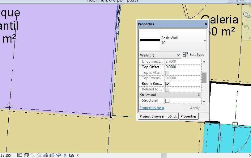

hey i have this related problem... the room dont seems to recognize the wall and graphical its taking half wall from a side  , half wall for the other room
(when i put a "room separator" line it define it ... but it was working pefectly before with only the walls)
using w8 - revit arch 2014

ohh shut... i already solve it ! xd it was the wireframe view ! haha
